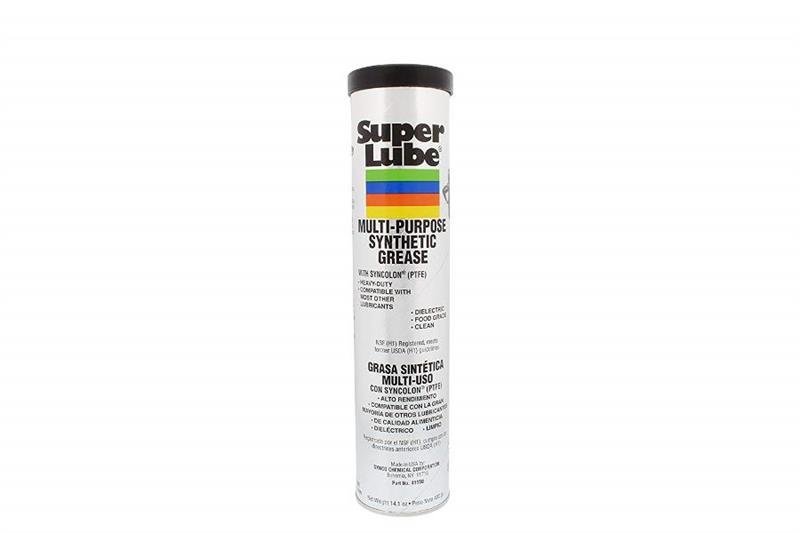

    I was told to use super lube for the urethane. They sell it in a tube for a grease gun, also a small tube both at harbor freight.
    Then use Tri-Flow dry lubricant on the uniball. It doesn't attract dust like most lubes. Never had any issues with my TC UCA's using those products

    Sucks cause a king coil over kit with total chaos ucas shouldnt be squeaking brand new. You do have to loosen the bolt before greasing and superlube is what they reccommend.
    If you grease without loosening the bolt you will deform your bushings and they will have to be replaced with a unreasonably priced new set. They got us by the short and curlies. Like a pussy whipped husband.:D

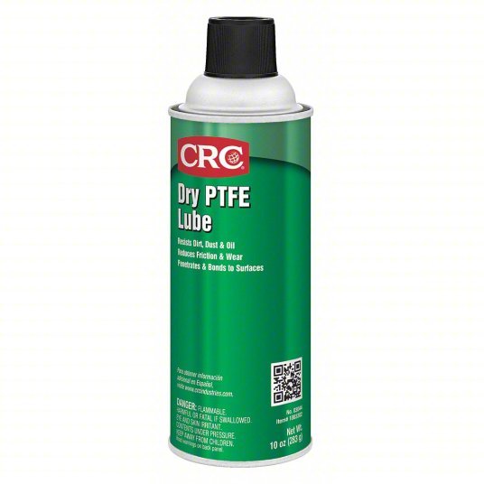

    CRC Dry PTFE for Uniballs & Super Lube Multi-Purpose Synthetic Grease w/Syncolon (PTFE) for control arm bushings
