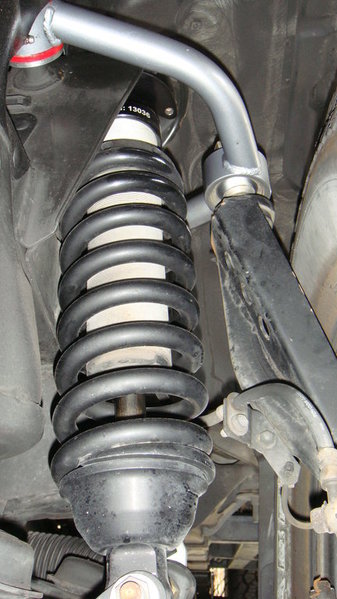

    Get the spindle gusset installed while you're at it...

    i dont think they make a gusset for the first gen :(
    ...wishing i had gotten new polyurethane bushings for the LCA tho

    ... they sure do. I have them on my '03 in the pic I provided. $32.00 from Off-Road Warehouse. They are also on the Total Chaos website.
    Cheap insurance if you beat the crap out of your rig.

    If I recall, the coil buckets were designed for the long travel set-up and an extra shock, all of which I do not have.
    I am referring to the actual spindle gussets. They are to be welded in place and support the spindle for aggressive off-road activities.
    The pic I attached in the previous post shows where it sits in relation to the spindle. To the RT of the CO, it is spotted and has 3 holes punched into it.
    Hope this helps.
