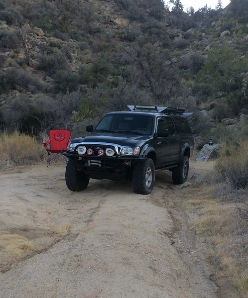

    Great discussions guys and very helpful! I am new member but been reading for years so I know I'll get straight answers to my below questions.
    I have had a TC UCA and 3" lift on my 02 4wd for over 10 years with no problems at all but and am now considering a long-travel system for better articulation in the rocks - I'm not a go-fast. I am also wanting a couple inches more of ground clearance. So my plan is to increase tire/wheel size from 32" tires/16" rims to...whatever combo gives best ride characteristics and least problems with the planned long travel system. This is my daily driver as well for now. I'm a bit worried about ride/road chara's with the xtra 3.5" per side stance increase with most systems - have not seen solutions to minimize the crabbing by increasing the rear stance (e.g. spacers or different backspaced rims?). I was going to discuss with James at SDTruck (Built Right), but thought I'd throw it out here to hear opinions from been-there-done-that builders! I go to most of the BITD races and am really impressed with Camburg's approach and ingenuity. Yet TC and Built Right have got it right as well; and now I see JT's "Baja Kits" which looks solid too. Some insight into the pros and cons of the above system would be really helpful! Thanks in advance for your (or any other reader's) opinions!
    FYI - below is my rig:

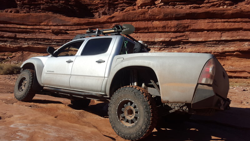

    I have the +3.5" chaos kit (had it for the past 4 years). Since moving to Utah this past spring I don't do a lot of high speed stuff but the kit offers amazing articulation. You get used to the body roll (especially if you have a LT rear end).
    I get a lot of comments/ questions from Jeepers in the local mtns. They say that this "desert" suspension does not belong in the mtns. There jaws drop when they see how much articulation I have with both front and rear long travel.
    I have not broken an axle I have 255/85/16 (33") tires. I also dont have a front locker (don't see the point). I have not met anyone who has broken an axle unless they have some ridiculous tire size (+35"). For the rear end I have 1.5" wheel spacers (Mainly so my tires dont rub on my bypasses).
    Going long travel allows more articulation and will keep your tires planted to the ground. Once you go long travel you will never want to go back!

    On the front I am only running a fox 2.5"x8" coilover. The rear I have 16" Fox triple bypasses with 4.5" bumpstops. If you were really good at bypass tuning you could get away with not having bumpstops if you had triple bypasses. For my current use of the truck, I dont see the need of getting the secondary bypass for the front.
    The road characteristics are great. Once it is aligned it does not wander.. stays straight. If you really beat on the truck/ jump it you will always fight alignment. Some guys on here weld there cam alignment tabs which I dont recommend. For the most part my alignment stays true. I know Midas used to have a lifetime alignment deal ($200) that might be a worthy investment if you are a stickler on your alignment.
    If you are concerned about overall stance, Tire and wheel selection are key. I had to get new wheels after I installed my Chaos kit. I only had about 1/2" of room between my tire and weld on spindle gusset. So my method wheels have 4.5" of back spacing. I am running 255/85/16 tires because I don't want my tires sticking out from the fenders by a mile. Having rear fiberglass bedsides also helps with the "look" if you did not want to run wheel spacers in the rear. My truck looked mis-proportioned when I only had front long travel and stock rear fenders. Total Bro-dozer!
    Be prepared to spend ~$6K for the front with 4wd. Add another ~$5K for the rear if you want that long travel as well.
