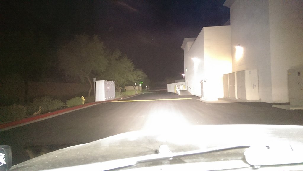

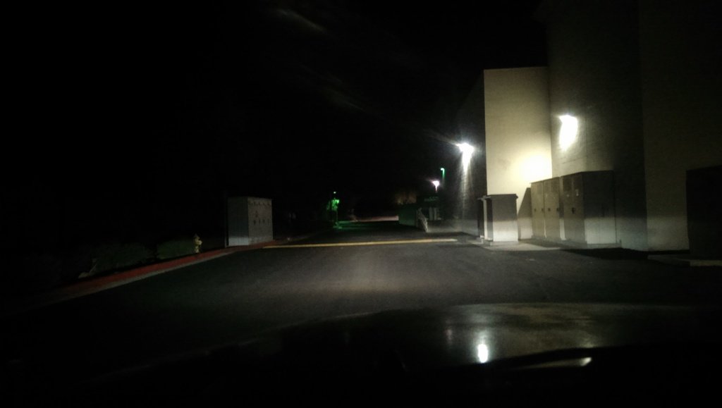

    And here's some shots I took of 3d vs 4d. Same bar. Same leds. The 4d does add a LITTLE bit of light to the sides with some outside "flood" leds. But nowhere near that of the 3d. You can see the 3d has a much wider spot. As well as tons of side lighting. As well as diffused lighting going straight out the sides lighting up that wood fence.
    5d only helps a little better than 4d because they added in fluted lenses on the sides. And a combination of reflector bowls and the fisheye projector lenses. 4d and 5d is kinda like "tunnel vision". It focuses it through the projector. Versus allowing a reflector and lens to spread it more effectively. Plusm the 10watt led reflectors are much bigger allowing an even larger spread/pattern. But mostly it comes down to the way the lenses are designed. Especially the diffused lenses with the ones I listed earlier. Baja designs has another great design with even bigger reflectors but with fluted lenses on the sides. A better focused flood than mine. Because the diffused does take away some of the output.
    Trust me. Both 4d and 5d are no bueno. Unless you want it for the forward lighting for an insane throw down range. Then use some floods for angled/side lighting. I just assumed you wanted a nice even spread all around. That would blend in together and be like one big flood pattern all around the truck. Getting 4d or 5d will greatly reduce your spread. And you may end up with gapped/uneven lighting.
    Also keep in mind that 4d and 5d (being tunnel vision lights) you won't have a lot of vertical lighting. They are like 10 degree spot beams. Maybe 20 with 5d. Or let's say, 10 degree vertically, and 20 degree horizontally...
    3D is like, a combination of 30-40 degree spot/120 degree spread/170-180ish degree flood or diffused light. And all in horizontal AND vertical planes. I wished I had a beam pattern diagram to show you.. But hopefully that explains it.

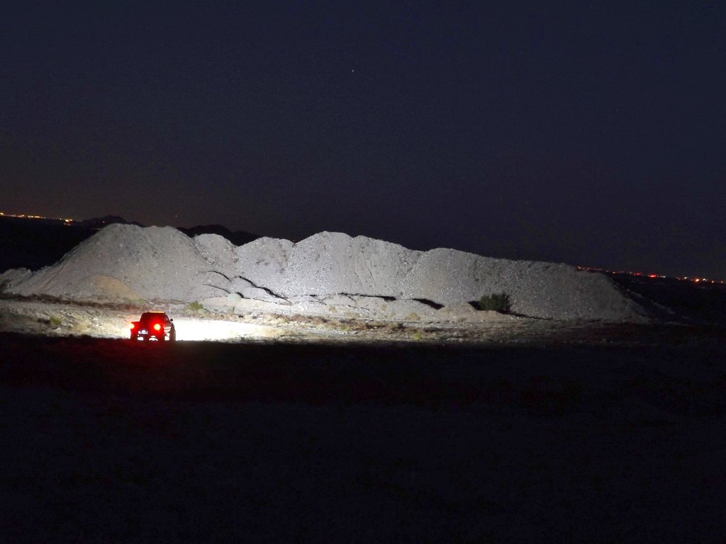

    Here's another shot of my 42" and 20" single rows. Compare that to the shots in the led light bars thread from the other member. See how high mine go. I don't have the 8" bars installed in these shots so I don't have quite as much side lighting As I did when they were in.
