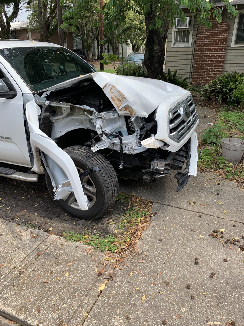

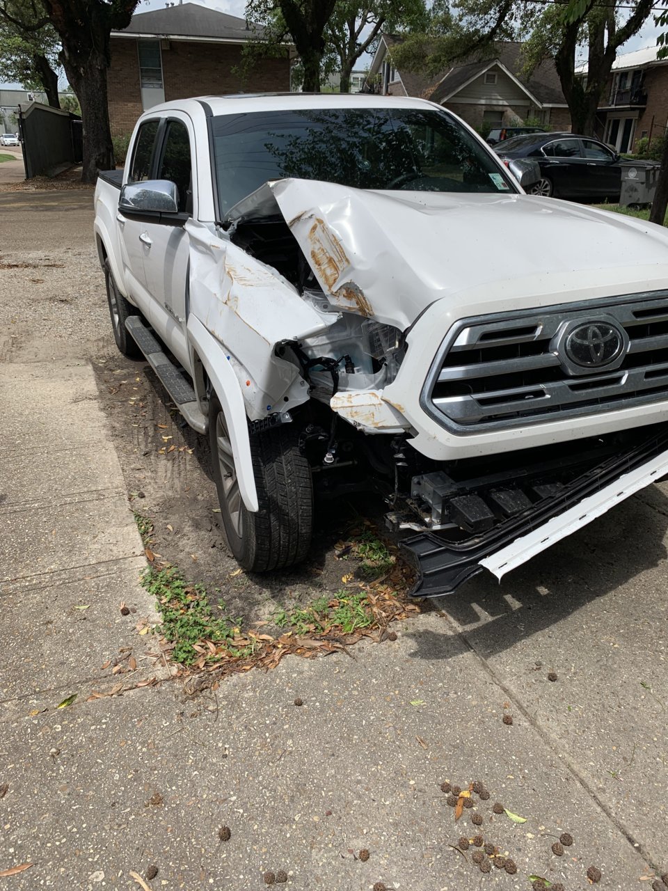

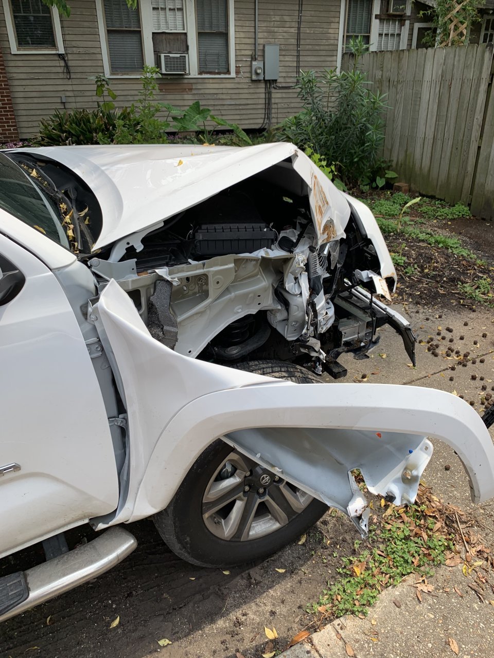

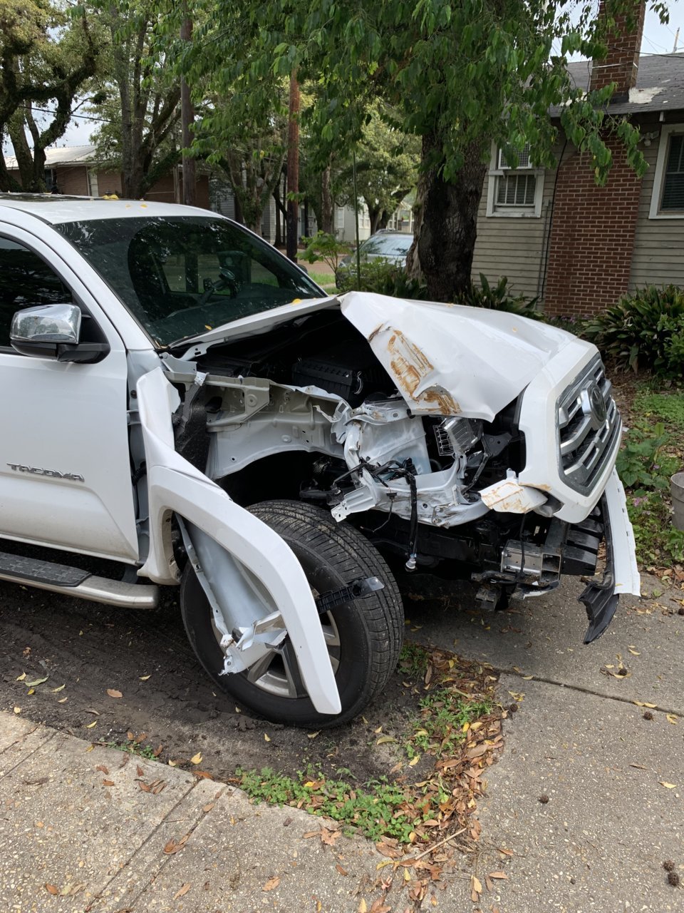

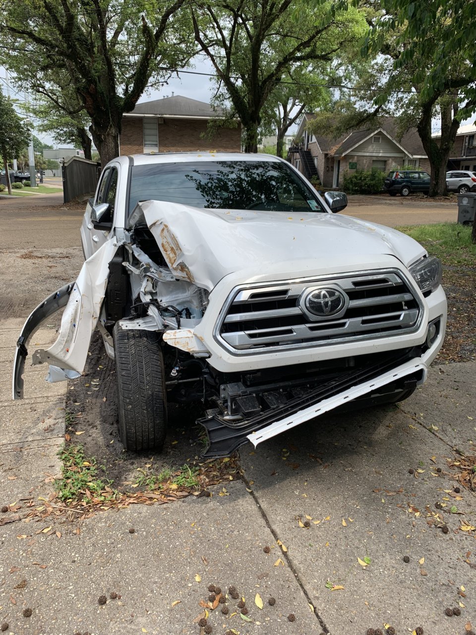

    Had a wreck the other night.....truck only has 4400 miles.....just my luck. Pretty sure I'll be driving this truck for a while bc it won't be totaled but wanted to get some feedback from everyone. Not 100% sure about frame damage. Airbags did not deploy. It was delivered to body shop today. Thanks!!

    You will get a lot of “yes for sure that’s totaled” but it’s not. You are looking at no more than 15k in damages.

    Doesn’t look too bad. But you never know what they’ll find behind that mess.

    Will be good as new in a few weeks...

    Not even close.

    Hope no one was hurt, doesn’t look totaled to me. Looks like a lot of sheet metal damage...

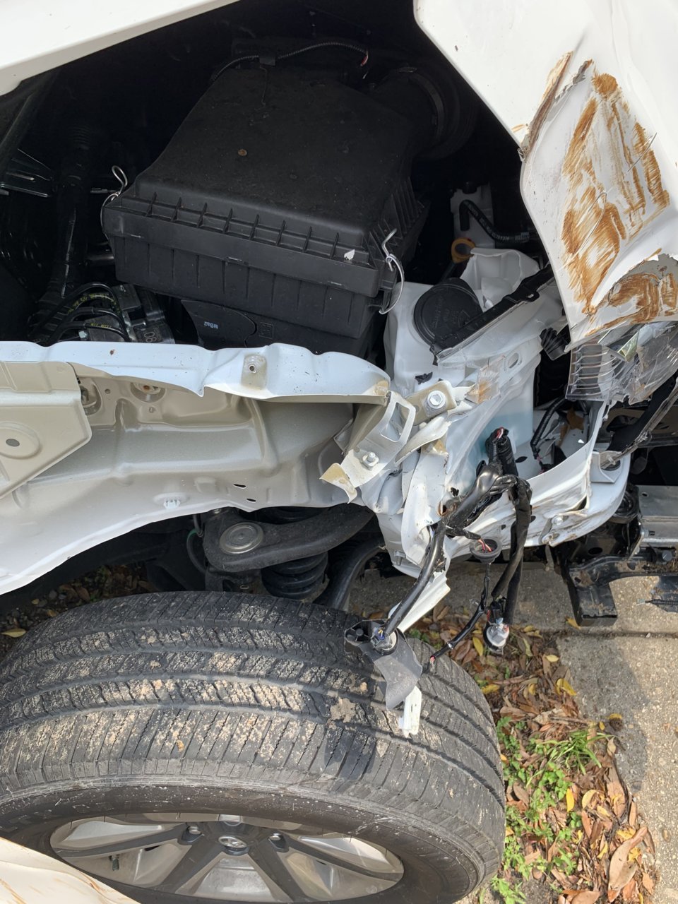

    Be sure you take it to a reputable shop. Toyota has utilized a lot of high-strength steels in their construction. Very specific procedures for replacing rails and such. Looks like that upper rail is toast.

    Not sure how you missed the airbag sensor but no way it's totaled.

    Not totaled...looks like it took the hit above the frame.

    UPDATE : I missed the frame rail, but bent the upper/lower control arm which pushed the right front wheel back about 2". The apron, radiator core support, and all body work was supposed to be relatively straightforward. Upon further investigation, it was discovered that it had a diamond frame.
    FINAL VERDICT : Total loss.
