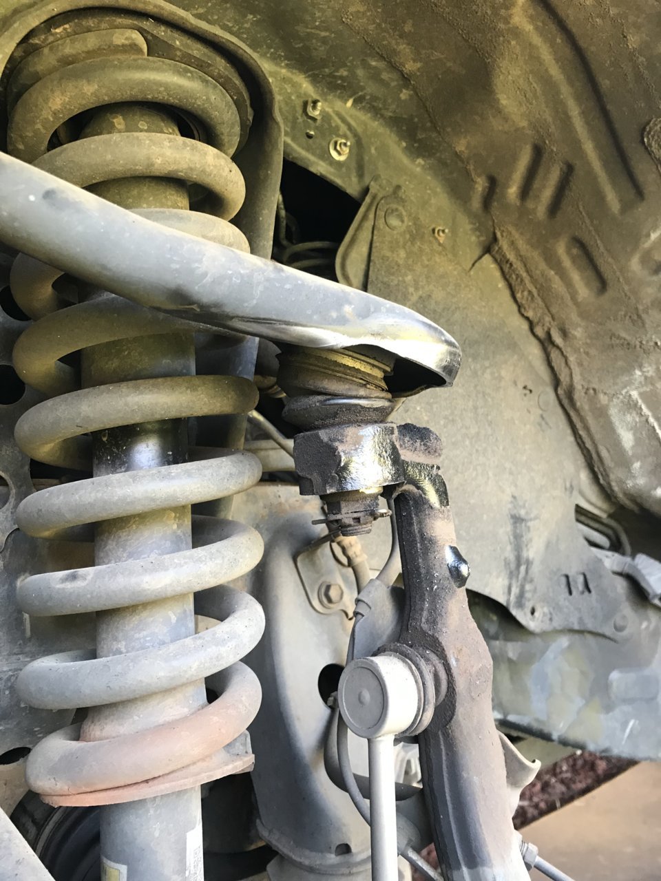

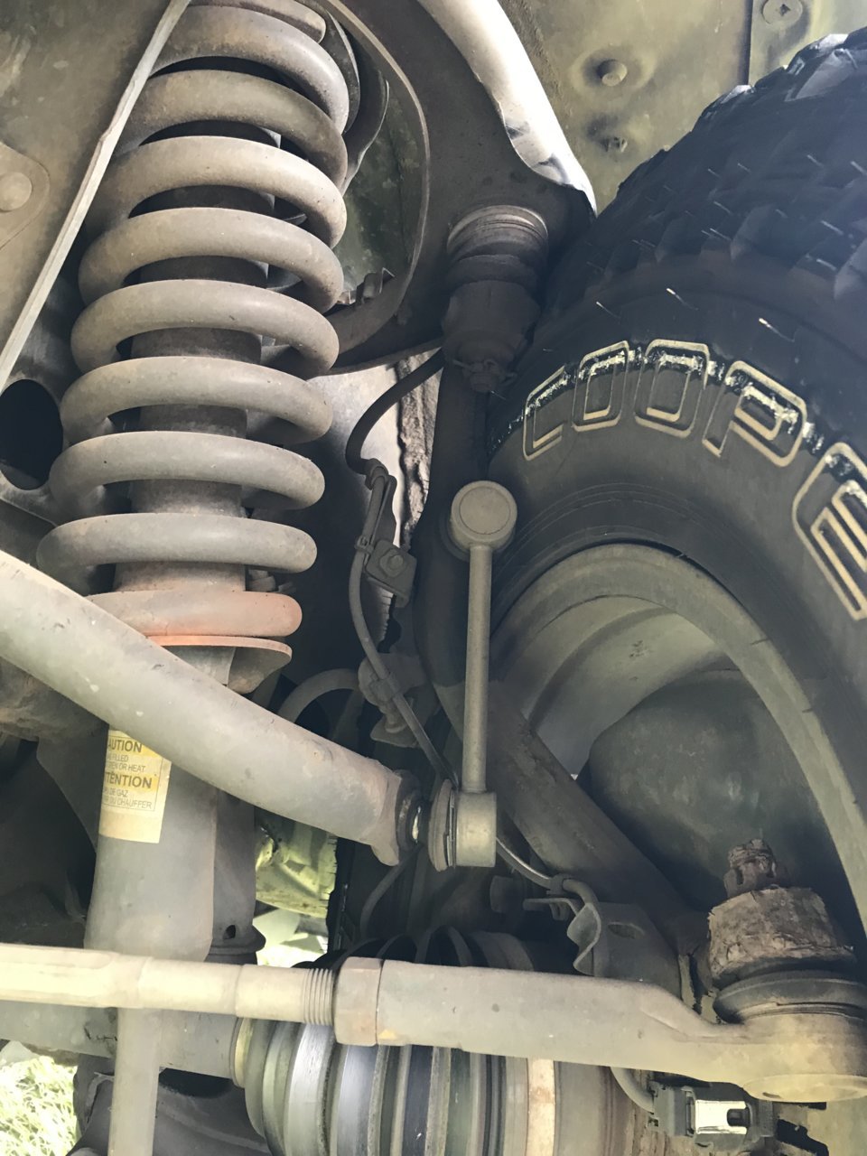

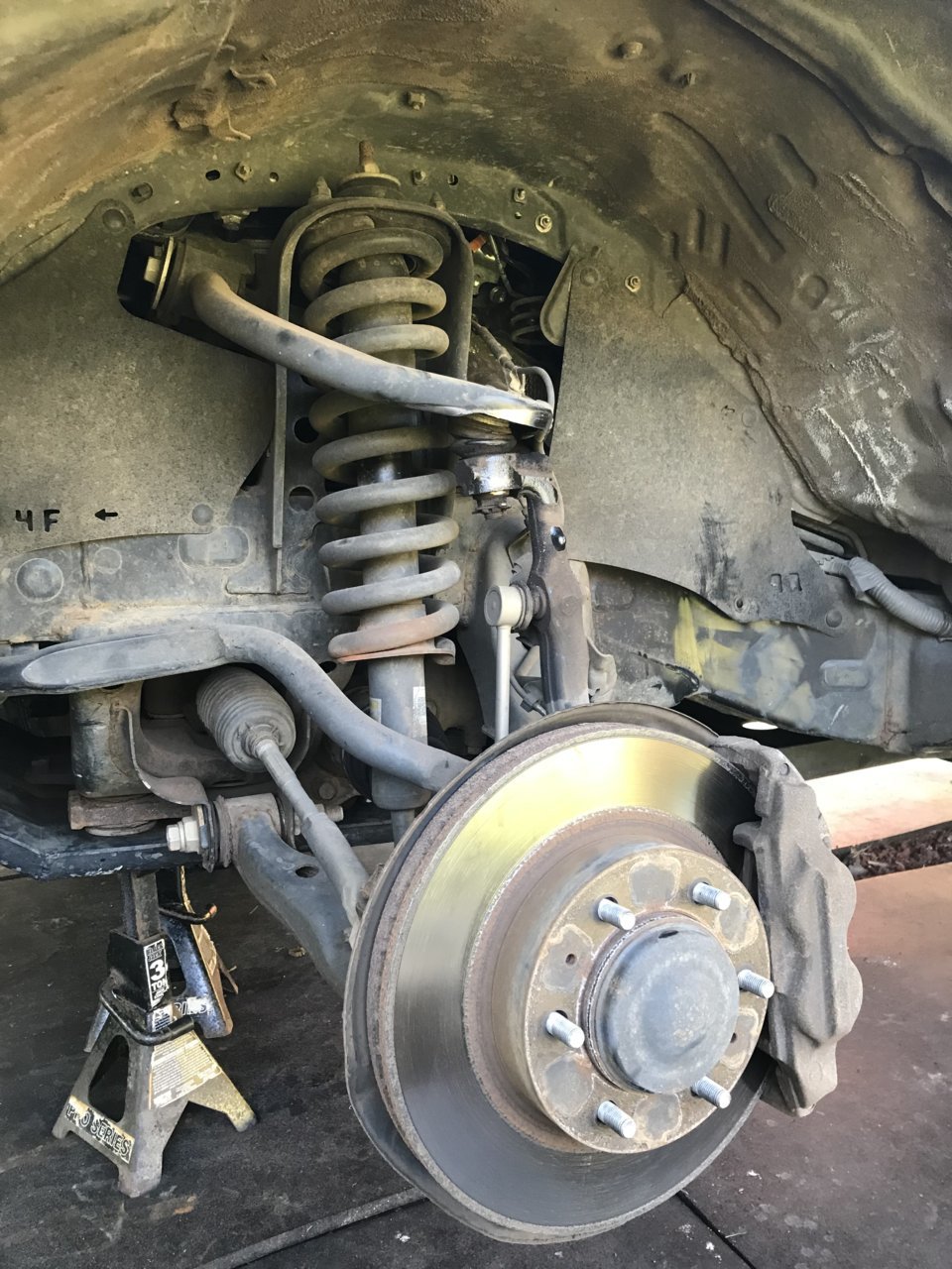

    So I got the truck home. Looks like only the ball joint attaching the spindle to the UCA is bent.

    Well looks like I need A new UCAS since I can’t change out the ball joints on the stock ones. Might as well get two.
    Can anyone recommend affordable UCAS?

    Is it possible it could have just thrown the lca alignment totally off? The rear cam tab is all the way to the right now.
