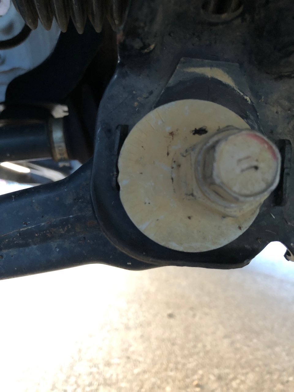

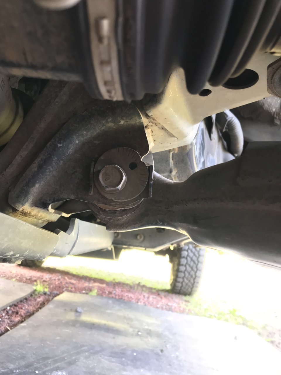

    Pic of the rear cam tabs where the LCA bolts to the frame. If those are not flattened out then you will likely be ok just replacing knuckle etc. If it were me I'd replace knuckle and wheel bearing. Then see if alignment is in spec. If not then proceed to replace UCA and LCA.

    What do you mean by flattened out? They look flat just like the passenger side but I will post pics
    This pic is before I straightened her out

    It's usually subtle, but if they look like this below, you won't be able to hold an alignment.
    Left cam tab bent outward.

    The pic you posted just now it looks good. Now get a pic from the rear most tab looking toward the front of the truck. Or just get a pic of all 4 tabs on that side.
