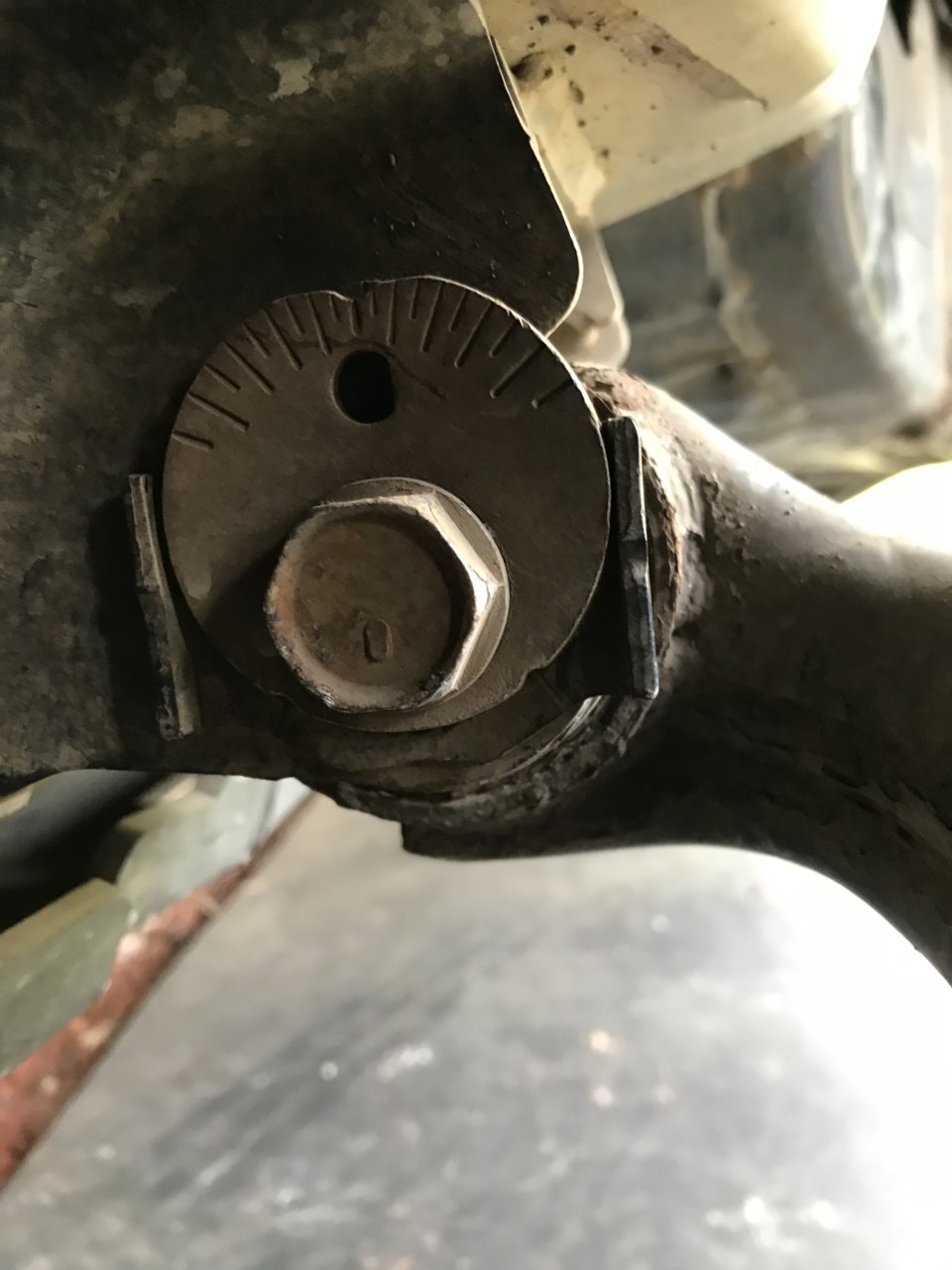

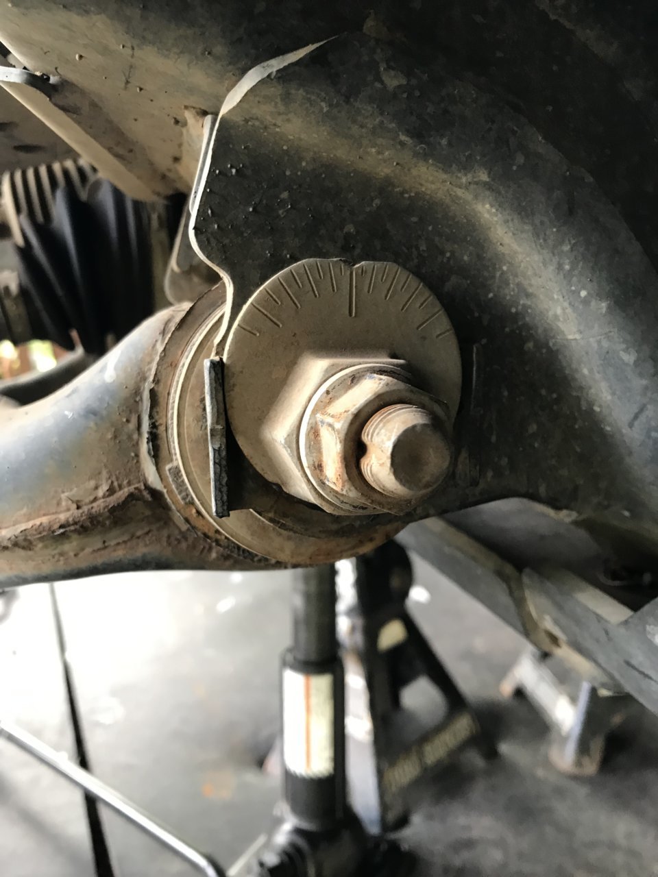

    Third pic is of the rear most tab.

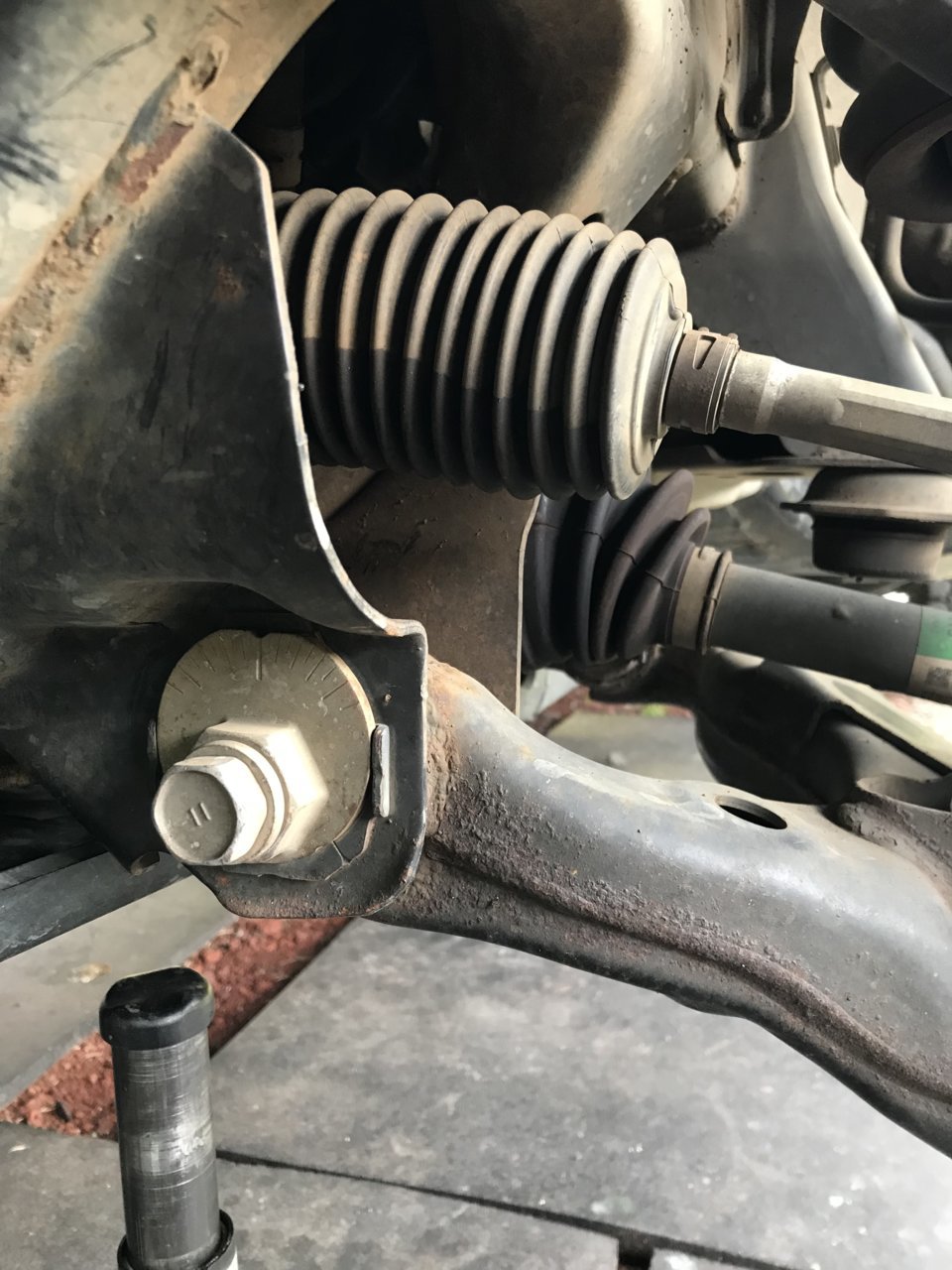

    just a suggestion, but it would be easier to study all aspects of the good side with the tire off and compare to the damaged side

    my mechanic friend is on the way now! Time to take it apart even more.
    I will test what it looks like while steering with both tires off First. I really like this idea. I will post more pics and
    Maybe a video. Thankyou!! There will always be haters!

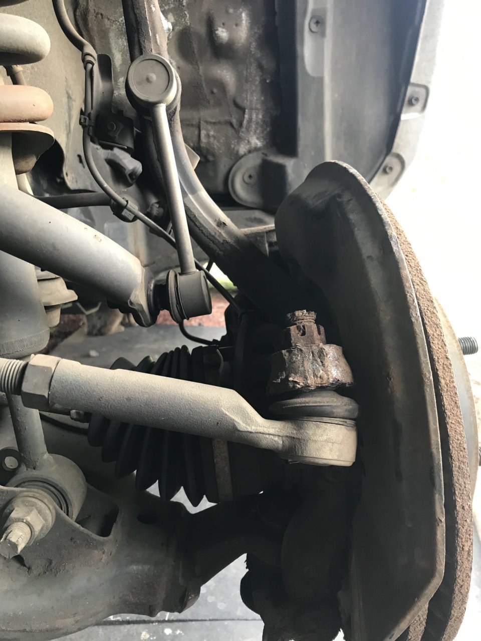

    Honestly, I really think its just the spindle and then possibly the tie rod and uca.

    Update after hanging out with my mechanic friend.
    Did all of what people said on here to check. All ball joints and UCA and LCA all seem fine.
    Looks like I bent my steering knuckle a half inch.
    I can get the part in my town for 400 bucks, or wait and get online for 150 with 50-150 dollar shipping. So I am going to get the part in town and drop the 400. Going to get it on tomorrow hopefully. Cross your fingers this is it!

    The steering knuckle, which I assume is actually the outer tie rod end, wouldn’t cause that camber change. There’s more going on than just steering

    you are right. I’m replacing the whole steering knuckle aka the spindle. Hopefully this is it. Everything else in the area looks okay. Shops keep it in stock here so seems like this happens often enough.
