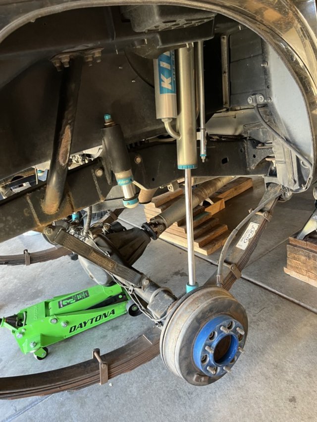

    I'm no expert on this but if that was the case then you wouldn't be able to weld sliders onto the frame or do any modifications, however, that seems to be working out for a lot of folks just fine. For example:
    https://twstatic.net/attachments/img_9630-jpg.5840723/?res=640
