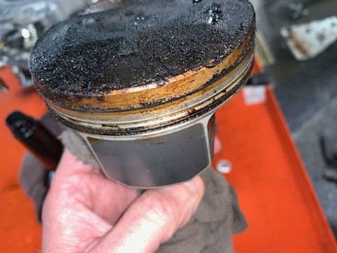

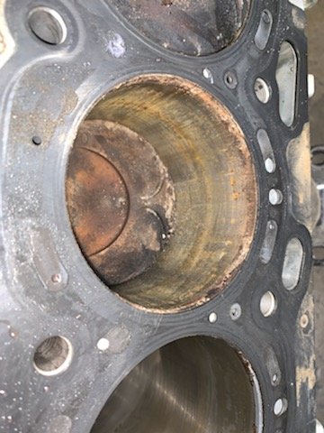

    That looks like burnt sugar or Karo corn syrup on top of that piston. The rest of the damage looks salt-related. No filter will make it 100% safe. Get a locking gas cap and move on with your life to worry about something else. They can't remove a locking gas cap without damaging it and its feel. The damage and feel of you removing it becoming self-evident and noticeable. I bought a locking gas cap and I don't worry anymore. No codes thrown with my Stant. BE SURE to lubricate the viton o-ring on the cap with some petroleum jelly every 3-4 months. This helps to not throw codes.
    TartanEagle and Big tall dave like this.
