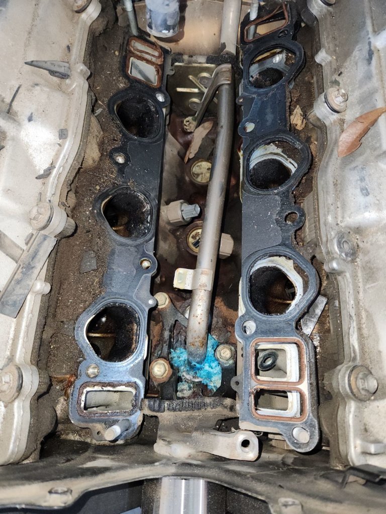

    Was sent this picture from the shop owner this morning, and for those interested, this is what the intake looks like on a highly abused 5vz-fe engine with 310K miles on it.

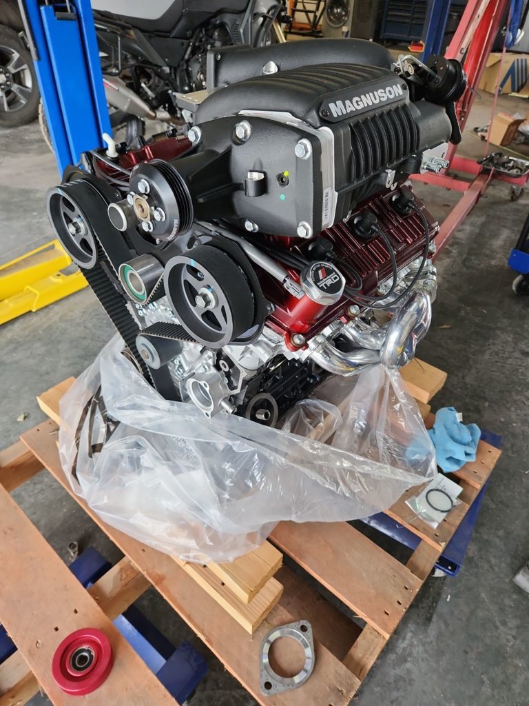

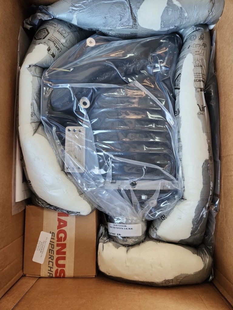

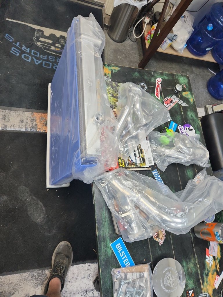

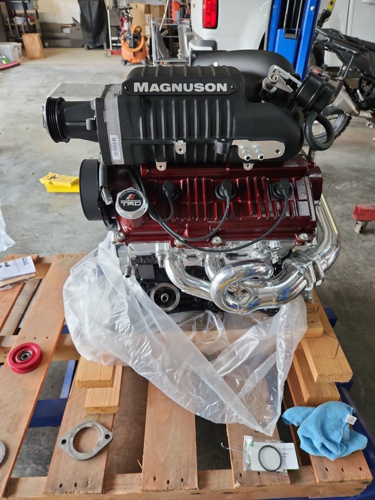

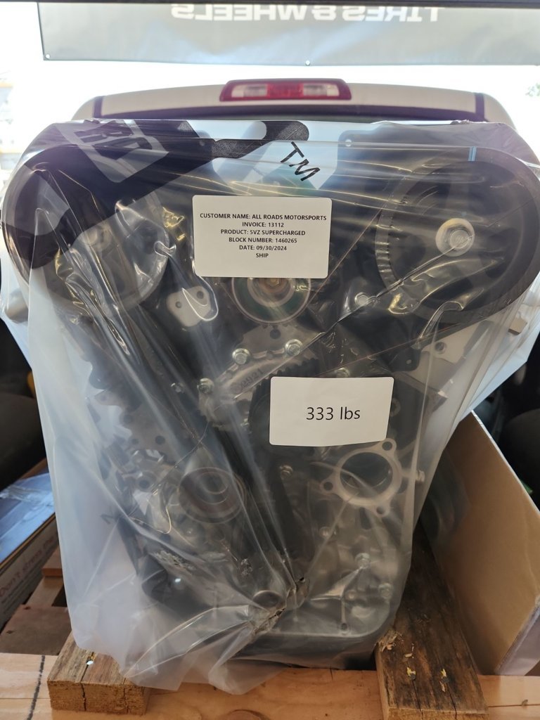

    Just some pics of parts that arrived at the shop this week.
    The engine is enroute on a truck.

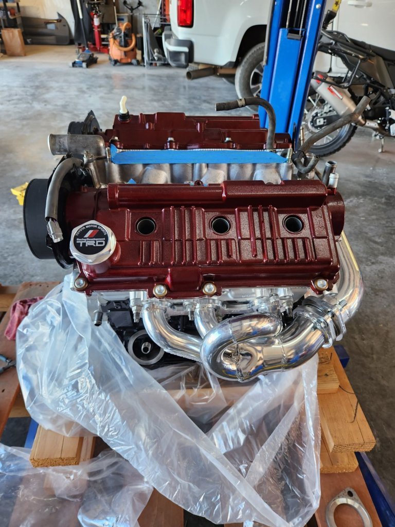

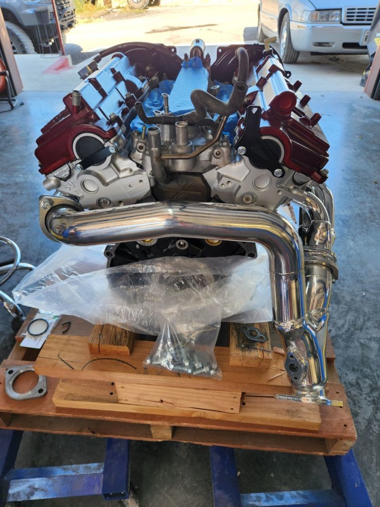

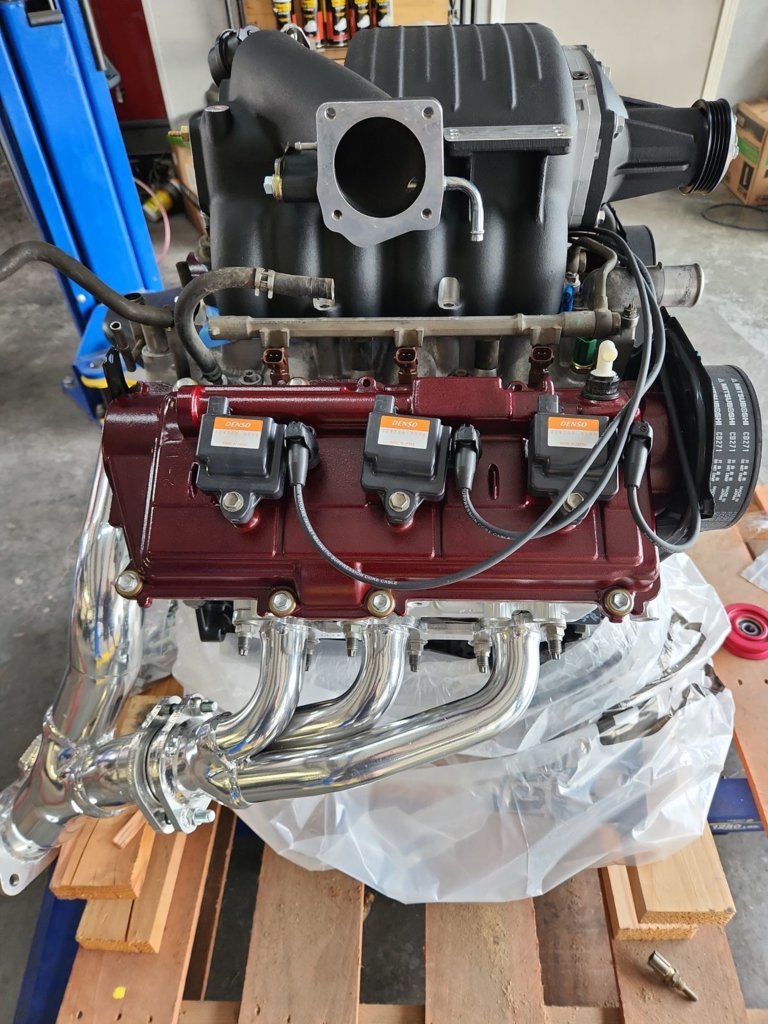

    More
    Look what arrived at the shop today.

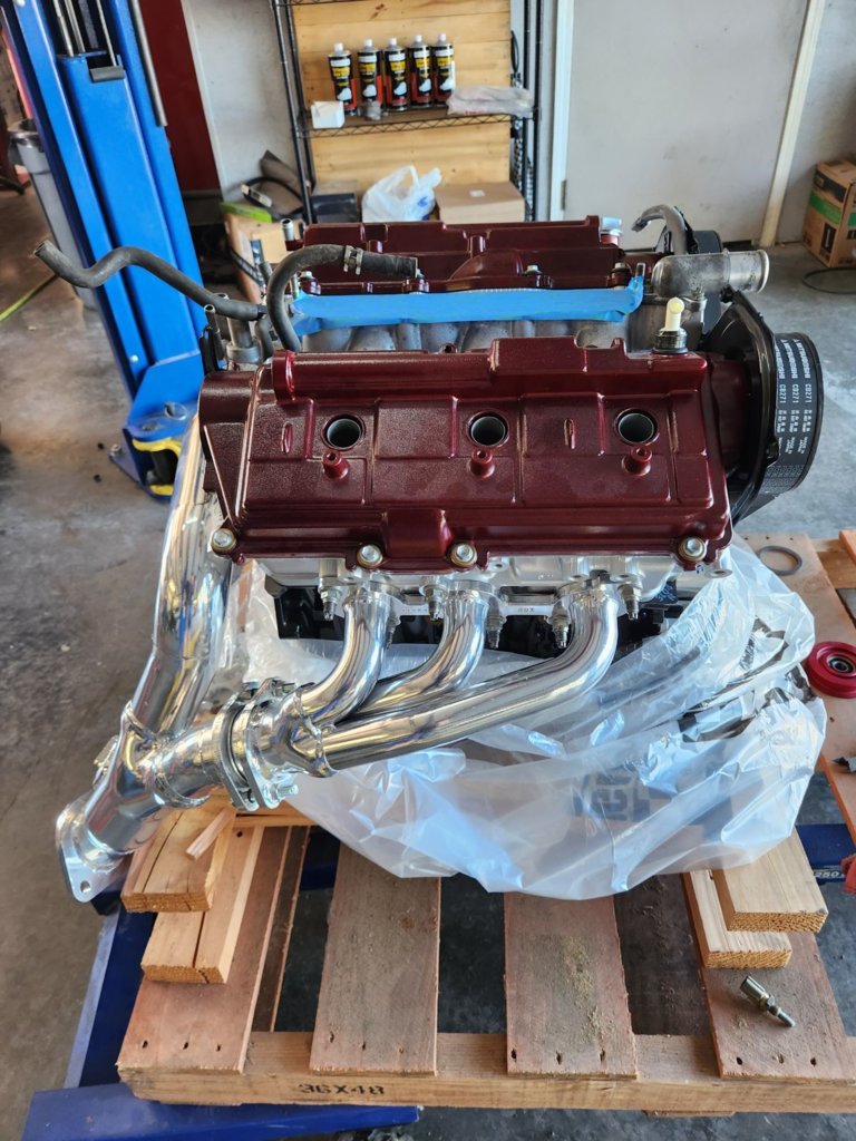

    Some new photos from the shop today.

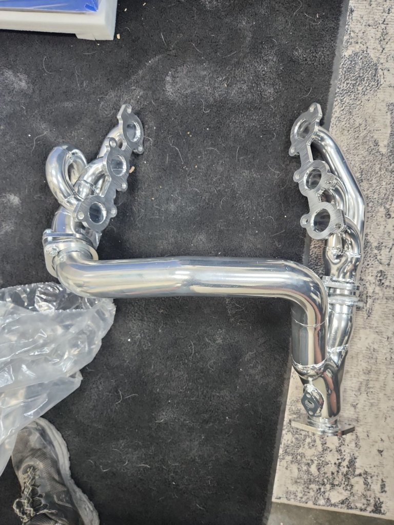

    Some more photos from the shop.
    Going to be running the stock 75mm pulley for a bit until URD gets more 70mm pulleys in stock. I message Gadget and he said they don't have a good ETA on when they will be in stock and that it could be several months.
