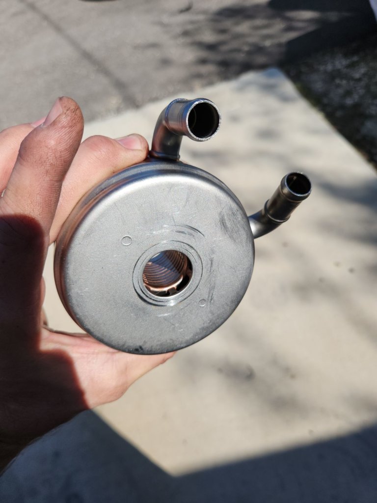

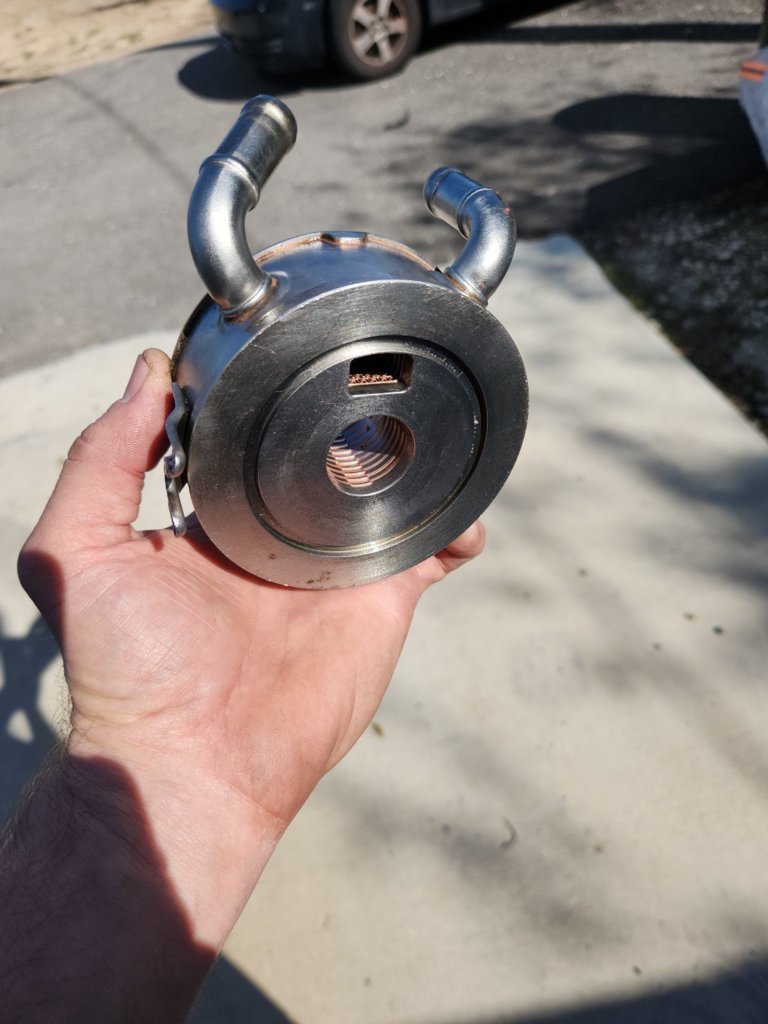

    I did get a message about my oil cooler. It was completely gunked up with sludged oil, but they were able to get it all cleaned up and restored again without having to buy a new one.
    I knew the previous owner (family member) was bad at doing oil changes (sometimes going 15-20k miles between), but there was never any oil sludge that showed up in the engine (top end at least) or oil pan, so it seems it all got stuck in the oil cooler. Did not seem to cause any obvious issues as I've owned the truck for about 8 years now.
    I don't have abefore photo, only an after photo of the cleaned oil cooler.

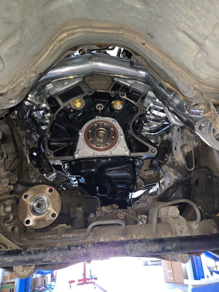

    Was sent this a few minutes ago. The engine is in.
    Edit: The shop is waiting for a new carrier bearing to arrive before putting the transmission in. Then they are going to take some measurements for a custom exhaust they are working with another shop with to fabricate for me.
