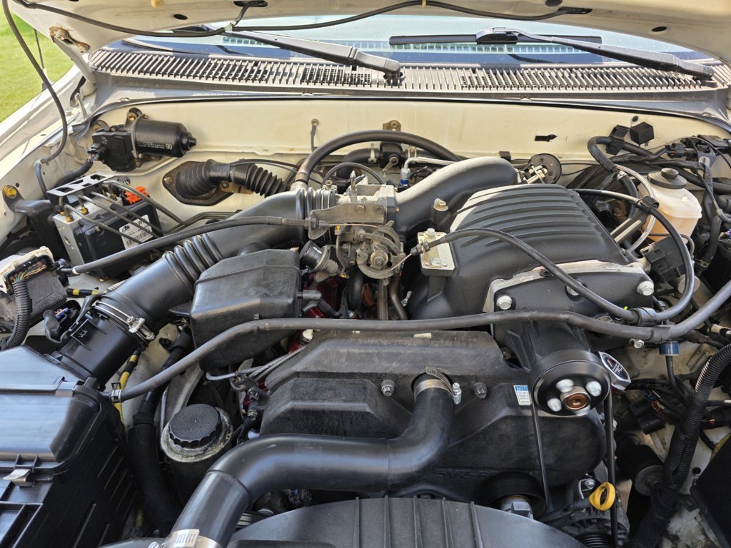

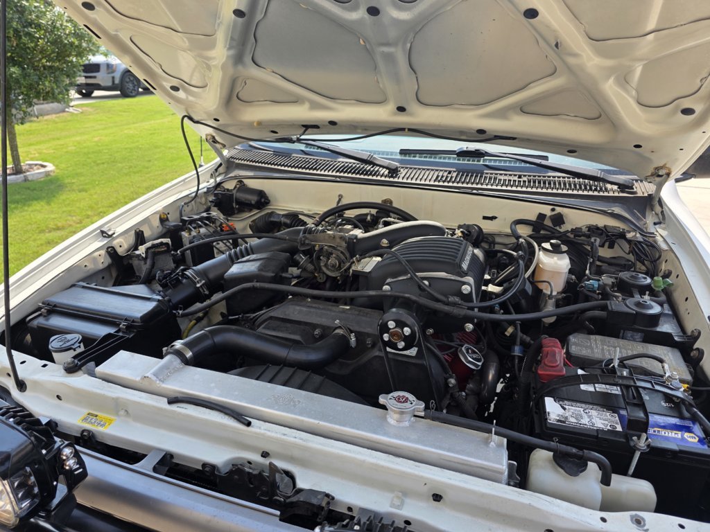

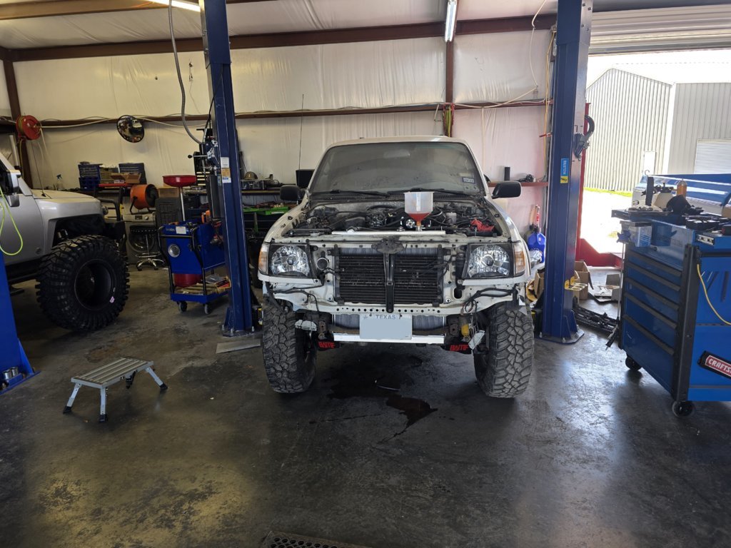

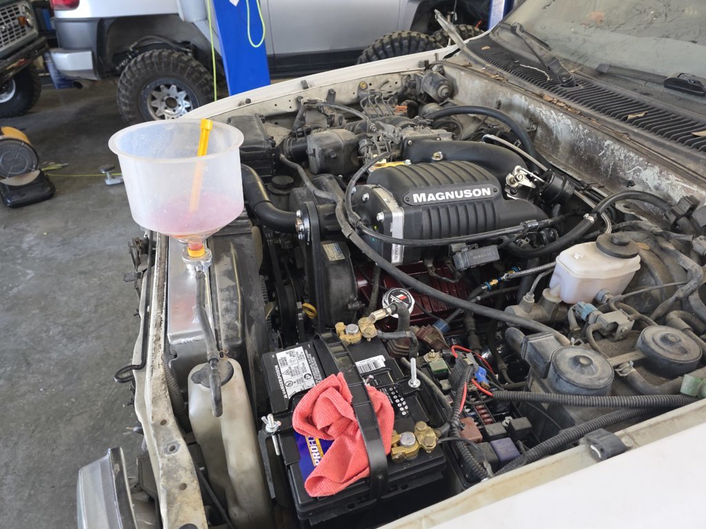

    If you can post some pics of the engine bay so we can see it all hooked up. Thanks.

    Good idea. Even I myself have not seen it from the top. The truck is always up in the air each time I've gone by, so I've only seen things from below.
    Next time I will try and remember to ask if the truck could be lowered.

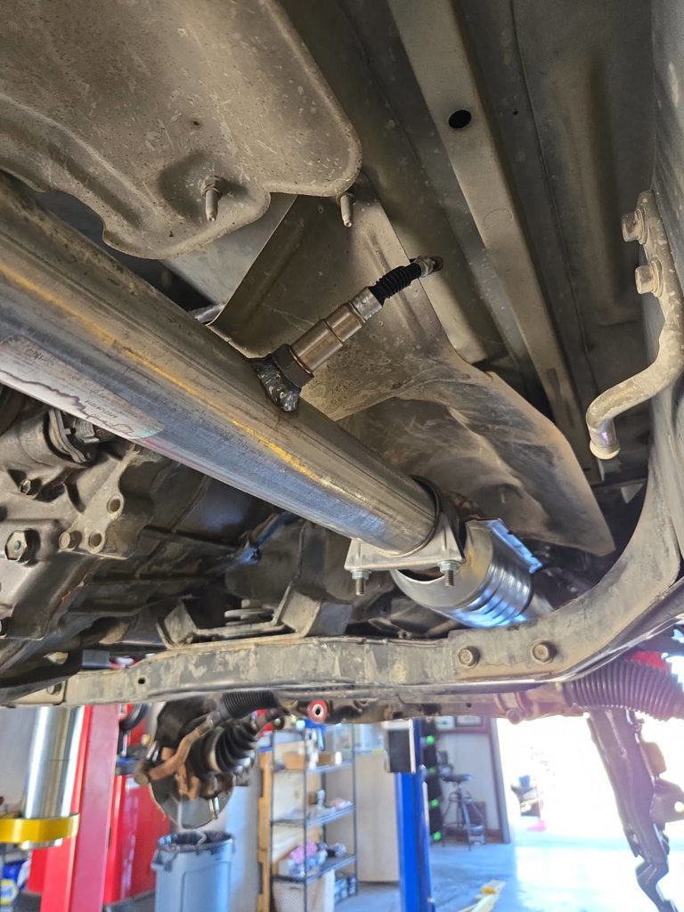

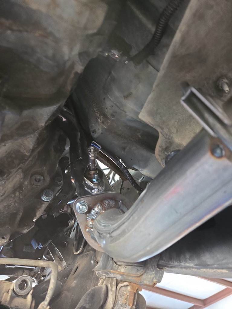

    So the new engine sounds fantastic. No 7th injector or tune added yet, just stock ecu setup, but it was so smooth at idle and the new exhaust is better than expected. Nice and simple deep growl and not very loud.

    Did I remember to get a picture of the engine bay from up top? Yes I did, and I will add them here.

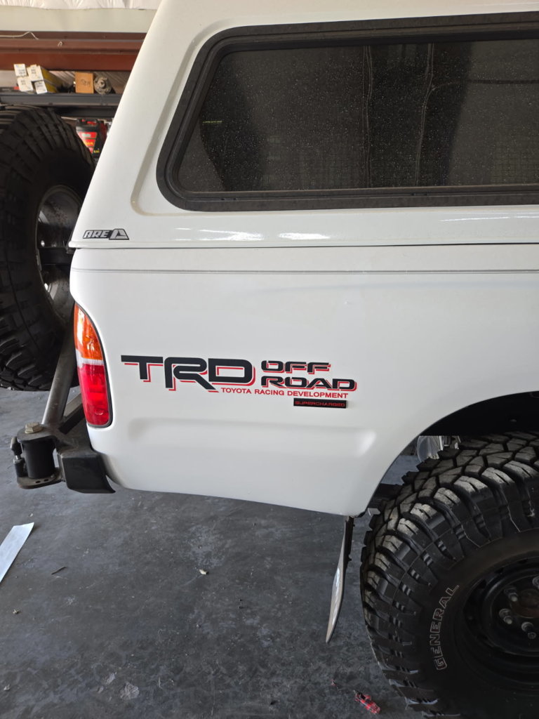

    The truck does have new TRD stickers now. The old ones were severely faded, and one side had peeled off about half the stock sticker
