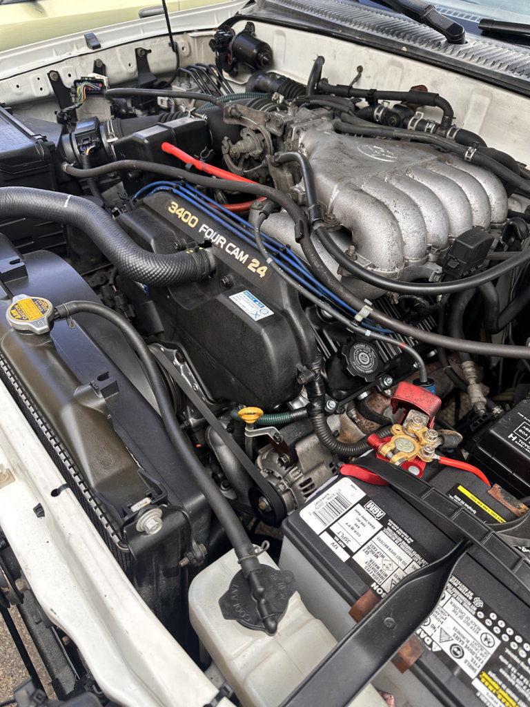

    Almost 1 year to the day that I ordered the Yota1 rebuilt 5VZ she's in and purring. It's amazing how much less NVH there is with the rebuilt.
    I don't know if there's a way to find out the exact core I have, but I'd like to think it's yours, thanks! :hattip:
