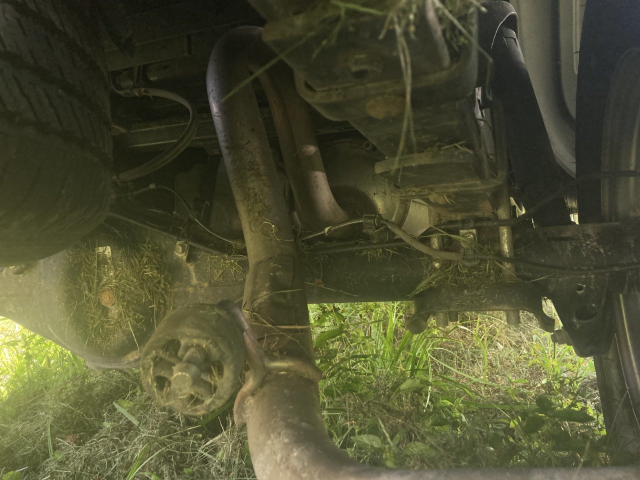

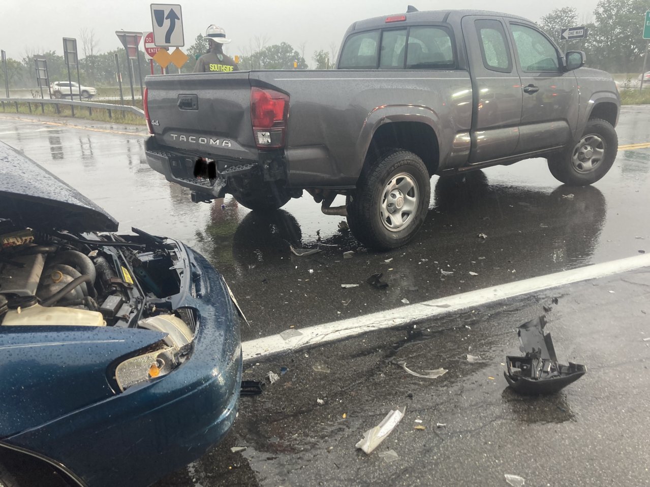

    I got rear ended the other day, two weeks out of the dealership
    2018 certified pre owned 32k miles on it.
    Obvious bumper and tailgate damage in addition tailpipe yanked down and wrapped tightly around rear wheel.
    Adjuster coming out in a couple days and the guys at tow yard/body shop said he’s not particularly thorough and sometimes underestimates in their opinion.
    does anyone have advice on what to make sure he evaluates re:frame etc.
    Thanks so much , I use my truck as a hauler for a living and can’t risk making it more vulnerable to damage later

    Take it to a reputable body-shop! The adjuster will under value the inspection, just had this happen to me with my '22. Adjuster said it was 6k and my body-shop supplemented another 12k to the claim.

    Looks like you could have Whiplash after that collision. You should have your Dr look you over. That's what i'd request !!

    Why is there so much grass on everything? I would check the frame and the trailer hitch. It looks like the hitch probably took most of the impact and prevented more damage.

    Is it just the optics or is that front passenger tire cockeyed too? Take it to a reputable body shop and have them look at it. It appears the other car slid under the rear of the truck, so all the force wasn't transmitted to the hitch and frame. Hopefully they can pop a new bed, tailgate and bumper and you're good to go.

    ^^ This. Go to a reputable body shop you trust and let them deal with the adjuster. If they find more damage once they have it apart they will contact the adjuster on your behalf and get a supplement authorized. Telling the adjuster what to look for will not help your case. No one likes to be told how to do their job.

    Differential looks caved in - the rear axle is shot too. I’d really check the frame, especially where the leaf packs mount to it.
    The drive shaft probably transferred the shock of the hit forward too- are the shaft and bearings OK? Also check the tranny…

    Front and rear passenger wheels look bent. What did you hit?

    Sadly, it very likely is a write-off. This is my '18 from January of this year:
    A hit in the hitch seems to almost guarantee frame damage with our trucks, and Toyota doesn't recognize frame repair, only replacement. They were going to put a new frame on my truck, at a cost of >$30K, but the frame itself was a minimum of a year out, so they totaled it.

    Beyond the obvious body parts - frame, rear diff (to include pinion and all operation), drive shaft, Trans output shaft - basically walk the driveline up from the rear.
    I got rear ended in my 89. I was stopped. The car that hit me was doing ~55. I had to use the bottle jack to peel the bumper away from the tire, change the tire and drove it home but you could tell the rear diff was messed up. Pretty sure the bumper being pushed so hard into the curb drive tire tweaked the entire rear end and the pinion ended up bent as shock went forward from the hit. Basically - I put it to the floor, stepped off the clutch and heard it pop because it was causing my truck to lurch as it tried to spin. Had to use 4wd/Front wheels to get around for 2 weeks before the ins totaled it.
