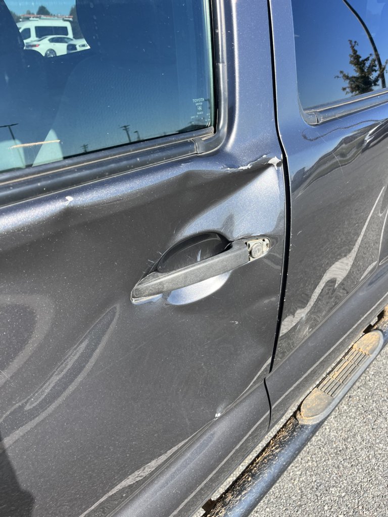

    My niece has a 2014 double cab 5 lug. A deer ran into the road and bounced down the side of the truck. She definitely needs a new driver's door and a new rear door on the driver's side. It looks to me like she also needs a driver's side quarter panel.
    I suspect that the insurance company is going to total it. Do y'all think I'm right? I'm trying to prepare her.

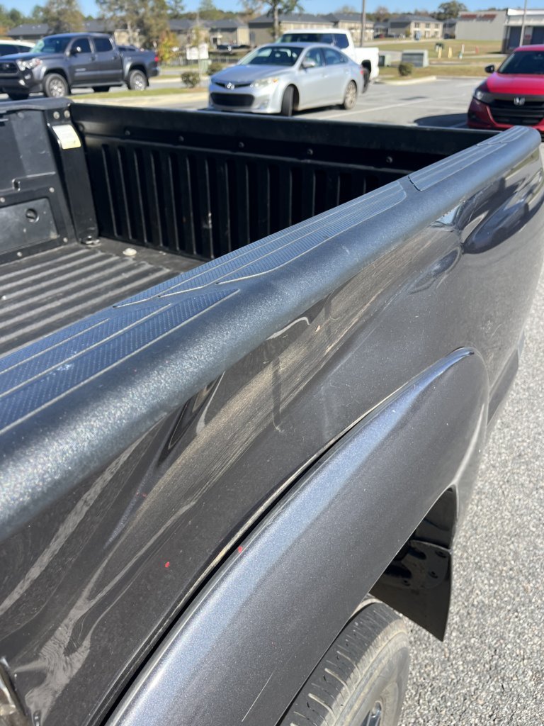

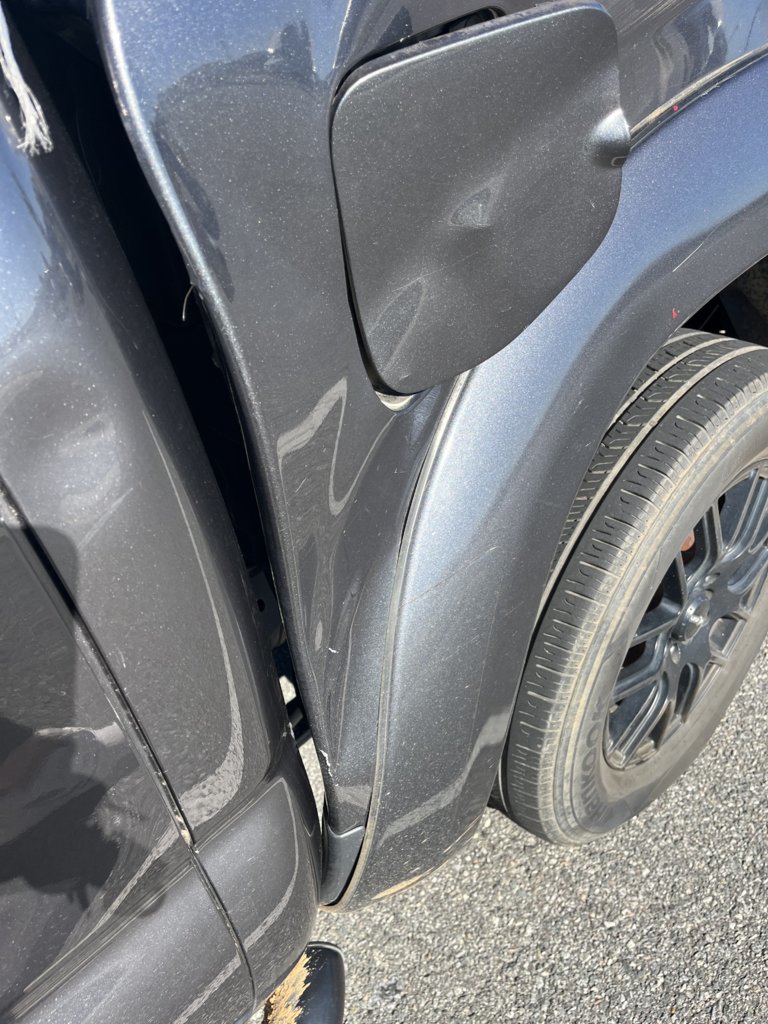

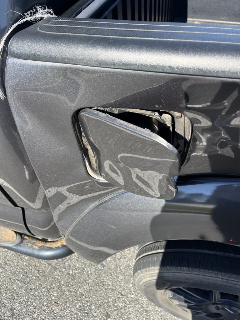

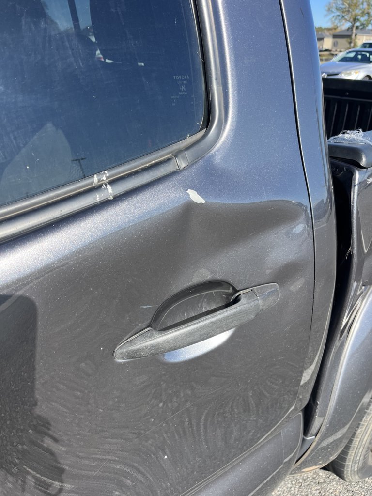

    Here's some pictures. Sorry about that.

    My thought process was like this. It looks to me like $10k to $12k in damage. I think the truck is worth about $15k. Which of my guesses is wrong?

    Real quickly make a Toyota acct and log in and price an OE front and rear door and the bedside. Those 3 pieces are less than 3k. Paint, no bodywork needed. Swap over door parts and install bedside. They’ll have to blend into the front fender. I’m betting 6-8k repair tops.

    Hey OP. Looked up when I bought door assemblies and a bed side. The doors are the entire door. For all three parts I paid $1900. They may have gone up some. that was 5 yrs ago. OE original parts from the dealer.
