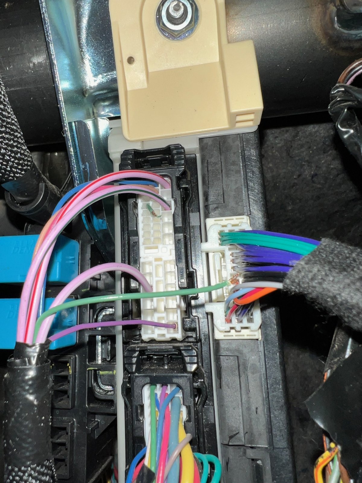

    Can't get it past it flashing through all the colors of the lights, so not there yet. Have tried disconnecting the one connector from the unit and then holding the button again but it doesn't seem to get past that point of flashing all the lights in sequence.

    Yeah it’s bricked I’ve done that before but I bought it from fortin and I have the updater I’d call them and they could reset it.
    You would need to return yours.

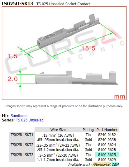

    you'll need this to remove the terminal--the 'arrow' on the top of the picture locks it into the plastic. you insert one of the tools just past the arrow to push it down, and pull the pin out the back to remove it. you'll likely also need a fine needle nose in this case to grab the original connector
    https://www.amazon.com/Keenso-Titan...ix=wire+terminal+removal+tool,aps,109&sr=8-39
    and you'll require this to properly crimp the new terminal
    https://www.amazon.com/iCrimp-Insul...ix=wire+terminal+crimper,aps,116&sr=8-18&th=1

    I would solder an extension on that stub and heat shrink it. easy pesy
