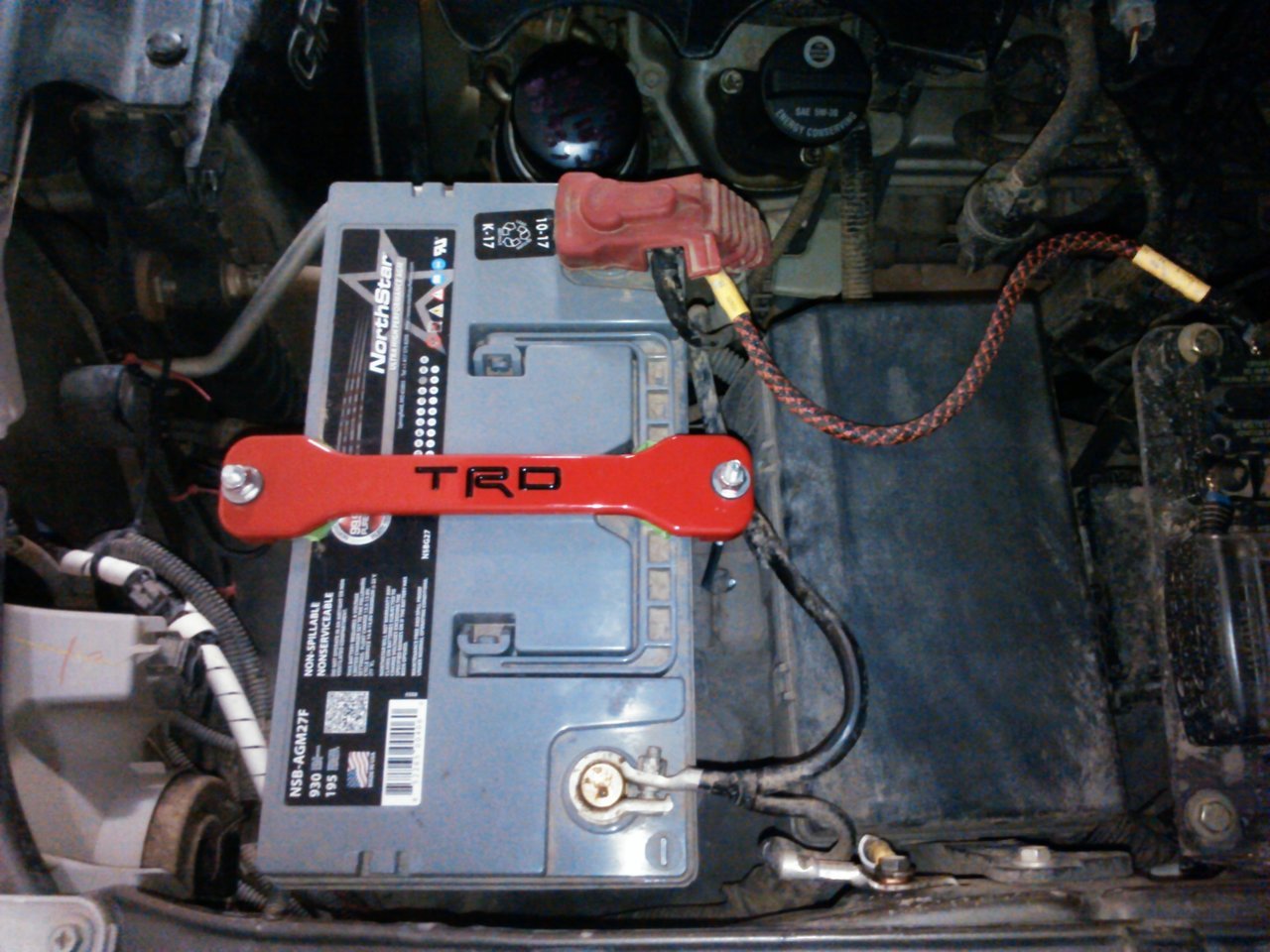

    Cut & broke off some stuff.
    New battery bracket says "TRD" so I estimate it added like 12hp.

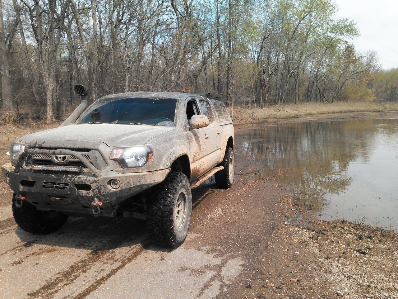

    I decided to check out a potential new fishing spot in Tipton county on my way home from the LBL meet. Funny that the lakes didn't seem high but the rivers here are still up a good bit. Just about could launch a boat from the end of the parking lot. A fat country boy cannon ball into the river would be enough to splash it out of the banks right here.
    River is behind truck in this pic and that water you see is the driveway along with some submerged parking area. Was careful not to splash off all that mud earned at the meet as I rolled through. :mudding::D

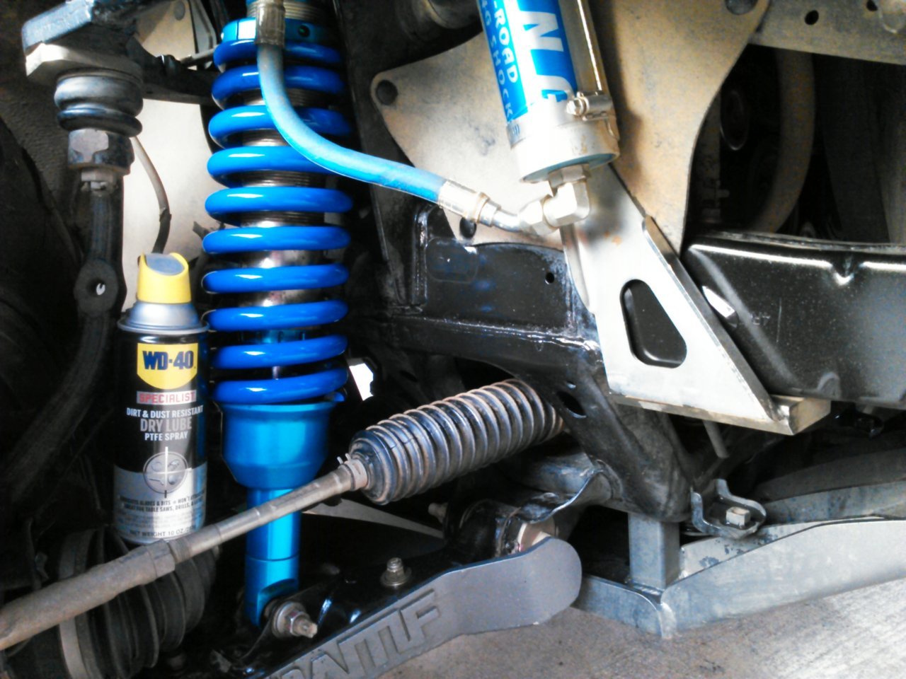

    I've never used fluid film to compare to but this WD40 Dry Lube PTFE spray is impressive for keeping mud & grime from sticking to the truck. I think, if my UCA had uniball, it would be ok for that too. I only really use it on the coilovers and little bit of frame around it so far though.
