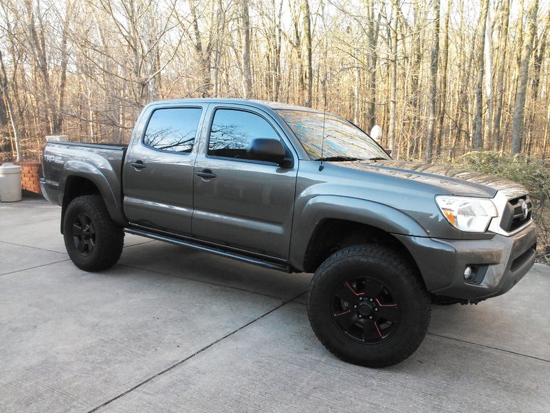

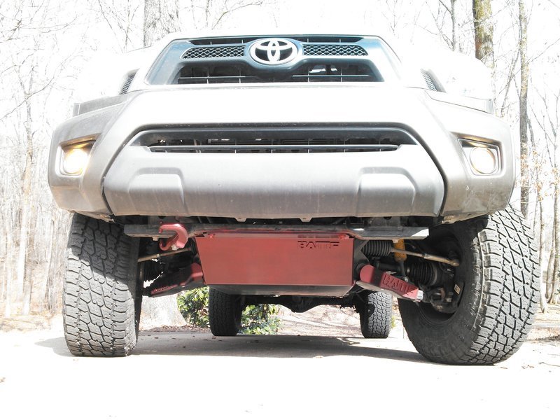

    edit 4: the latest
    THE NEW BUILD (moved the original 2005 model to post # 3)
    2015 TRD Off Road
    double cab short bed.
    Pyrite Mica
    mods so far: (as of Feb 2017)
    * some lights
    * some stuff cut off or stuck on.
    * Springs & stuff
    * some custom painted Ray10 wheels with 34x11.5 tires.
    * some skids, bumpers, etc
    *to be done someday:
    seat covers?
    homelink mirror with compass and temp display.
    With OME lift and wheels I had swapped off the 2005...
    edit 2: after the LBL 2015 trip.
    edit 3: more additions (summer 2016).

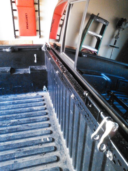

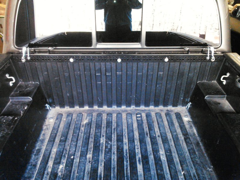

    Finally got hardware worked out to add tie downs at bottom front of bed and a front top rail with bike mounts.

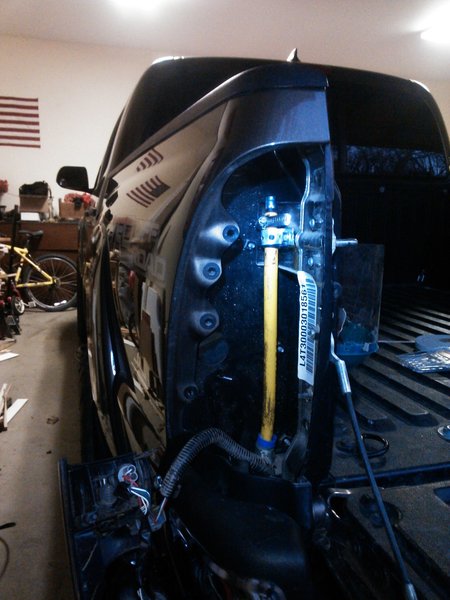

    Rear dif breather relocate and trailer harness relocate.

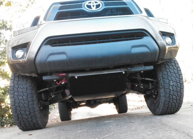

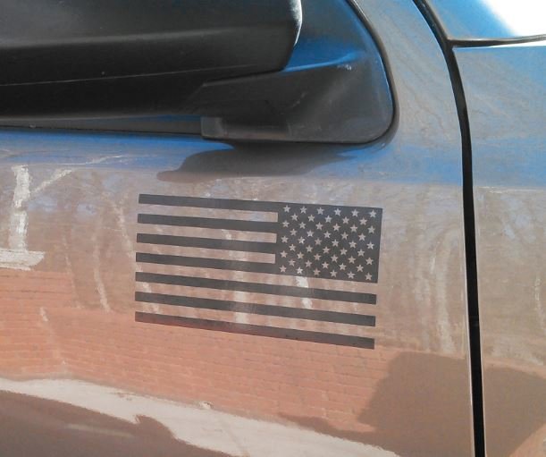

    skids and stickers :D
    edit: got a brighter shot of my skid color out of the shadows.

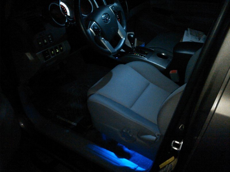

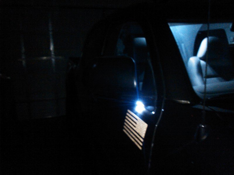

    Added white LEDs under the mirrors as 'courtesy lights' to light up ground outside the door when dome light comes on. Also put some LEDs under the front seats and in center cup holder for a little glow at night but not enough to glare in the windows. Blue under the seats and UV (blacklight) in cupholder. Thought about putting some amber LED in same spot under the mirrors linked to turn signals but I'm done running wires for a while now.

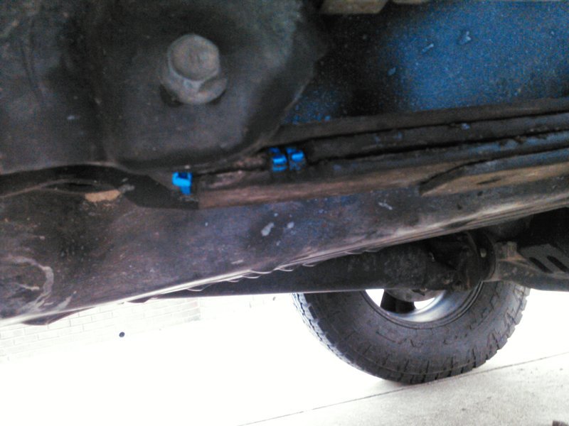

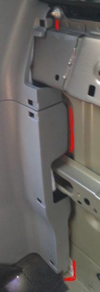

    Rattle from back seat area of double cab fixed!!!
    Also, leaf spring squeak reduced to tolerable level for now. We'll see how it holds up.
    Back seat rattle was plastic trim behind seats that's too close to metal at back of cab. You have to remove the behind the seat bins to see it. Remove the driver side section first because it overlaps the passenger side piece. There were marks in the paint where it's been chattering away. Some foam tape solved it. Left the bins out since it frees up a lot of space. Those red lines in the image show about where I ended up putting foam tape (weatherstripping or whatever you have).

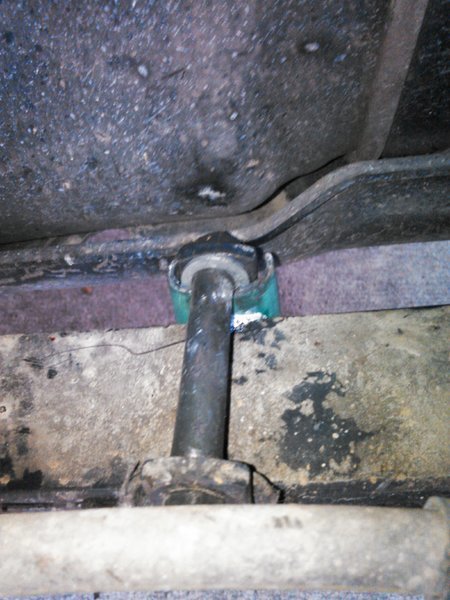

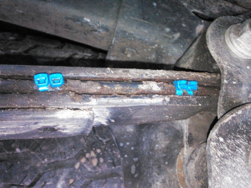

    For leaf springs, it took 2 steps to address horrible squeaking.
    a) Zip ties around 2nd leaf down near each end.
    b) Replace the cracked plastic on the front most banding and add a washer so it doesn't close up so tight. I used old heavy duty garden hose with some grease on it to replace the plastic.
    There is still a slight squeak but it's not embarrassing to go through parking lots anymore.

    My passenger leaf spring has an annoying squeak. my fix thus far has been to hose it down with white lithium every couple of months or so. need to do it again after the holes at LBL washed it all out o_O
    ChadsPride likes this.

    Yeah, mine had enough age and grime that lithium spray wasn't doing much anymore. Zipties still working so far.
