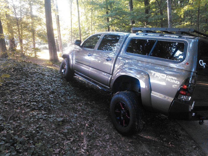

    Thanks for info. One more question. What did you paint these wheels with? They look great.
  2. May 8, 2016 at 10:23 AM
    #22
    totmacher
    totmacher [OP] automotive hypochondriac
    Sep 7, 2009
    #22430
    4,717
    Daniel
    TN (memphis-ish)
    Toyotas
    Cut & broke off stuff. Prolific ziptie and tape usage.
    Thanks.

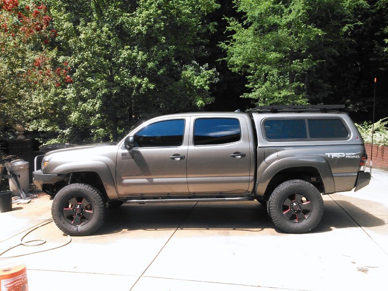

    All Dupli-color automotive paints. I painted before mounting tires.
    Primer, Universal Metallic Black, Barcelona Red Metallic, Clearcoat.
    It's been over a year, a few wheeling trips and lots of gravel roads. They've got some chips but you only notice that when they're clean really.
    When I clean them, I use the Turtle Wax Ice spray wax and wipe down with a cotton rag.
    Details if you want to try it out:
    Scuffed the shine out a little with wire brush.
    Wipe well with rubbing alcohol.
    2 light coats primer.
    Dry completely (couple days) then sanded gently with 400 grit sand paper.
    Clean with compressed air and then wipe with rubbing alcohol.
    A few coats of the black paint. Let it dry a couple days.
    Tape off and then paint the red a few coats. Because it's going over the black, it takes a few coats to really be "red".
    Let dry then removed tape carefully.
    A few coats of clear.
    Don't remember for sure but I think I rubbed lightly with a super fine scotchbrite pad and cleaned with alcohol again before doing the clearcoat.
    edit: removed the center caps and painted them separately from the wheels. Did the red logo on the caps by hand with a very small brush. Sprayed the red paint in a plastic tray to get it onto the brush.

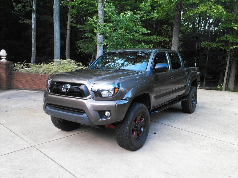

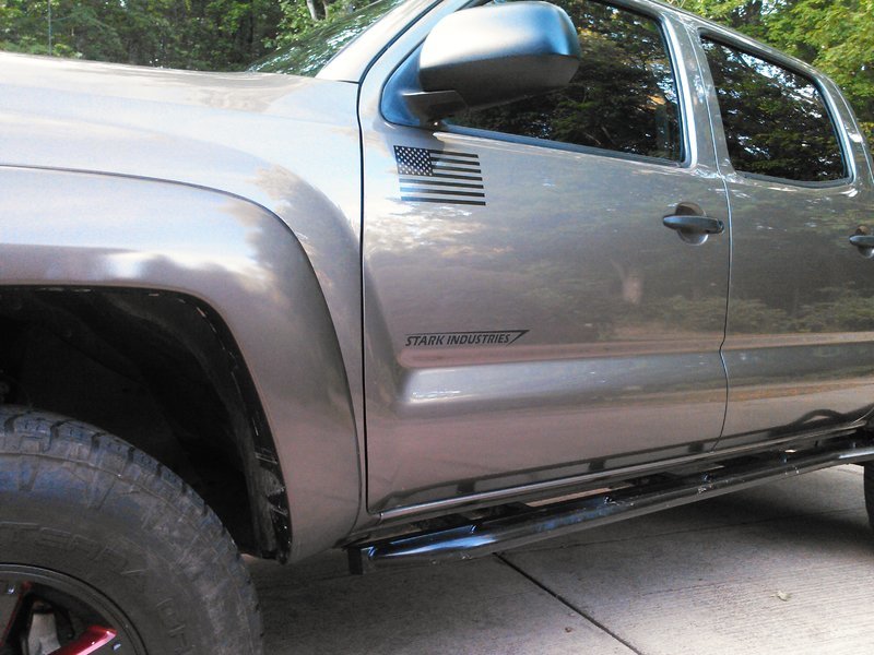

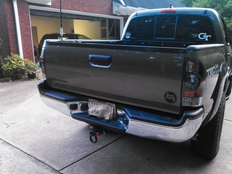

    More decals, black taillights, black headlights, and color-matched grill. Rear bumper should be here in a few weeks and then I'll finally have the chrome bits all gone.
    edit: all decals in these pics (except the stock TRD bedside) are from @CBoy808 . thanks!

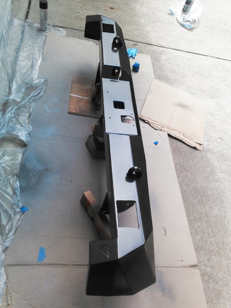

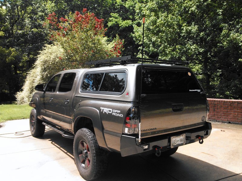

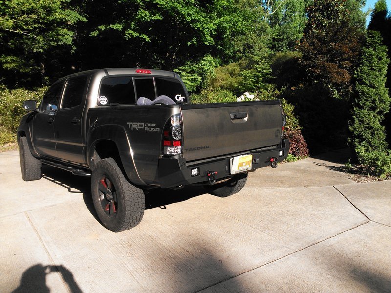

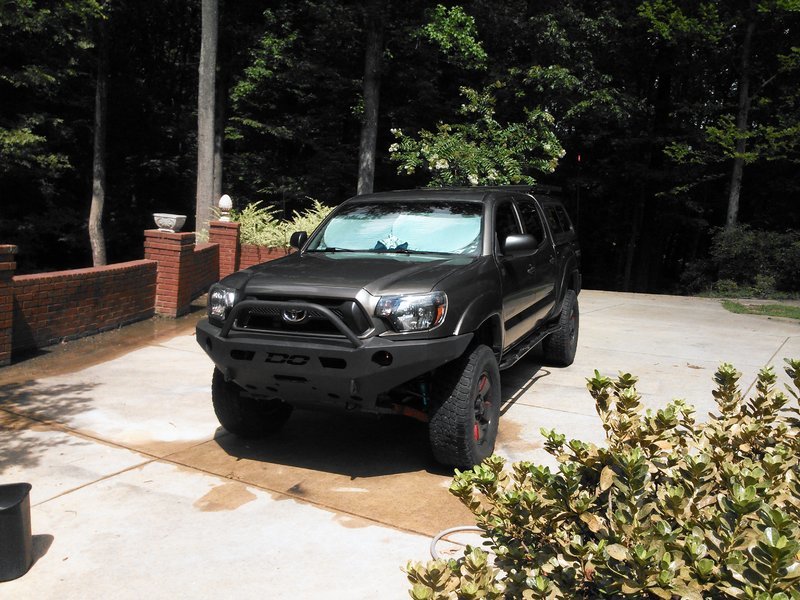

    Bumper done.
    I like the look.
    One question for @Pelfreybilt , how much gap should there be below taillight? I have 1 inch gap and bumper is up as high as it'll go.

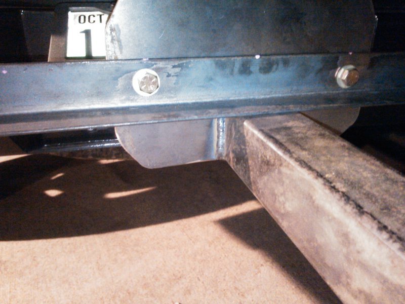

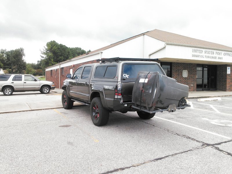

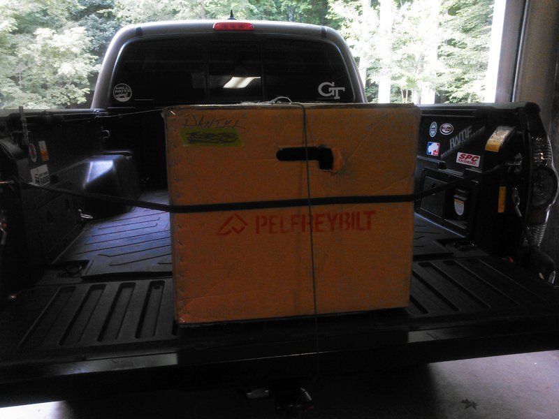

    Hitch mount cargo tray not quite finished yet but close enough to use. Held up just fine on its first use and fit the trash can perfectly. It's like I planned it that way or something. :fistbump:

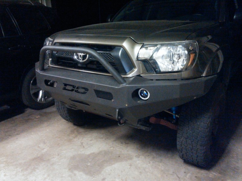

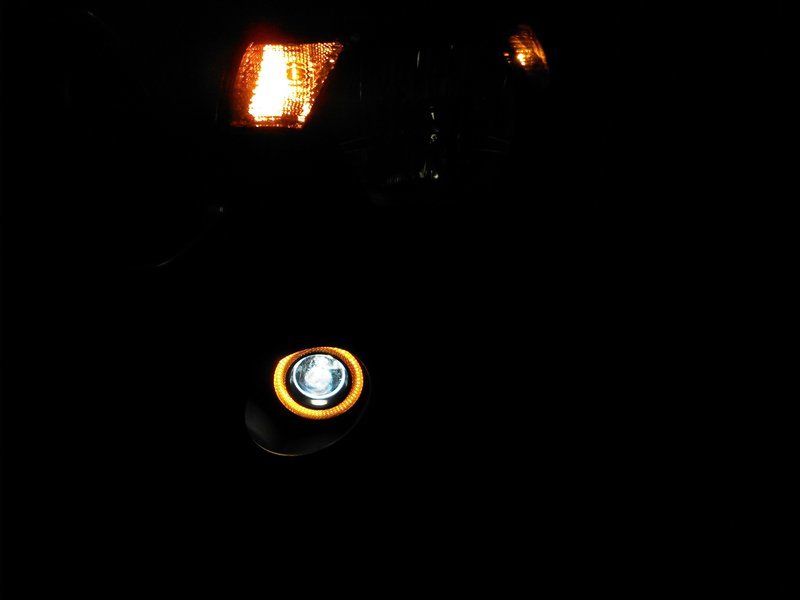

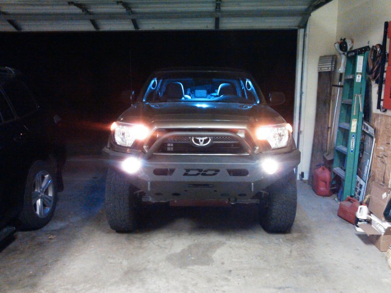

    Fog lights finally arrived. The size is a nice fit in the Demello bumper.
    Soldered some H11 sockets on so it's just plug-n-play. No cutting the OEM connectors.
    LED projector with amber halo.
    Kinda wish they were brighter but on the other hand, I think I can run these on the street without bothering oncoming cars.
