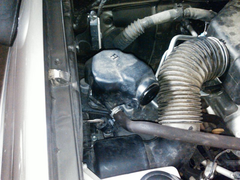

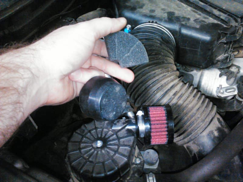

    secondary air injection so-called "filter" replaced with an actual filter.
    cover still fits.

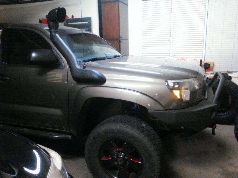

    That is sexy time right there!!! +1 for the Stark Industries too :cheers:

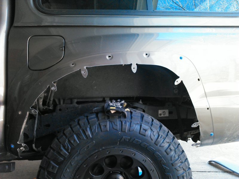

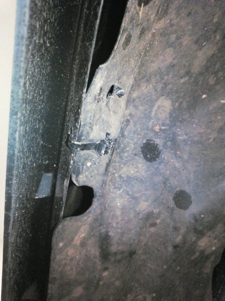

    @allmotorrex Why didn't we think of this when cutting the front fenders? Mounting tabs for the liners.Bend them in and flares will hide relief holes at sides of bends.

    I almost did that, kind of wish I had now but I'll figure something out. Started doing it on the front and ended up just cutting them off. Rear would definitely be easier to reinstall the liners or make something up.

    i just made extra holes and ran zipties on front. This is looking up behind a flare you can see it.

    First off, I'm not even subd to this thread. Haha second, Ive seen people do it. I think it looks like shit. I can't do shitty work

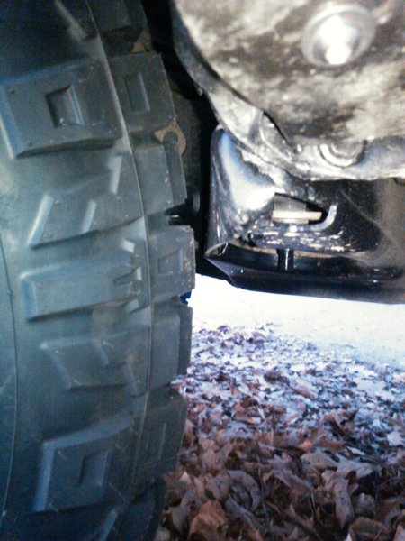

    turned at full lock and partially compressed. I think it'll clear just fine. As far as I could go in 2wd (slowly). Back tire lifted.
    Next alignment might be able to work some more clearance.
    11TRDTX likes this.

    Looks like a tire peeler

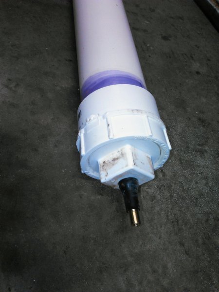

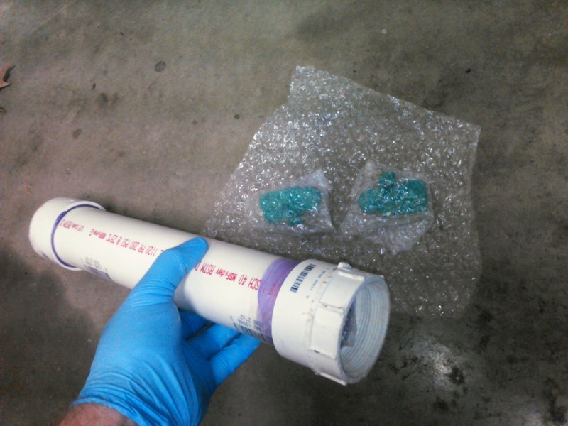

    and...
    Tire pressure light beaten.
    If you copy this, please use a regulated air supply set to a safe (low) pressure to reduce risk of explosion.
    :boom:

    nah, i hopefully won't be stuffing it while turned at full lock
