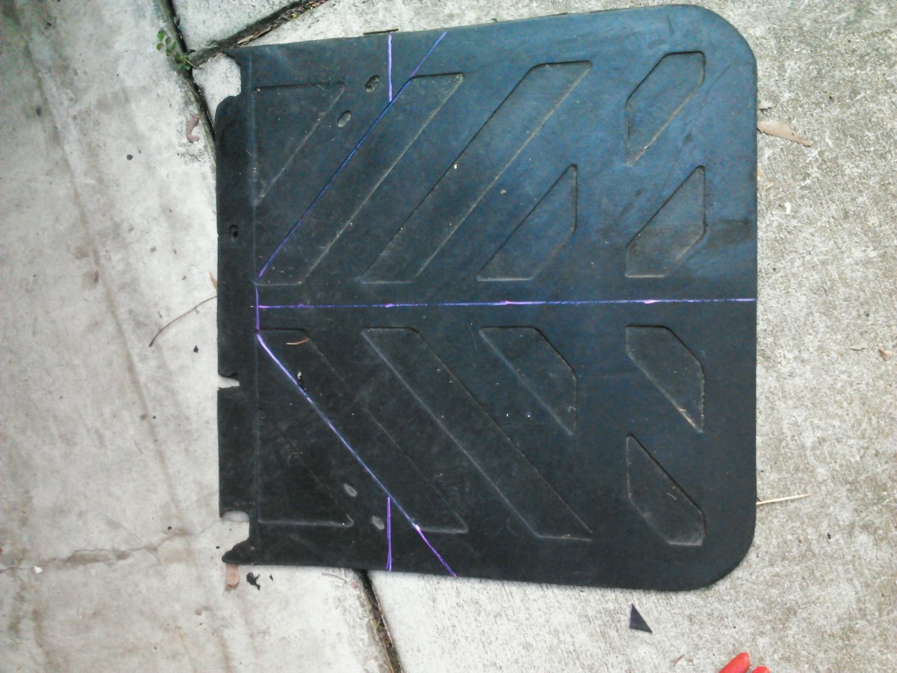

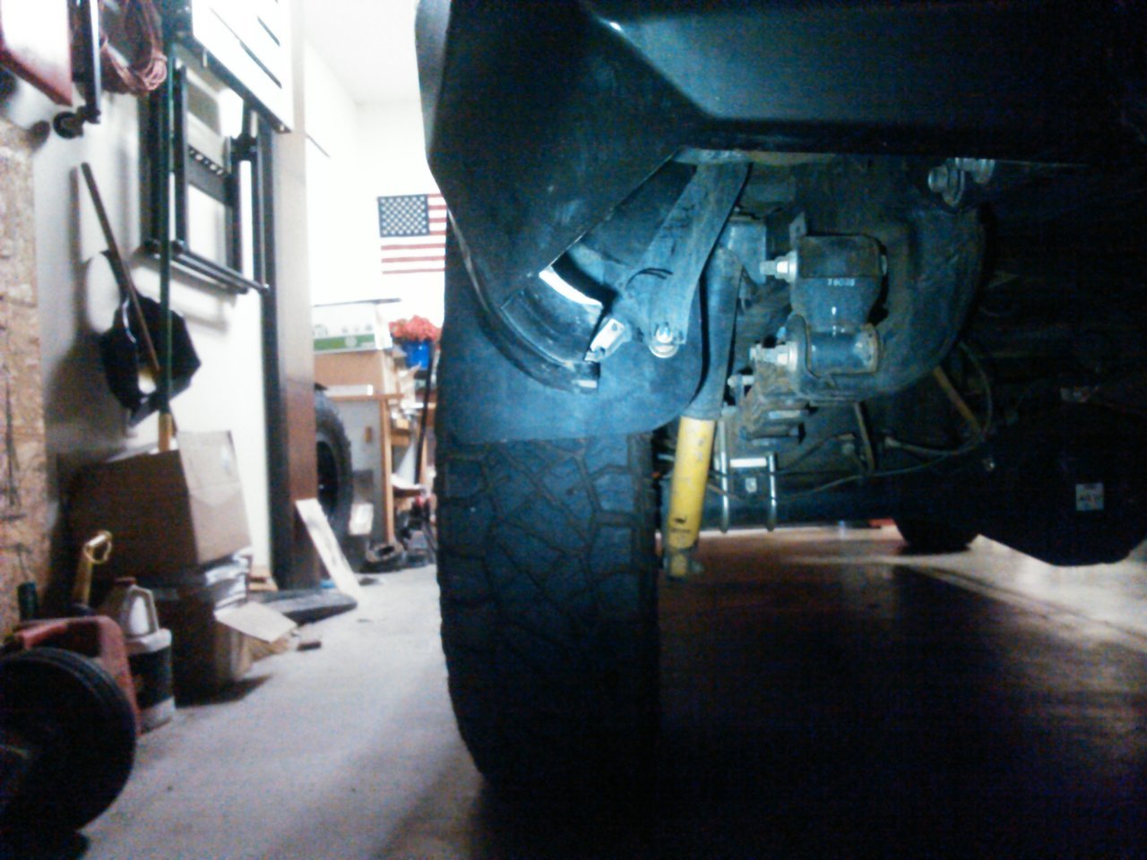

  15. Aug 1, 2017 at 6:49 PM
    #175
    totmacher
    totmacher [OP] automotive hypochondriac
    Sep 7, 2009
    #22430
    4,728
    Daniel
    TN (memphis-ish)
    Toyotas
    Cut & broke off stuff. Prolific ziptie and tape usage.
    free mudflap mod compatible with trimmed fenders is done.
    Found semi truck flap in road. Cut it in half, some shaping, and bolted on.
    Short enough that I shouldn't rip them off in a ditch but big enough to reduce the amount of mud getting caked up in the bumper. I hope.

    So...bolted to the bumper, not the location of factory flaps?
    subbed
    ChadsPride likes this.
  18. Aug 2, 2017 at 6:45 AM
    #178
    totmacher
    Sep 7, 2009
    #22430
    4,728
    Daniel
    TN (memphis-ish)
    Toyotas
    almost factory spot i guess.
    bolted to an existing bracket, a rib under bed, and one of my tabs i made before while cutting fenders.
