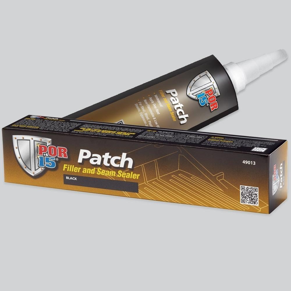

    I've found 2 ways to prevent rust on welds.
    Sandblasting before primer & paint.
    Or wire wheel then smear por15 patch over the weld, let it cure then prime & paint.
    I think most seam sealers would work, I just like the squeeze tube the por 15 comes in.
