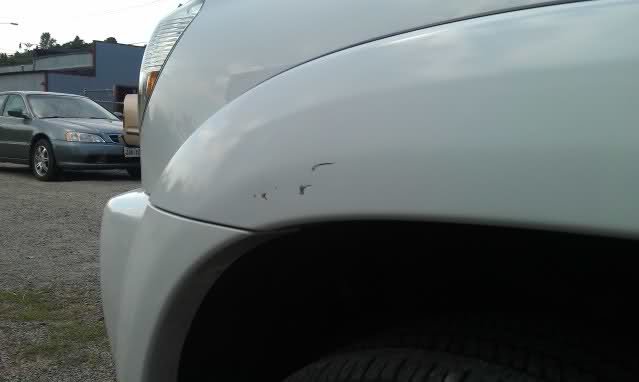

    Was moving the refridgerator out the house and thought I was clear.

    I may try to touch it up as it may take me for ever to find a use one. It's plastic so I'm sure its not going to rust or anything but It doesn't help when the entire truck is flawless except that one spot.

    I have touched similar nicks up with the OE color matched paint touch up vials. You can get it at Advanced Auto Parts for much less than at the dealer. What is important is to get clear coat also. tape around the scratches as close as you can get to it. lightly sand the edges with wet sand paper, about 600 grit. Apply several coats of white, untill it is built up enough to be flush with the original paint. Sand down a little bit with wet sandpaper, and apply the clear coat. After that is dry sand again to be flush with the surrounding surface. If done right nobody will even see it, except you, because you know it is there. If you did not do it right, like I had done my first few, and it bothers you, you are only out about $15 in paint and a little time, so if you decide to have it painted, you have not wasted much. If you take it to a body shop to get it painted it will probably cost at least $100.

    I kinda rushed on this. Is it to late to sand down?
