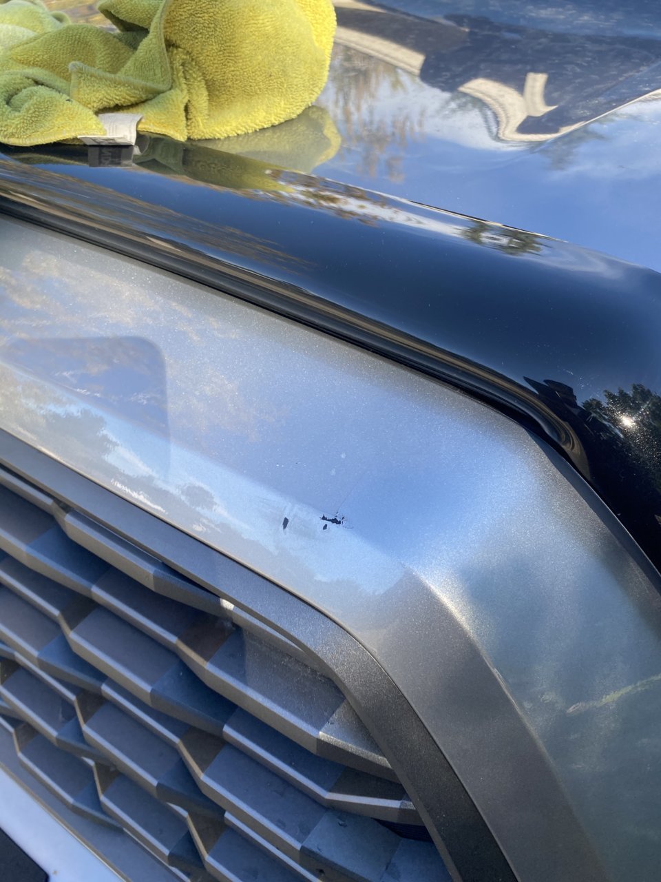

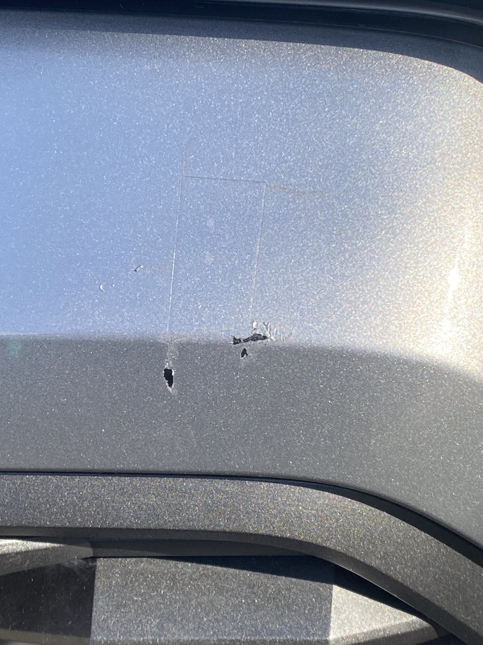

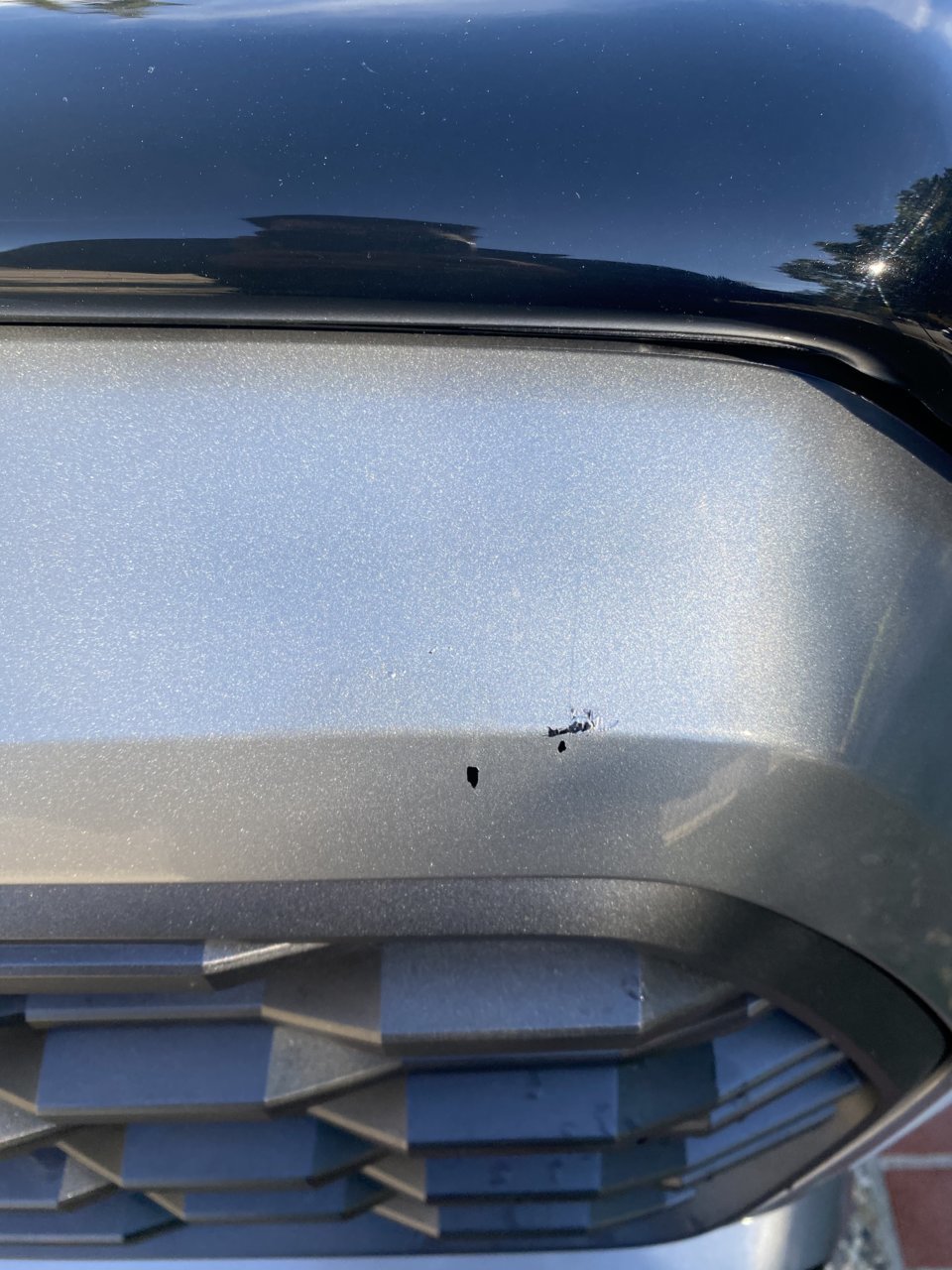

    Hi Guys- So I’m looking for advice after botching a touch up paint job to the grill trim of my truck... had a pair of rock chips on the grill trim, used the Toyota touch up paint pen to fill them in (a few layers, sanding down w/ 3000 grit in between coats to even out).

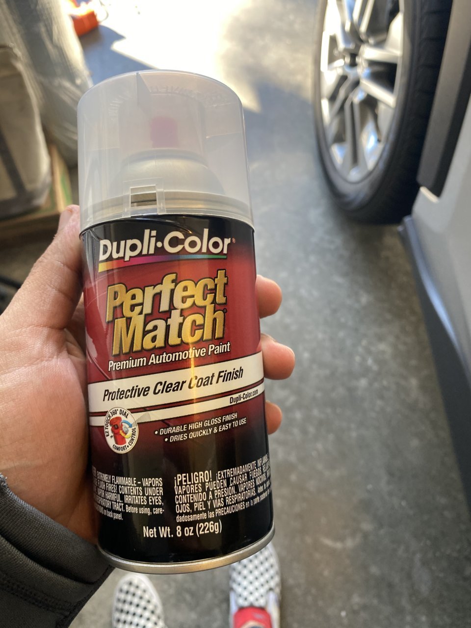

    The problems came when I tried to finish with some Duplicolor Perfect Match Clear Coat. Didn’t think the touch up paint had a clear coat since it was still slightly off color. Applied one quick spraying w/ the Duplicolor to test with no issues. Then framed the area with blue painters tape to apply the next few coats per their instructions (three light coats one final heavy coat waiting 10/15m between). When peeling off the painters tape the factory paint underneath had started to bubble and lift. Pics below of the damage...
    Any idea why this happened? Wrong paint? Wrong tape? Wrong technique?
    Should I try to go about fixing this with more touch up & avoid the Duplicolor Clear? Take it to a pro? Get a replacement grill trim from Toyota?
    TIA

    As for what happened, from what I can see, it looks like the thinners in the touch up spray were too hot (strong) for the paint below and dissolved some of it. As for the fix, you'll need to sand everything down and feathering everything out, then start over again. That said, using rattle can paint is never going to give you a durable finish. On the front end of a vehicle where stones hit all the time, that's never a good thing. I'd suggest that your best bet is to buy a used grill. You can easily find them in Craigslist, FB Marketplace of right here in the Classifieds.

    Touch up Paint alone will not fix that damage. You've dug into and even raised a bit of the base material. The best you can hope for with conventional touch up paint - either the brush bottle or rattle can - is to somewhat minimize the damage.

    The "fix" depends on how picky the owner is. If you're anal like me, it's got to go to a collision shop and the whole bumper cover needs to be re-painted. (They will sand and fill defects like the one shown first.) If somebody is not very picky, they can try to fill the area with several coats from a brush touch up bottle. This won't look nearly as good though.

    The rattle can clear coat is basically a disaster... will end up lifting paint worst case, cracking paint best case.
    Called it a day after a second attempt & just threw on some three-stripe vinyl decals from tacovinyl. Will worry about sourcing a silver surround from a salvage yard/forum/craigslist or repainting later.

    And to answer your first question: the result before clear coat was mediocre at best. Definitely less noticeable (esp if you’re not looking for it) but not even close wrt getting back to stock.
