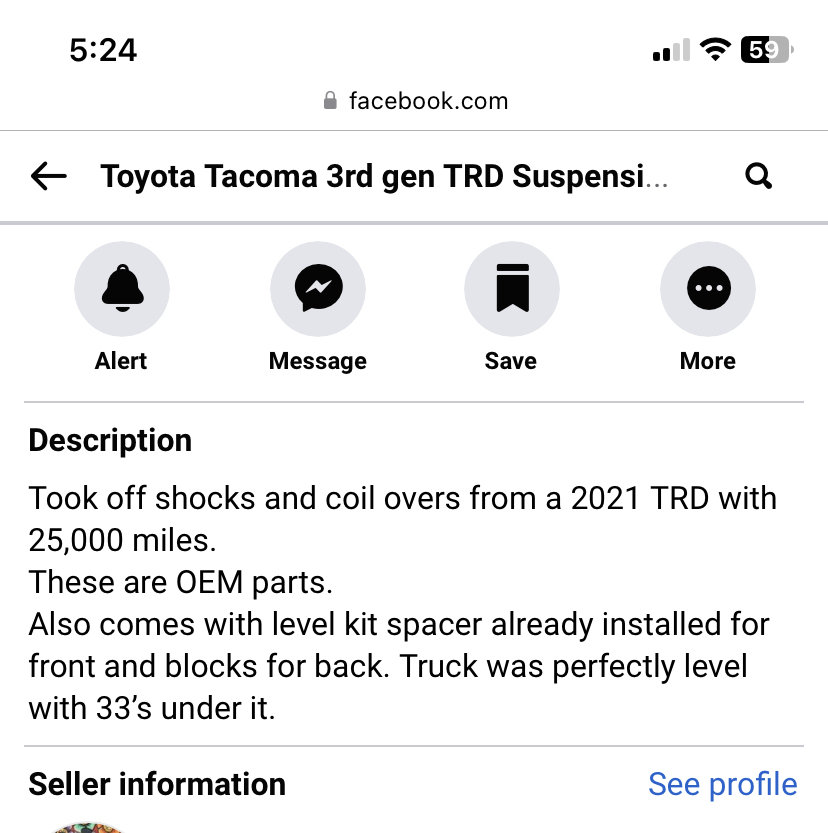

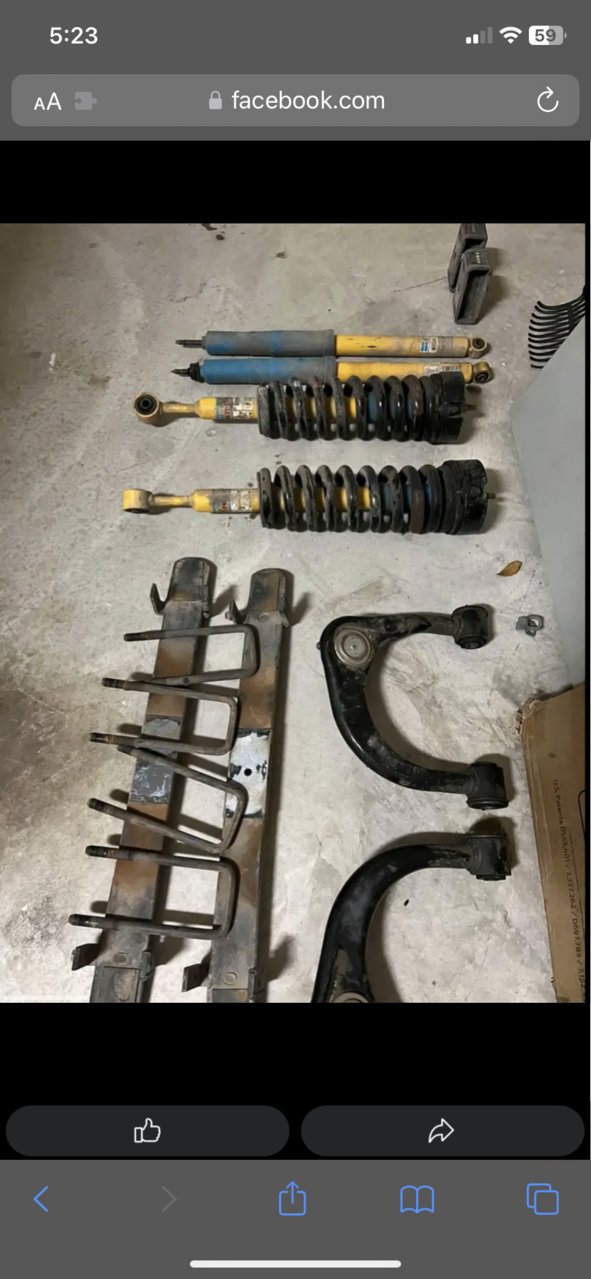

    D45CF2C9-5C23-405E-B5E2-94055A50B1AC.jpg 2FD5B1BE-E92F-44FE-8D8F-7D2D700305CF.jpg Looking locally I found this. From what I read on here the 3rd gen suspension bolts right in except for the LCA . I just wondering what else I should need or not use with buying these. I have 2008 Prerunner sr5 4.0

    Unless your UCA’s are crap, I would not do a lateral swap, will not gain anything but busted knuckles. The rest bolt right up. Hold those for spares

    Those look like a hard 25k miles. I’d wait and get some with 25 miles on them.

    Cool that’s was what I was wondering geeves. Yes, was also curious about wear off the suspension but hard to tell with just pictures
