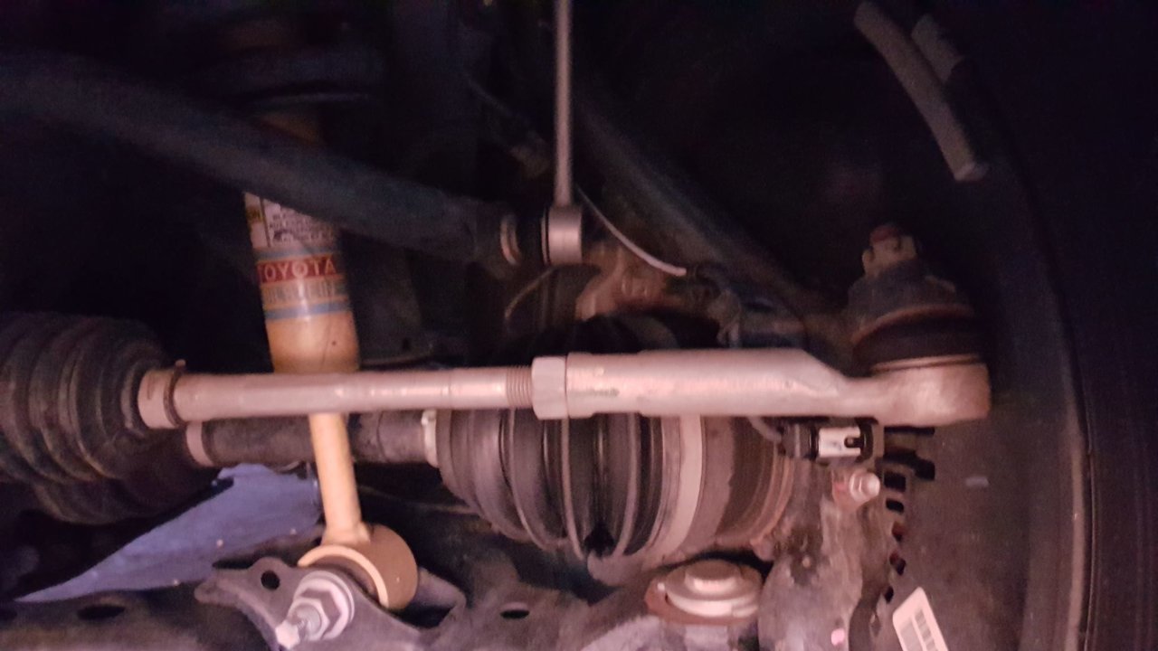

    51704672_1868400053288131_4163156764025421824_n.jpg 51856670_1113080985527046_9103982494465654784_n.jpg
    Can't tell right now I will take it to the dealer tomorrow and see what they say.

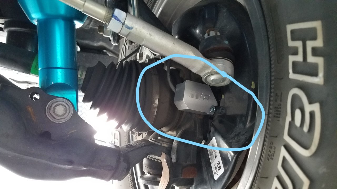

    Unless you have an ABS warning there isn't anything wrong with it. I've never met anyone that has damaged those sensors, and as far as I've seen myself, those sensor guards are pointless.
    Depending on how hard you hit the rock you could have a couple things going on. Possible things: bent spindle, bent inner tie rod, flattened a cam tab, and more shit that I can't think of. The VSC warning can come on whenever your alignment is thrown out of position, it receives an input from the steering wheel angle, so whenever it gets knocked off center it can throw out VSC.

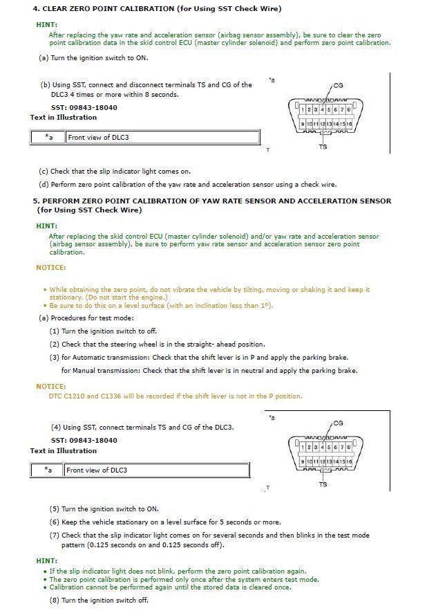

    Fixing the VSC would involve identifying/fixing what threw the the steering wheel off center and resetting the VSC. On the second gen it's a simple procedure, but I don't know what it is for the third gens.
