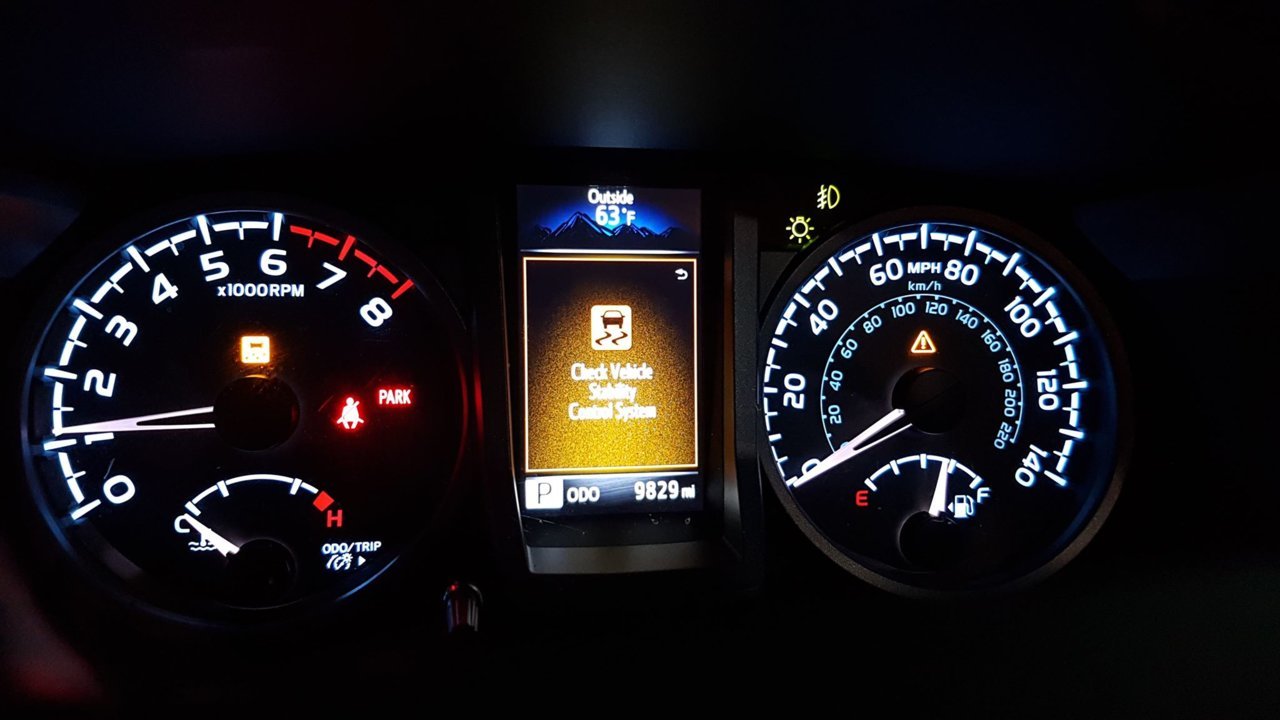

    Thanks Tetten, this is helpful. It feels like it is pulling right, but it still drove okay on the freeway home.

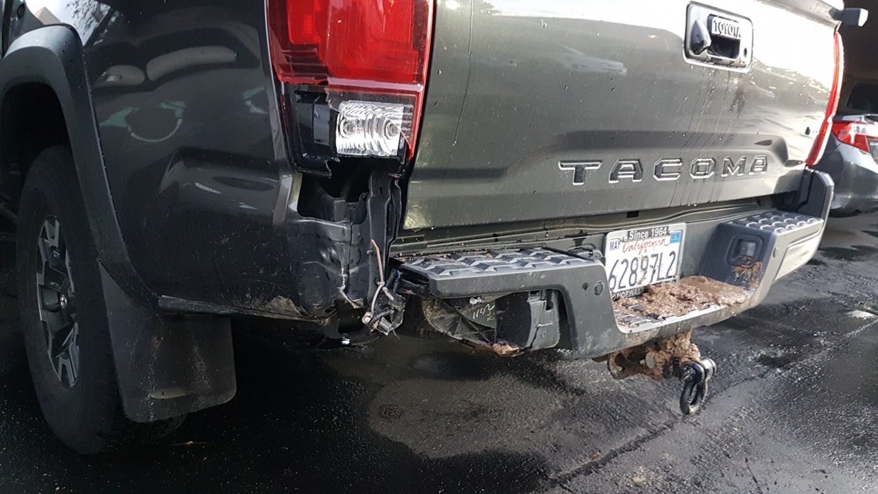

    One of the first things I see is the rear bumper where some of the sensors are located is jacked up. Good chance that has all the systems in a panic. I have seen similar messages when mine ice up with dirt and road grime in a snow storm. But if they are torn out or the wires damaged I am certain you will get a crap ton of dash warnings. Just my thought on the matter.

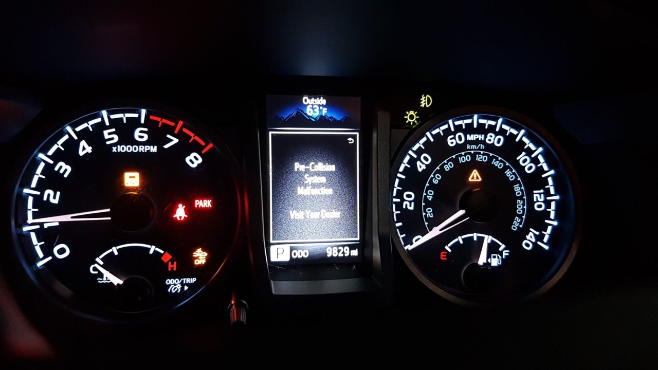

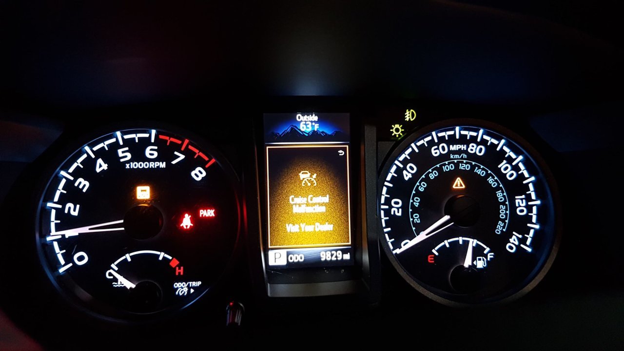

    Thanks guys for all the help so far. Turns out the alignment was off on the front and Toyota is saying they can't get rid of all the messages until I replace the sensors, bumper, cap, etc for ~$4,000. The alignment was $140, but $4,000 for some plastic housing for the sensors, wires, bumper cap? You guys think I should take it to a body shop and see if they can fix it for cheaper? Any body shop suggestions? I'll attach the estimate when I get it.

    I think at 4k couldn't I just replace the bumper with a new HC bumper that supports bsm and get new bsm sensors and install somewhere else? Then take it back to the dealer and have them recalibrate everything.

    The dealer says they can't recalibrate anything without replacing those sensors first and that requires a new bumper, 1-2 bsm sensors. If you separate it out, you could reuse the step, right cap, lights and 3 working bsm sensors, but not sure if they sell it that way?

    It might be time to get techstream and take a look yourself. I highly doubt that bsm, and parking sensors are keeping all tss from being calibrated.

    I figured it was those sensors being sheared off. Sorry Op, it is the age of sensors and more sensors. I think you will have to bite the bullet and get some new BSM sensors at a minimum. I like the suggestions others have thrown out there about getting the bed fixed, and go with an aftermarket HD rear bumper that can facilitate the BSM sensors. As I stated previously, I have had messages pop up just from them being ice covered etc.

    Alignment was done for $118. Looks like everything on the wheels checked out. Now I am just trying to figure out the back damage and bsm sensor issue.

    I still don’t buy it’s the sensor. Dealers are lazy and don’t find the route cause but rather replace parts quickly in hope of a fix.

    That seems odd because you can turn off the BSM and parking assist and that should take them out of the equation......you'd think.

    I tried to do that and it doesn't really do anything. I too wish it was an easy switch of a button to get rid of the errors.

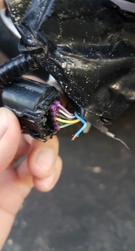

    Yeah I took a look at the sensors and it looks like maybe one of the parts had a stripped wire, but nothing that shouldn't be too hard to fix?? 51737909_492020857992076_6202947465742647296_n.jpg
