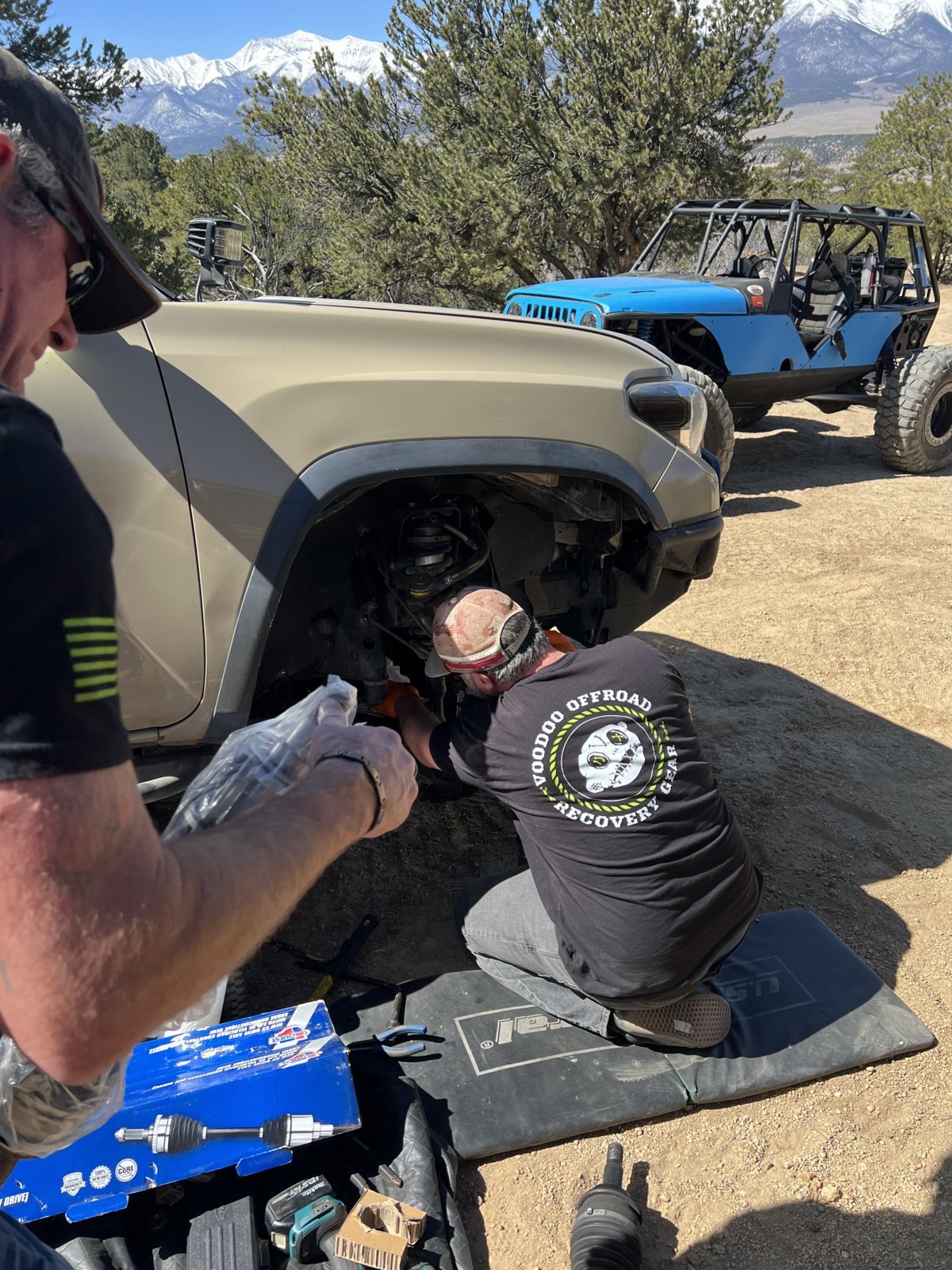

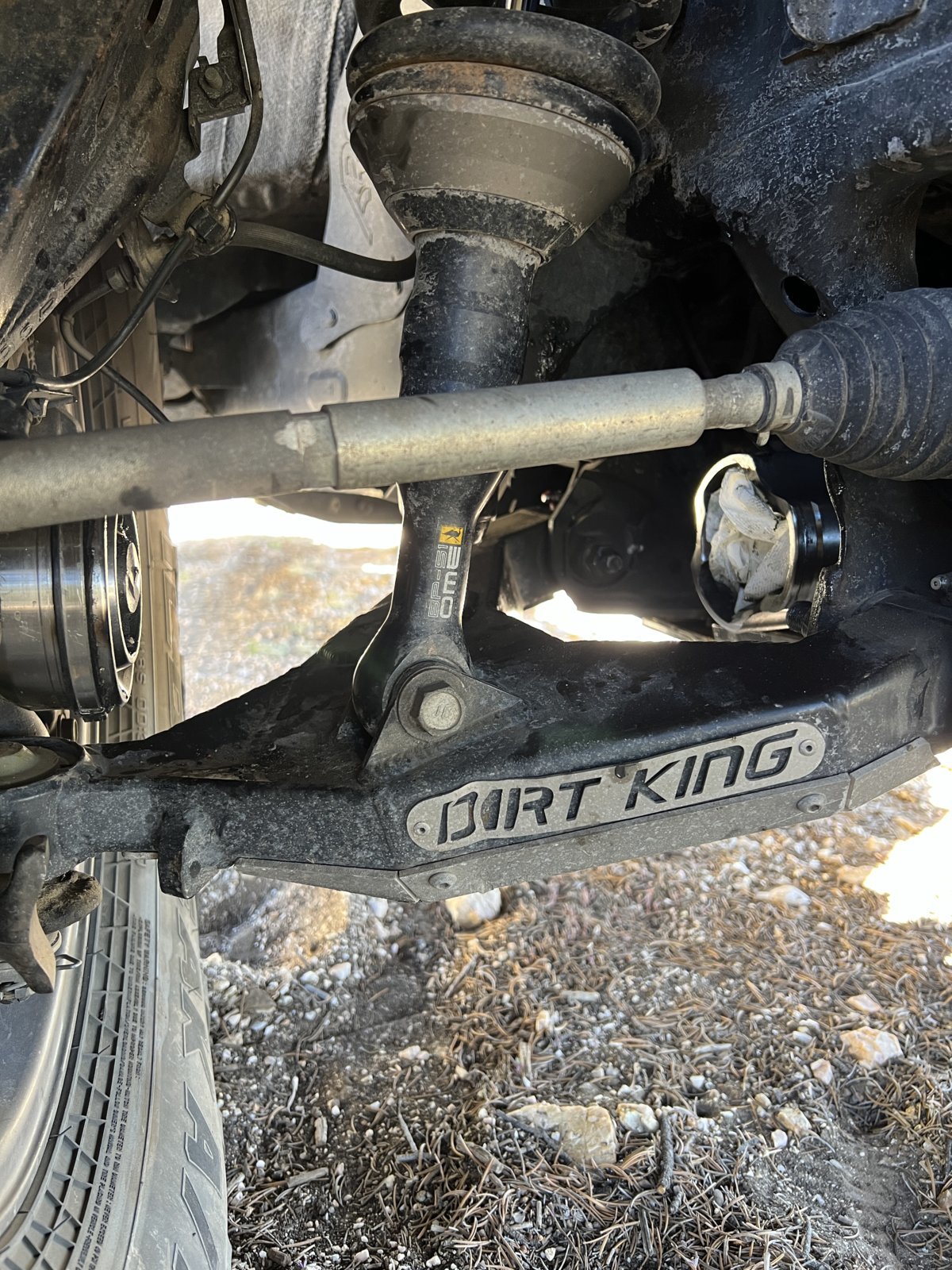

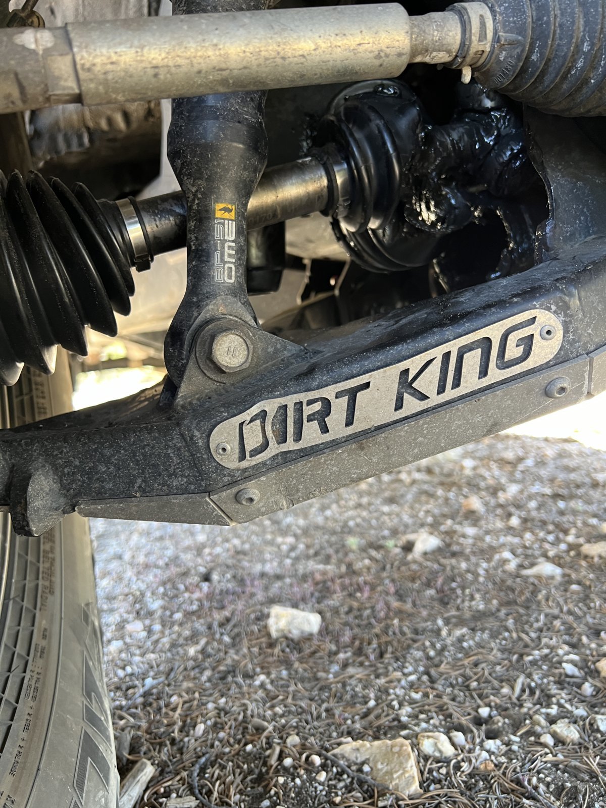

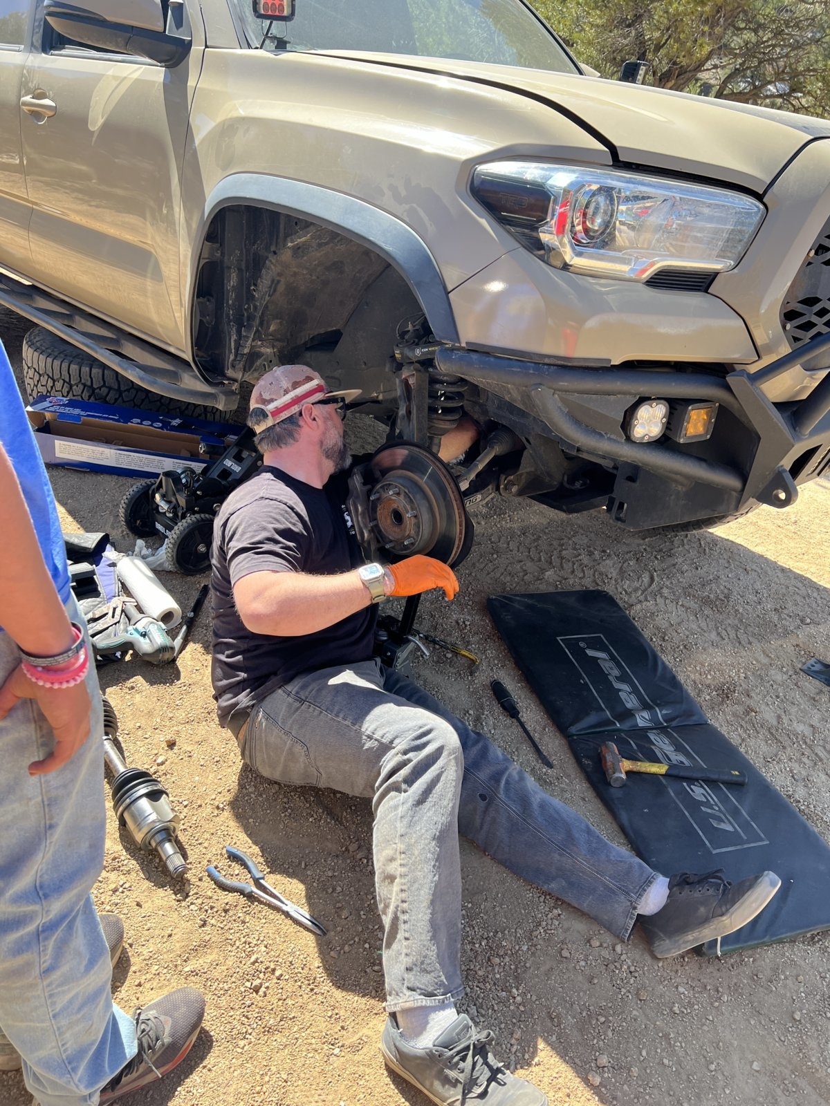

    Had a tough day in BV on Sunday. Went out to go wheeling with some friends and ended up breaking a CV. I had my spare CV and everything I needed to replace it, so no big deal but it was strange to me because I just replaced my OEM about a month ago with CVJ reman red boots. This was the first time I was on trail with the new axles. After replacing the blown out CV about 200 yards down the trail the replacement CV pulled out the same way the first did. I removed the CV, cut the shaft, left the cup side in the diff and bolted up the stub to the hub side so I could limp out. Clearly I have something else going on with geometry, binding or droop.
    After the replacement of the OE Axles in my shop about a month ago I did notice that the clearance on the passenger side was smaller than the driver side. I assumed that this was from my suspension on the driver side being brand new (4wp destroyed my coil over while pressing out a spherical bearing and replaced the coil over). The boots cleared my LCAs and everything looked normal besides the slight difference in axle shaft clearance.
    looking to see if anyone has experienced (multiple) blown CVs. I think I might have a blown passenger side coil over with a busted internals that allowed for more droop, leading to the cv pulling out. I talked to CVJ and they told me that nothing keeps the bearings on the diff/ cup side of the CV in but the relationship between the diff and the spindle and the boot. If the axle travels too far, it just pops right out and destroys the inner boot. Since this happened to me twice in a row, I gotta think that something is allowing that side to move too far. I also thought it could be spindles, but I welded the spindle gussets, so less likely. I have limit straps, they were just not installed on that trip because they rub at full lock and the tire started to degrade the strap. I am kicking myself for not putting them on before this trip.
    I am currently driving around with my bluetooth axle setup and everything is driving fine, no lights on the dash. So what do yall think is the culprit?

    oh i noticed u are running extended LCA as well, is that correct? that doesnt look like stock LCA, so kinda looks like maybe during droop u pulled to much and cv partial disconnected from inner and when u turned it just pop'ed out.

    ^None of that matters. The shock limits droop. Since @FranksGotTacos isn't running a top plate spacer, the only way for the shock to extend more is an internal failure in the shock.

    not extended- stock length DK LCAs, same length as OE, but more beef and bling. Actually looking to sell em and swap em to the BTF fab LCAs.
