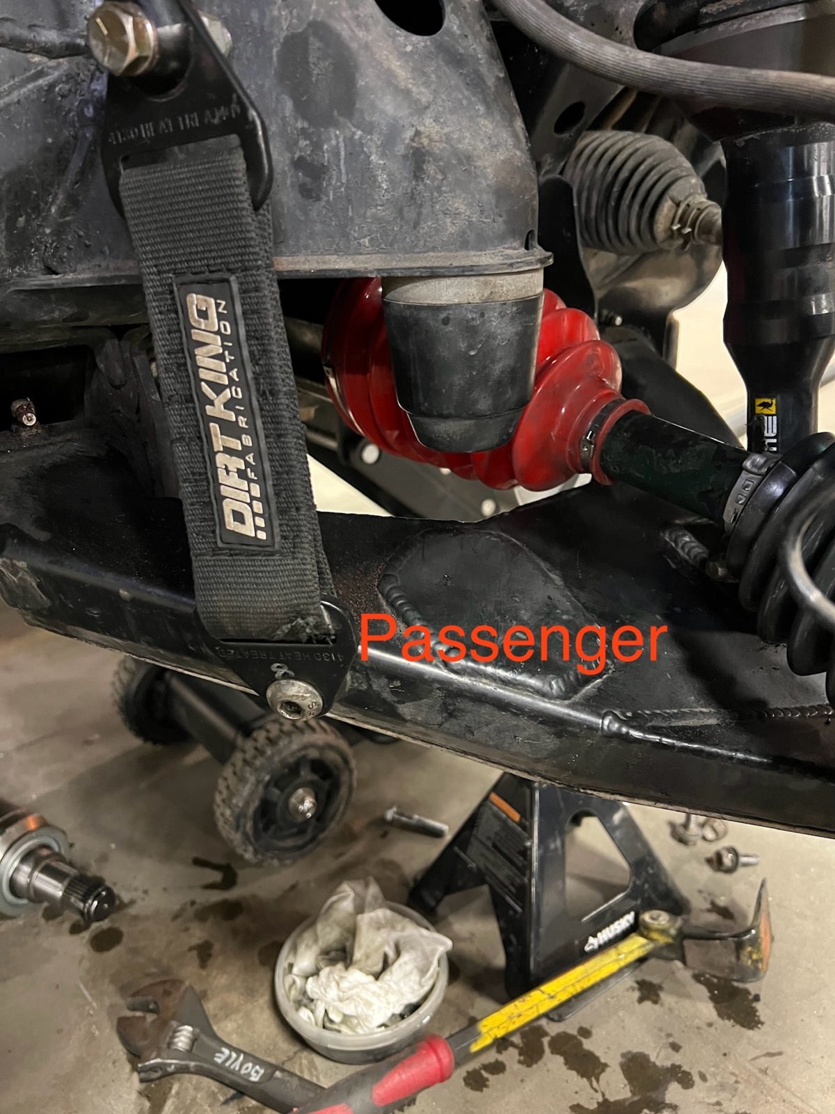

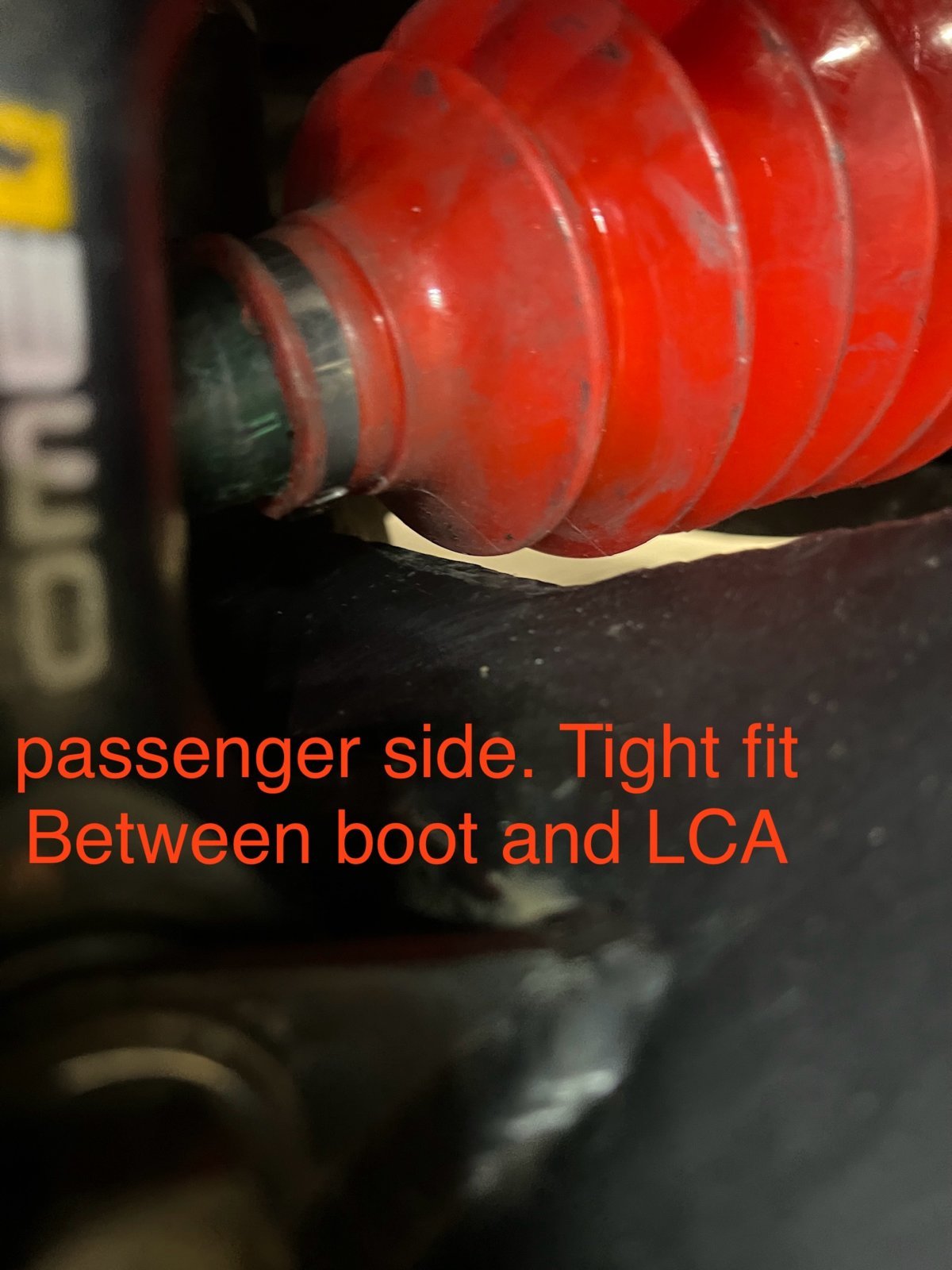

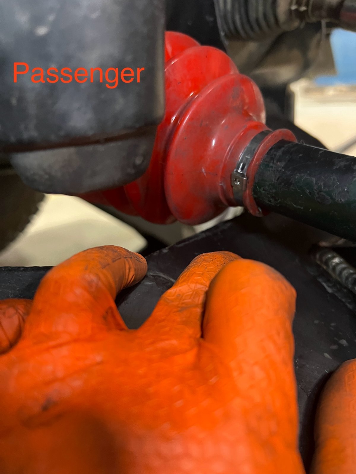

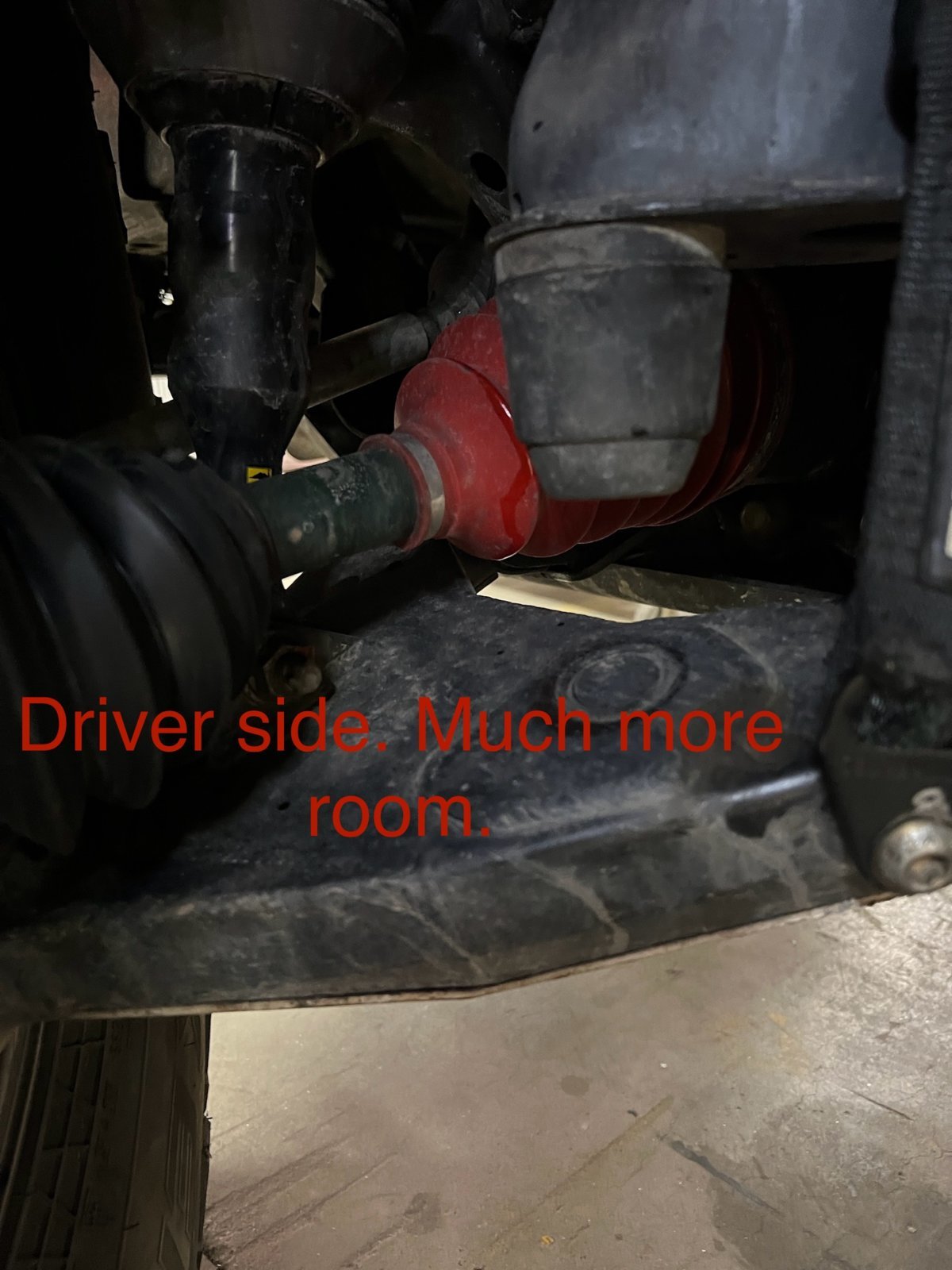

    UPDATE: I got the axle back from CVJ and an OE on the way, found a new OE on ebay for a good price. I figured it would be good to put an axle in it so I can try to figure out whats going on. After pulling the bluetooth axle pieces out and swapping the new one here is what I found:
    Passenger side axle is about 1/4 to 3/8 off the LCA. Driver side is sitting at about an inch. I added back my limit straps back until I can truely figure out whats going on so I don't blow up another CV. I talked to a few people in the industry and they all have said similar things. Either my internals are blown on the shock or my passenger side spindle is bent. The spindle has the welded gussets and I didn't see any noticeable cracks or bends. I have spare spindles and gussets to weld in. I will weld em up on monday and see if that changes anything.
    pics taken at full droop - 1/4" with the straps

    That spacing can vary significantly with alignment cam bolt positioning. Are your driver and passenger side cam bolts clocked the same way?

    I'd check your alignment. That CV is way too close to that LCA and there's no way that isn't touching under load. Remember that limit straps stretch roughly 1" per 12" of strap and have an elastic effect so even if you're strapped, you're probably still hitting. Likewise as that bump fully compresses on hard hits.
    The spindle looks OK but hard to tell in those shots. Agree that there's something else going on here.
