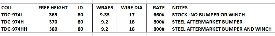

    What spring rates are being used with these on the coilovers? Since they aren’t height/preload adjustable do they offer a heavier spring for use with excess weight (Bumper, winch, skids) up front?
    I’m about to pull the trigger on Ironman FCP kit but these are interesting.

    I'm not sure on the exact spring rates, but I know that Tough Dog offers three different springs for different weight needs like other Australian brands.

    Hopefully Tough Dog or Trail Tailor can chime in on the spring rates. I’m also looking at the Bilsteins 6112/5160 combo but would need the upgraded 650lb spring.

    @bradleg - Not sure if this will answer your question or not, but this was communication provided to me from Jason @TRAIL TAILOR
    "There are 2 different front coil for the struts. An H and a HH they are both a 800# spring but the HH is 10mm taller so I’d expect to see a 2” lift up front with a bumper and synthetic line winch approx. ½” taller without."
    I did my best to not take this out of context with the additional information he provided. Jason has been VERY responsive to my questions, I imagine he will jump in here when he is available.

    Thanks for the information. 800# sounds like it could be a stiff ride.

    STRUT SPRING SPECS/RATES
