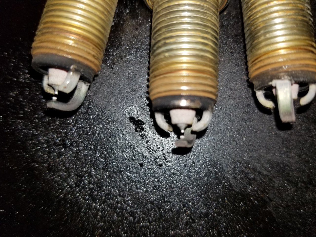

    Here are my plugs at 125k miles. These are the original. All 6 are identical. I even went 5k past what I was told by the the regional Toyota service rep and the Denzo rep. These buggers are hard to find but aside from moving a few things out of the way on the driver side they all came out easy as could be. It is an odd angle for #1 but a swivel head fixes that. All of the others are straight shots. If you're struggling use a thin wall plug socket.

    I mean, "out of their damn mind" is a little ridiculous, isn't it? Considering that you are, indeed supposed to put Anti-Seize on spark plugs that don't have plated threads. I'd say it's a pretty easy mistake for someone to make, as opposed to insulting them with "out of their damn minds".

    I will give you that OK it's a little over and I apologize. But in 30 years of wrenching I've never seen a spark plug without plated threads. Nor used anti-seize. If people are running into trouble after using anti-seize they've probably used aluminum anti-seize. Most of the struggle getting them out as just binding against the spark plug tube with your socket.
