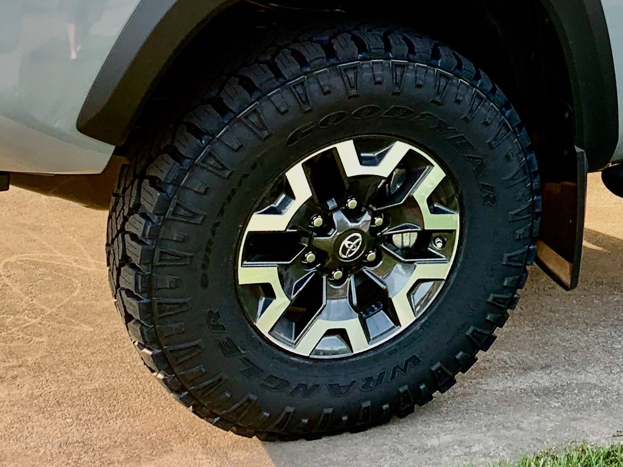

    TRD Pro suspension with Headstrong 3 Leaf AAL, DV8 OR front slimline bumper & Engine Skid Plate, RCI OR high clearance bumper, CaliRaised Trail Edition Sliders, Spidertrax 1.25" Wheel Spacers, 265/75 16 GY Duratracs, wrapped the OEM wheels, OR Roof Rack, Extang Exceed Hard top Tri fold tonneau.
    In the past I always have had LT tires on my trucks, however, the stock tire on the 2020 TRD Off-road is a 265/70r16 SL. I immediately purchased Goodyear Duratrac 265/70r16 SL's for my Off-Road as a replacement for the OEM All Terrain w/Kevlars at the advise of the Tire Shop, who said the SL tire was used by many with good reports. I just was not happy with the sidewall stiffness, especially if off-road here in Texas. After test driving for a few days I returned them and went with the 265/75r16 E's, as they were only $12 more expensive than the C's. I am now much more confident off-road, and the difference in handling, noise, and MPG is minimal compared to the SL's and I couldn't be happier. If you are making the switch, I would not recommend an SL tire if you are doing any off-road driving at all. As far as the C load tires are concerned, the difference between the C and E is about 12lbs, but you go from a 6ply rated tire to a 10ply with the E, and also have a 3 ply sidewall. I don't have a direct comparison with the C versus E load Duratrac, but from what I have heard, the handling and fuel mileage difference is minimal, and for $12, you buy some extra insurance against sidewall punctures. Mi dos centavos.
