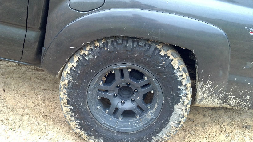

    My trail grapplers are great on and off road... only negative is weight. You will need spacers, trimming, and cab mount chop with factory TRD rims. What are your proposed wheel specs?

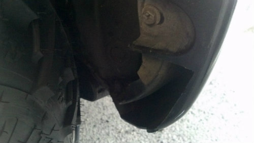

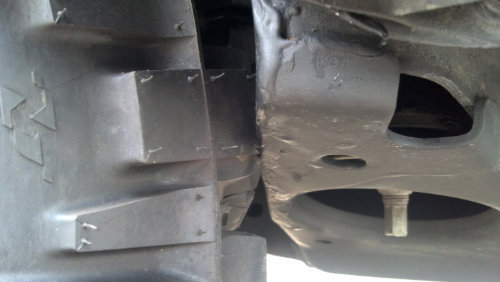

    Lift only changes how much compression till it rubs. It has no effect on what needs trimming and what does not. If you dont have 4.5ish inch backspace you need spacers. Yes you need all that. I run 285/70R17 Nitto Trail Grapplers. I thought I had the rubbing stopped till I wheeled at Hidden Falls... tiny bit more to trim still.
    Axle relocation plates needed for TSB plus Icon 3 leaf you can see why here.
    Cab mount chop needed with OME 885 and Desert Products UCA you can see here.
    Found I needed to trim to the top bulge/shelf above that bolt... this was early in the trim game.
