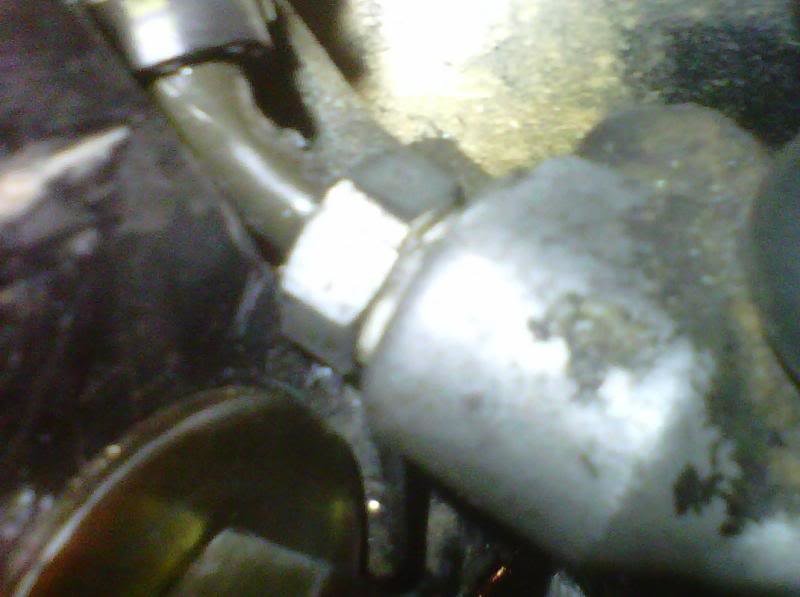

    the biggest problem though ( like everyone else that installed the lift ) has been with rack and pinion high pressure lines hitting. ive cut and cut and cut and its still hitting. its not actually the line but the nut that connects it. so my question is if i leave it touching, will i run into problems down the road with it leaking or anything?

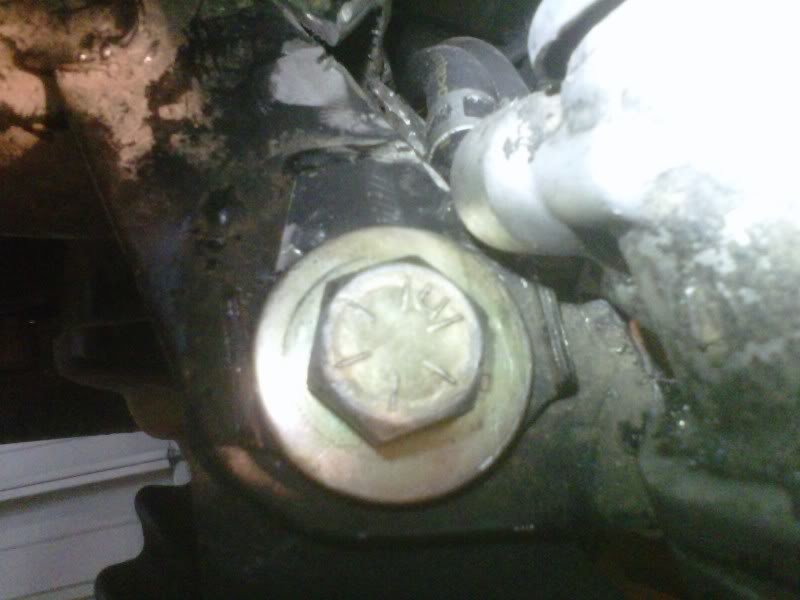

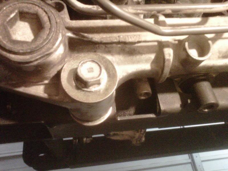

    and how important is the metal sleeve that goes inside the bushing for the driver side R&P mount?? the metal sleeve they supplied looks to big around and a hair to long. would it cause any problems if i didnt use it? besides it squishin and not torquing right?

    the 3rd pic shows how it is now.... i put it togethor without the sleeve for the time bein. would it hurt to use the old bushing that has the old sleeve still in it?

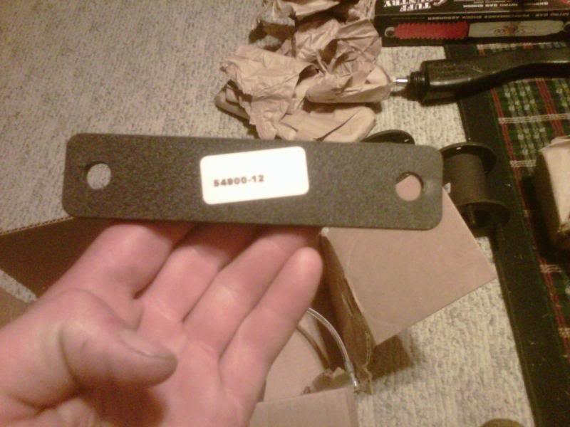

    where does this part go??

    Maybe a BPV (Brake Proportioning Valve) :notsure: Should have 2 holes on each end though if it is.

    My guess is that goes on the driver side of the axle to space up the brake lines in order to prevent them from being pulled apart/stretched when the suspension droops.

    thanks, yeah i overlooked it on the manual. its the new rear emergency brake cable extension bracket.
    any opinions on the high pressure line? i hate to cut anymore than i already have.. and i even took the line loose and bent the fitting like i had read another person had done.. its hitting the nut, not the line.

    I can't see enough of what's going on to comment on the line issue other than I would want it to be serviceable and not trapped by the new crossmember or something.
    You can have high pressure hoses made up custom with various fittings at a hose shop. They might have a fitting that would get you out of the woods.

    after some drilling i finally got the sleeve in the bushing. gonna mess with the fitment issue with the lines some more tom
