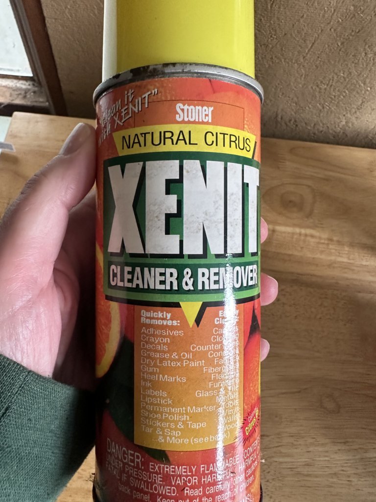

    Stoners who is known for their window cleaner also makes a product that is safe on your paint, but removes sticker goo really fast
    I’ve had good results with it
