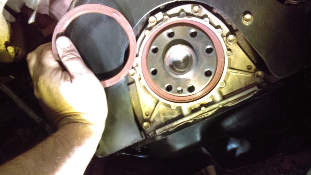

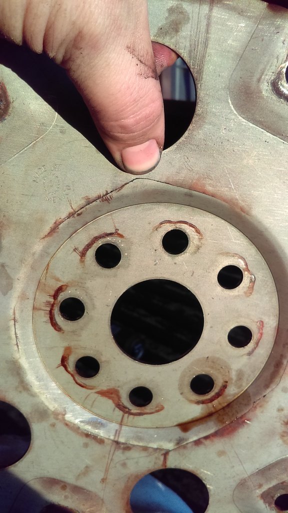

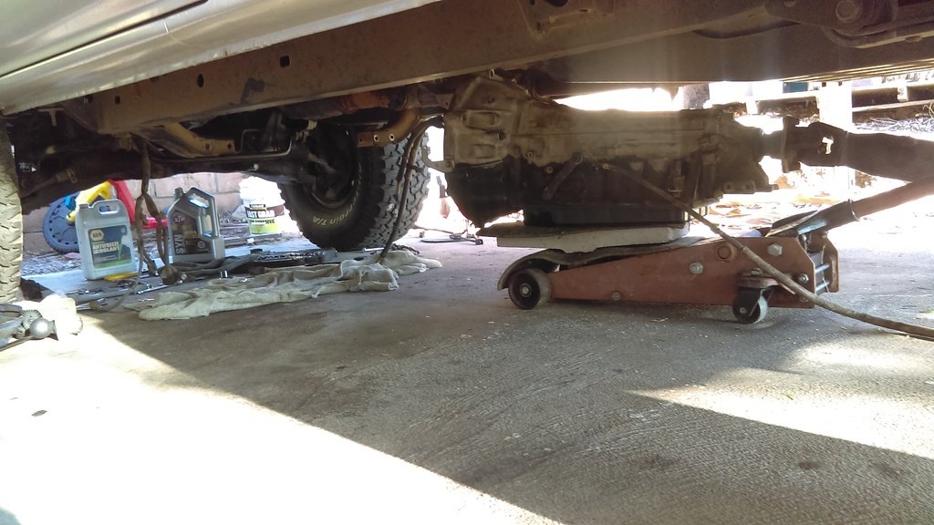

    When I was replacing the cracked flexplate. I dropped the pan and changed the filter and the TCC Solenoid. And the two shift Solenoid that come in the kit I bought.
    The TCC Solenoid is twords the front of the trans with the wire going to it..
    Did the Rear main seal while I was there
    And Replaced the Cracked Flex plate..
