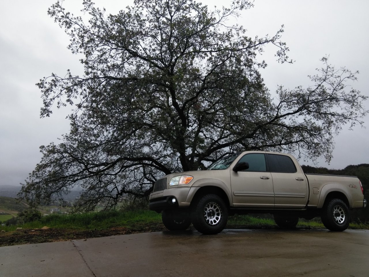

    I never was able to figure it out. After replacing all the solinoids in the trans. I was done with it
    At 200K supercharged miles I got rid of it and picked up a 05 Tundra. Best choice ever.
    More power more room half the cost of a Tacoma.
