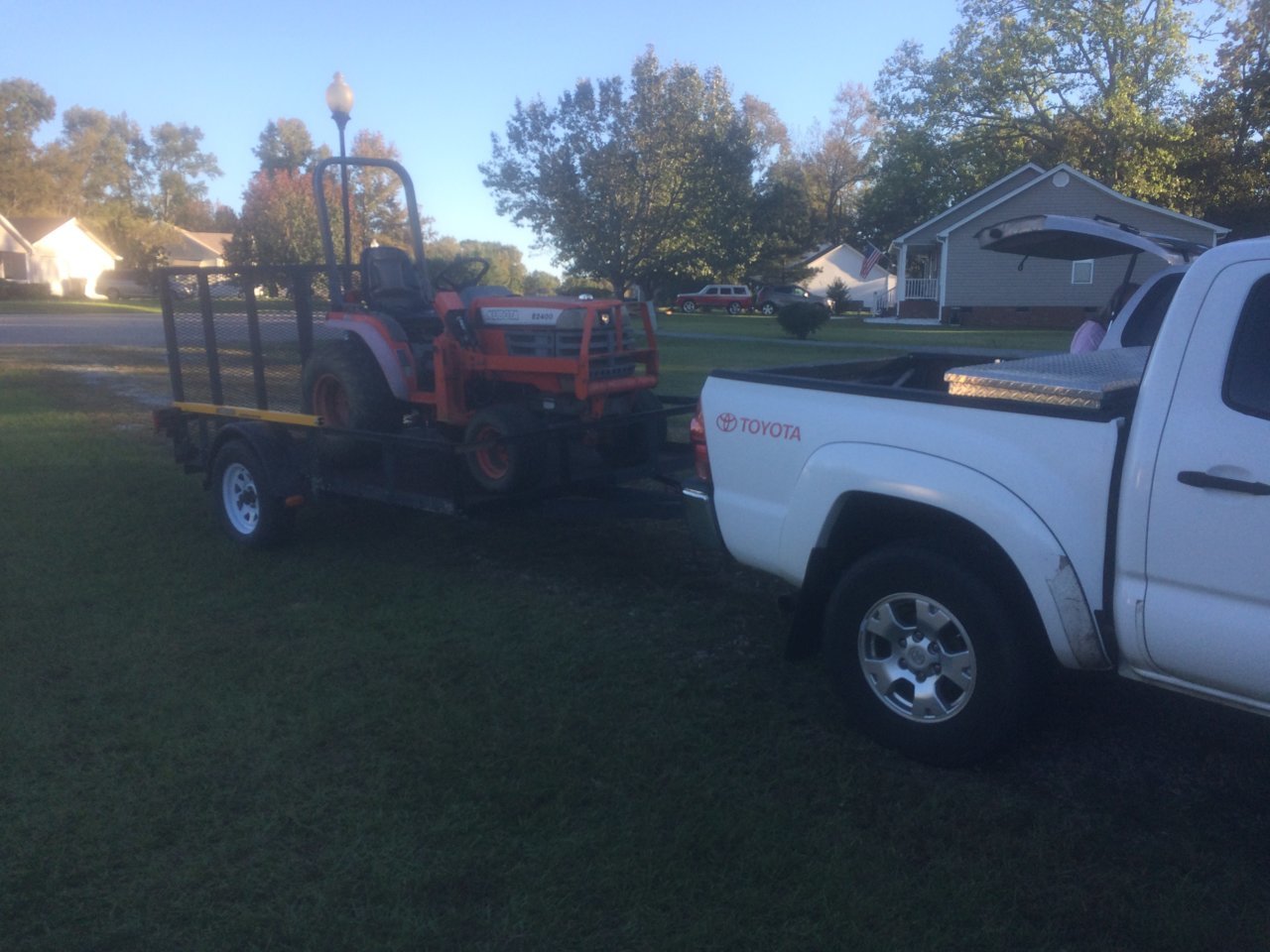

    Just to look at this picture, what do you think it would weigh? Two garden tractors on a steel 14-foot flatbed: The larger machine as configured is 1450 lbs., the smaller one is 700, and the trailer is 1500. I have to be very careful with that load, as the trailer (a very old home built I found 25 years ago) has no brakes, and I'm here to tell you the brakes on the Taco will NOT stop it in any kind of hurry. It was even a bit of a challenge for my previous truck, a 4x4 crew dually.JD gear loaded 001.jpg

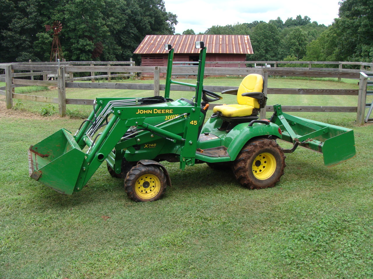

    Not sure what you're planning to do, re: "tractor work". I'd assume landscaping or garden work. Tha larger machine on that trailer above is a 24 horsepower 4x4 diesel subcompact, Deere lists it as a garden tractor. With a loader and 5' box blade it weighs right at 2400 pounds, and tractors gain a lot of weight with little changes in physical size.DSC06653.jpg

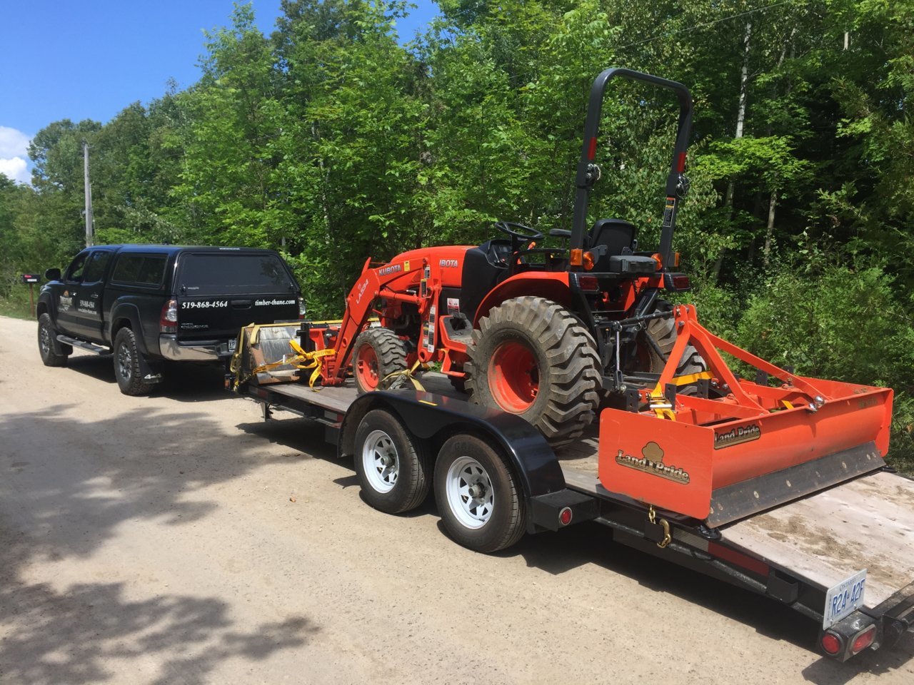

    Tractor with implements is appx 4000 lbs. The trailer is 1800 lbs. Single axle brakes on trailer. This tows very well and stops fine too.

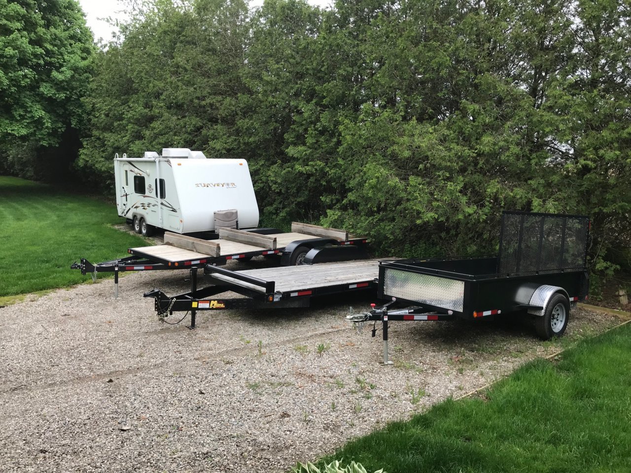

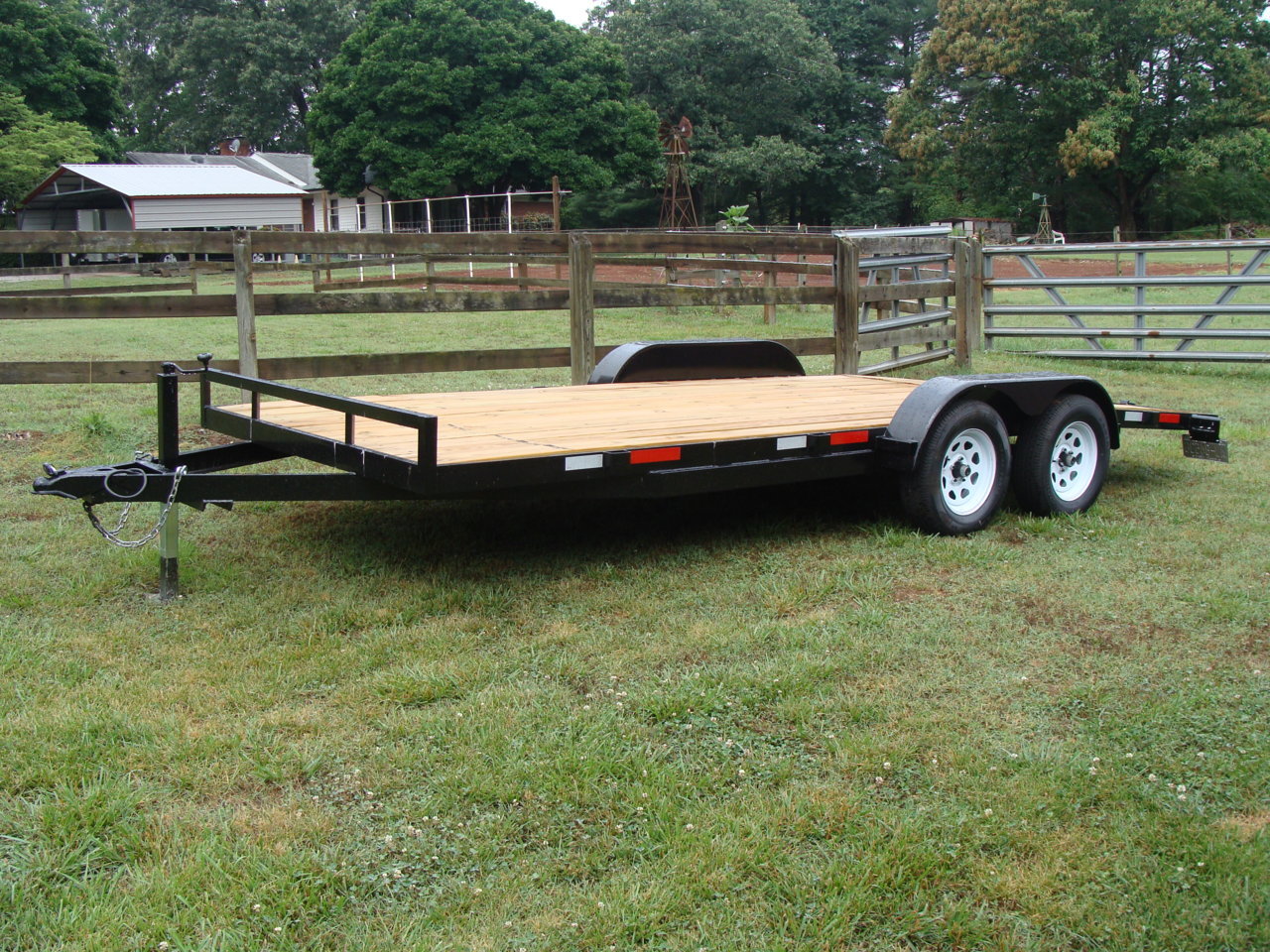

    Dayum, you stole my trailer! Looks almost identical to one I just bought. Is yours 18' long?DSC00637.jpg

    That is my float trailer. Axles are two 3500s dropped, Beavertail, and 6x16 ft . My timber trailer is double straight axle 3500s. 6x20 and the utility trailer is 5x10. single 3500.
    I pull all trailes with my tacoma.
