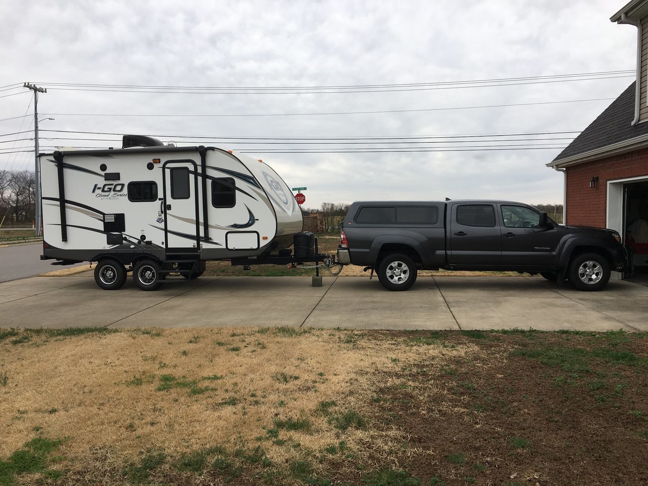

    IMG_0041.jpgThis is mine. Weighs about 3400 as it sits in the pic. I am getting between 10 and 11 MPG with it

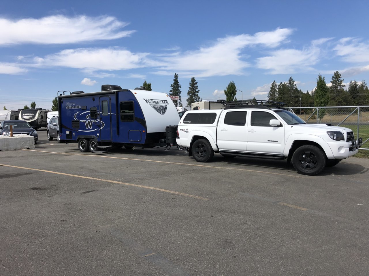

    5697FCA6-49D6-4353-A574-F82FD680BB4C.jpg Late to the party....I tow your trailer with my 2nd gen. Mph stinks, get a good wdh, stay in 4th. I take my time and no issues so far (knock on wood). Go enjoy!

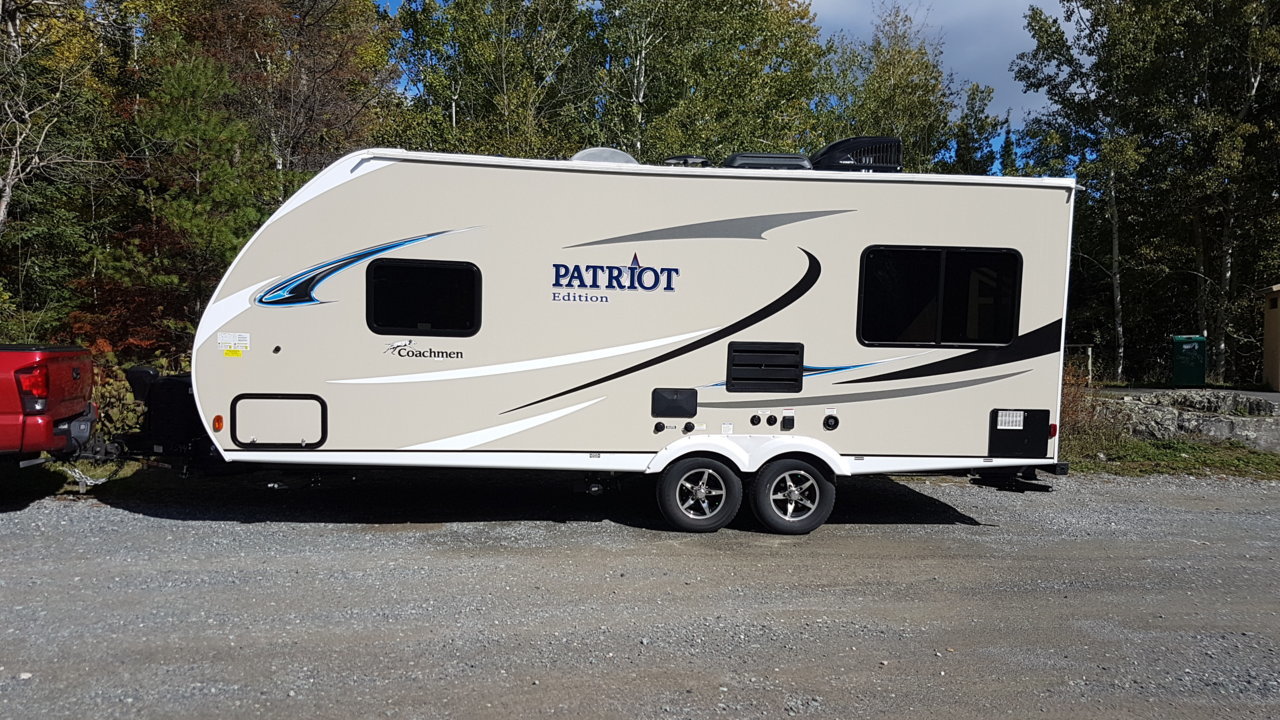

    I went with the Coachman 204RD and it comes in at 4,000 lbs. No issue towing at 65 and I run it in 5th gear and 4th on hills with 3rd on very steep hill. I have a manual trans. I just bought the trailer and towed it 400 miles to get it home. No issues and towed better that the 3,000 lbs single axle trailer it replaced. WD hitch with sway control is a must.
