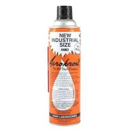

    Better, much.
    I had a dodge lbj that wouldnt budge with heat/pb/impact/6ft breaker bar. Sprayed that stuff on it and waited 5 minutes. Lbj unscrewed with a 1/2" ratchet.

    I don’t think I’m able to acquire that in Canada
    I think it is open end at the other side
    I don’t think I’m able to get this in Canada
