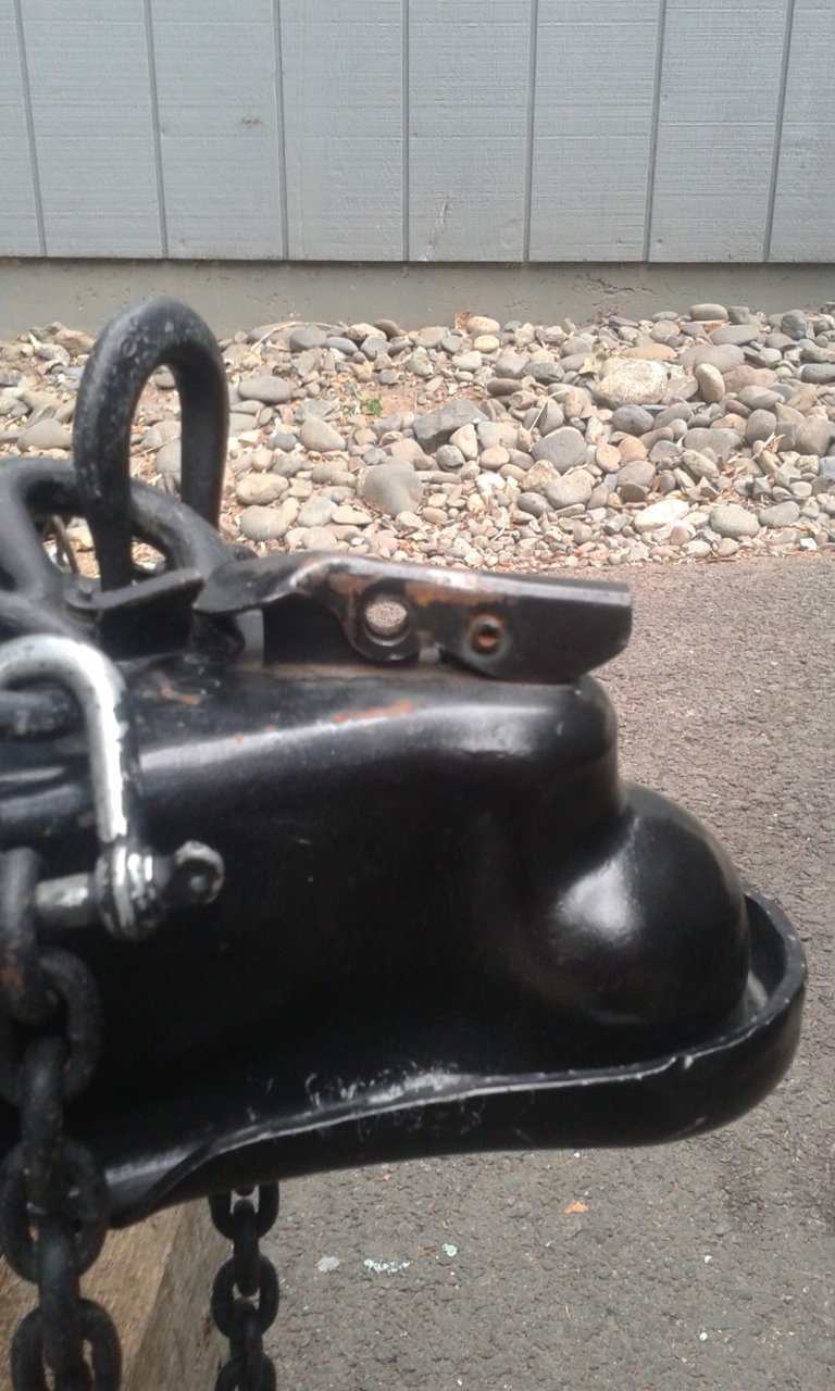

    Andersen No-Sway. But it cant be used with Atwood 88*** series or Marvel 88* series couplers. This pic is the style you cant use. It cost me $230 to have the coupler changed out at a local trailer shop.
    Uses chains with poly bushings/absorbers as the W/D setup and a friction cone in the hitch for sway control. Easy to install. Initial setup takes a little while, after that it is just a matter of setting the # of threads.
