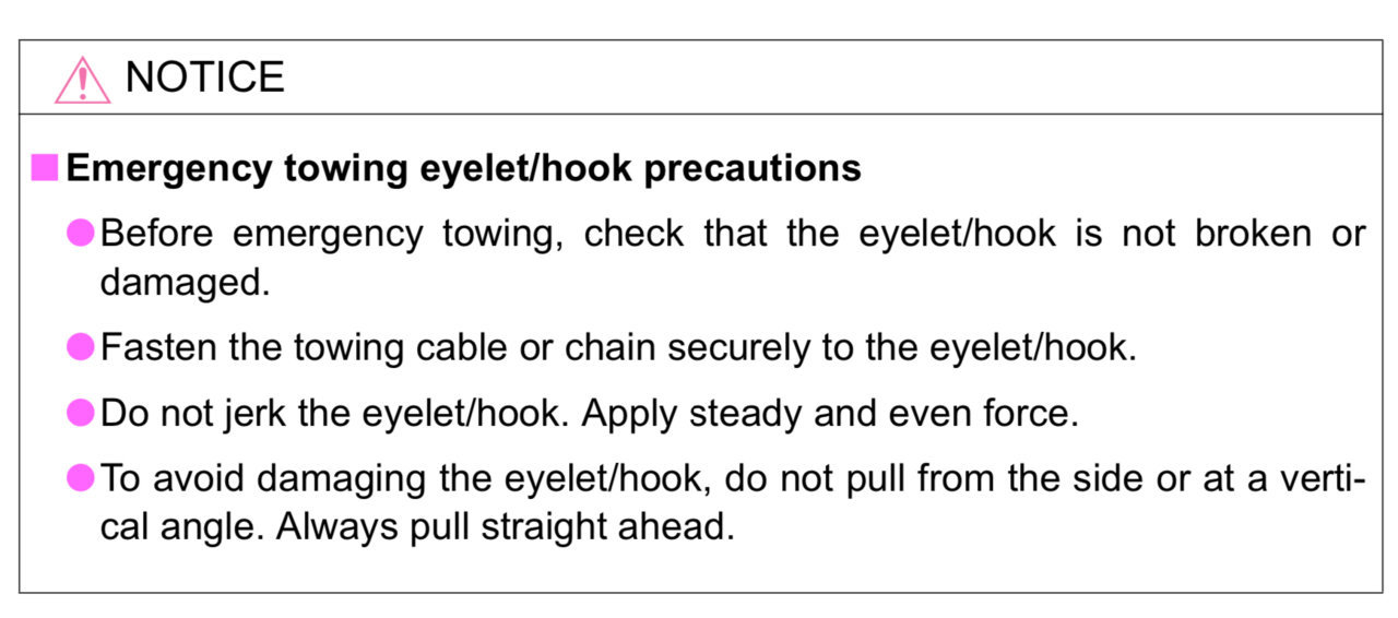

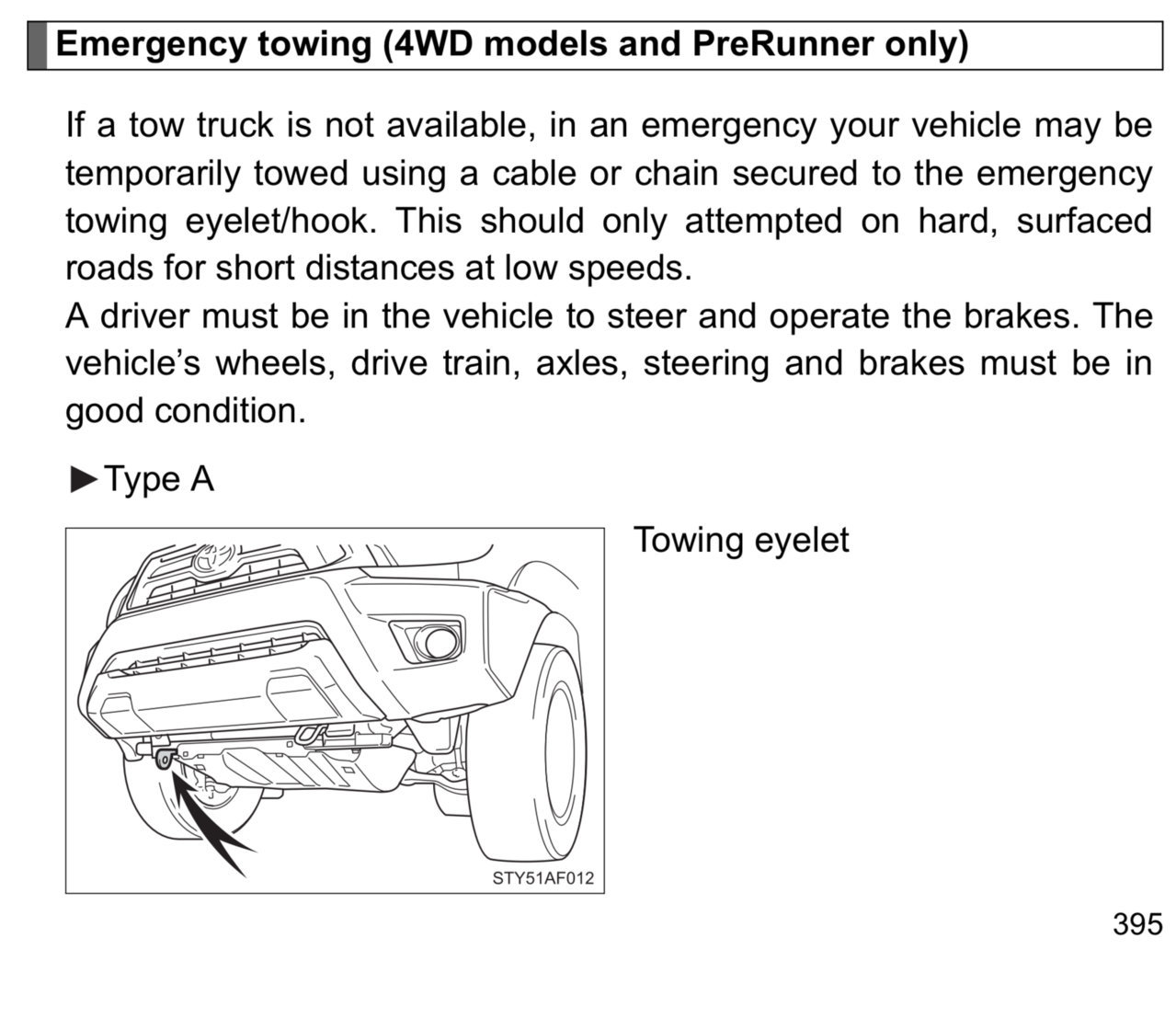

    The problem that can/does occur is that people use the OE point as a “recovery” point.
    Toyota says it’s for towing and only for short distance on hard surfaces.
    What usually happens is guys yank the ever living $hit out of them, and making this worse by pulling at an angle. That’s really hard on the OE point. And I wouldn’t advise it.

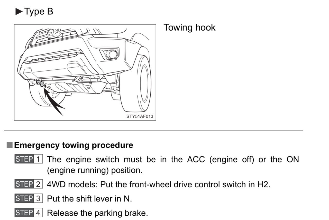

    The Off-Road trucks have a better hook. More suited for pulling.- Type B in the pic below.
    Anyways. If I were going to use the factory point, I’d pull slow and straight on.
    Take it EASY, don’t jerk the tow strap to get them free.
    Not unless you have have snatch strap, which work on a different principle. “Kind of”

    Yup the factory TRD Off-Road uses two either M14 or M16 (Grade 10.9 IIRC) I forget which bolts and has a T head with a spike for attaching and semi capturing an eye splice of rope or strap, I don't think a 3/4 shackle will fit and I probably would only use a soft shackle on it anyway, use a dynamic rope or strap for recovery on it or you can rip it off the frame.
    It's not a super great recovery point but it sure is a lot better and safer than the shipping tie down loop (driver side "U") or nothing at all.
