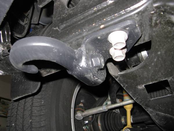

    A buddy took the hook install a different direction, still off the shelf parts but a little cleaner look:
    The hook is fastened to the bracket with a grade 8 bolt then the hook is WELDED to the bracket, painted, then and the assembly is reinstalled with the factory bolts.

    would not use this for recovery, 11,200 pound breaking strength, a vehicle stuck could easily exceed that. A good shackle has a WWL (working load limit) of 4 3/4 tons. breaking strength should be 3 times the WWL. Crosby shackles. www.rigging.com has lots of good info

    They’re not the same length, the TRD OR tow hook bolts are longer.

    That's a quick way to the hospital or morgue. There's plenty of examples of what can happen when a recovery point fails from the sheer force of the tow line rebounding and flying back into the vehicle performing the recovery, let alone a vehicle sliding if this is a recovery on a slope.
