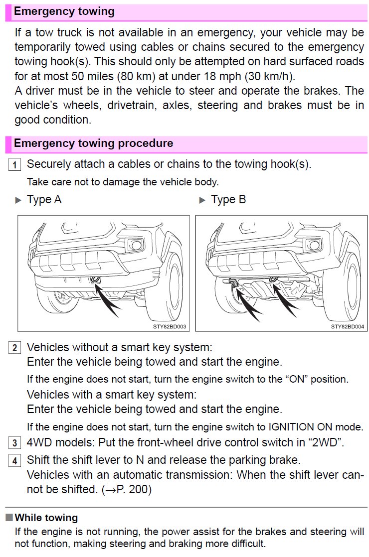

    The problem with Toyota's factory options is that they don't say any more than it's for emergency towing for either option. It's also not consistent I think in different years. They don't mention the welded loop in my book at all and none of them provide any guidance to capacity.

    Even less useful info in the 2017 OM. Basically echoing what was said above. Mainly flat towing, nothing about recovery.

    It's such a crap shoot because even when they provide a rating it's not really clear what they mean.
    Like BPF says "8250 lb rating" but how they got that isn't stated. I had one and it's certainly a big hunk of steel held in place with 3 x 12mm bolts. It's *probably* as strong as the subframe cross member insofar as it might be a toss-up which will bend first. But seeing those AMI points I'd trust them probably just as much.
    ARB gives a rating in a round-about way by saying a maximum of 18,000 lbs strap or 4.75 ton shackle. So is it a 9,500 lbs rated point or 18,000 lbs? My opinion (completely unsubstantiated) is it's designed to tolerate 18,000 lbs because a 4.75 ton shackle that meets ASME B30.26 will have a 5:1 design margin (47,500 lbs) and a 2:1 (19,000 lbs) proof test. I assume ARB designed and simulated to a capacity and they do product testing. That's something I think is required in Australia.
    I'm also not averse to using my welded loop for utility. My thought is it's got to be as strong as the passenger side options. But now seeing those AMI options has got the wheels turning.
