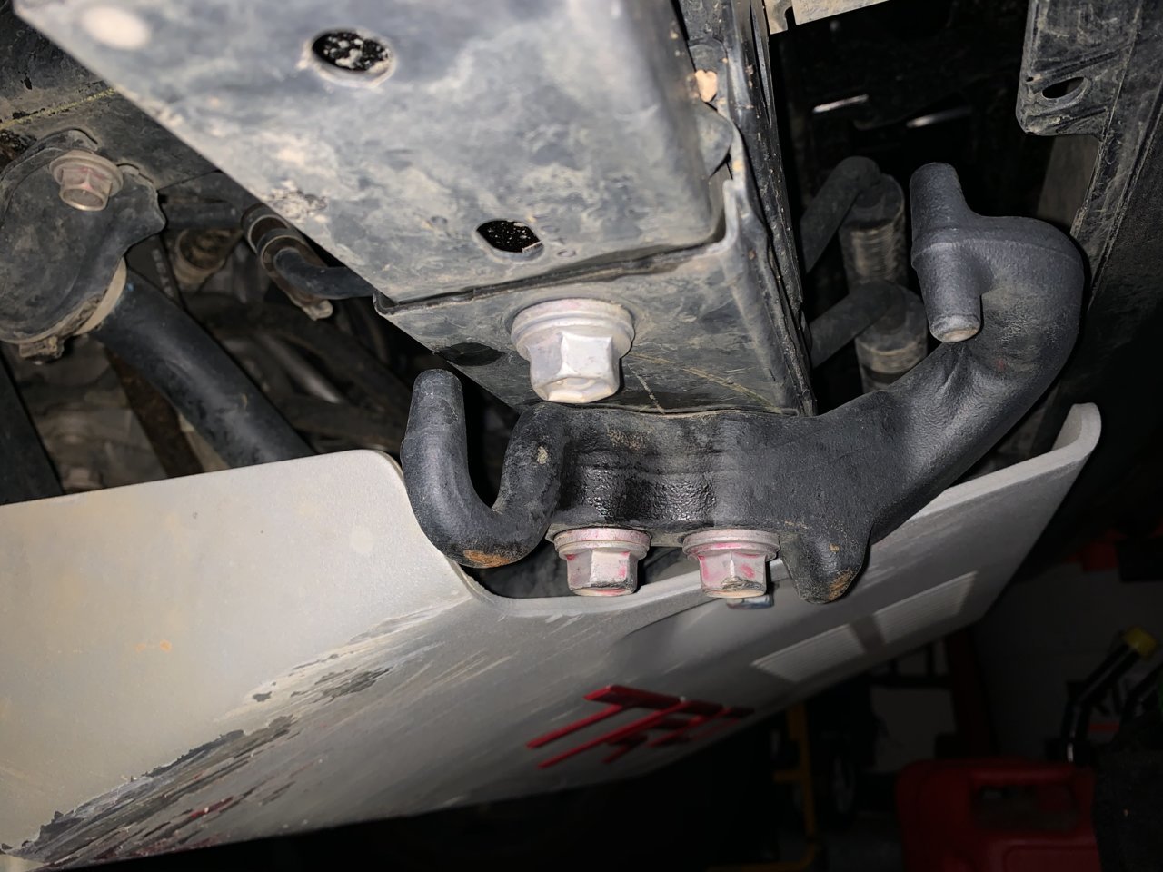

    I've been looking all over but I can't find a replacement for the tow hook on my truck.
    I'm looking to find something that I can replace the tow hook with a D-ring but they all say that they are not compatible with the TRD skid plate.
    Has anyone found anything that will work with the Pro skid plate?
    Never mind the scratches on the skid. I think I sent it too hard on the speed bumps at the mall.

    https://amistyling.com/demon-brackets-toyota-9-19-tacoma

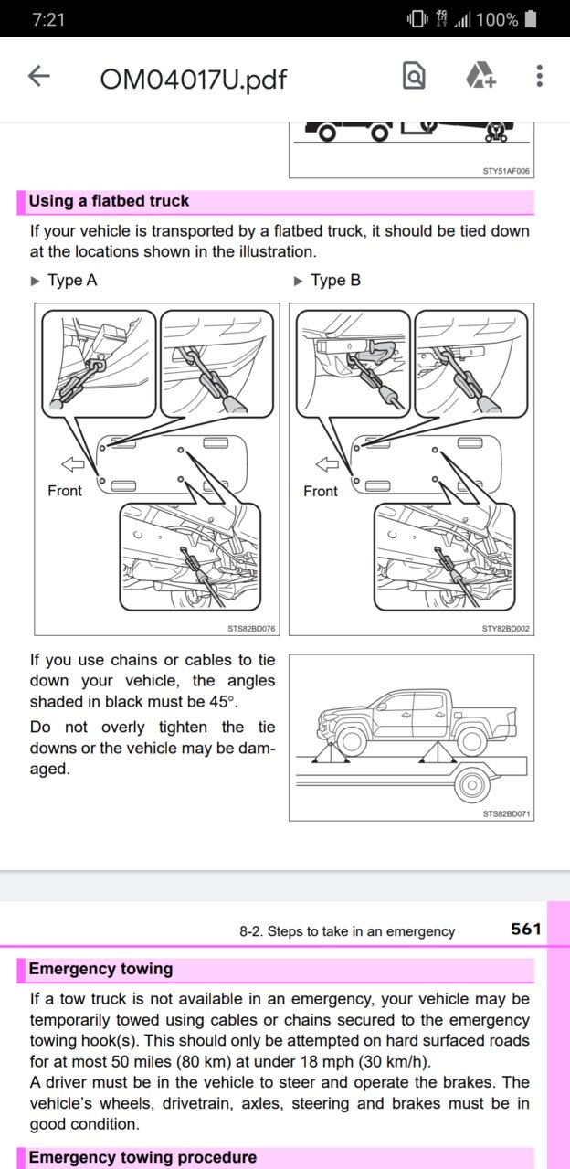

    Was there a specific reason why Toyota designed their OEM hooks that way? I have never seen it anywhere else as a standard, and I can't quite explain or find any literature why it looks like that. I'm sure Toyota had some use case in mind.

    Looks more like a tie down for transport then anything for recovery !

    https://www.bpfabricating.com/products/tacoma-recovery-tow-hook

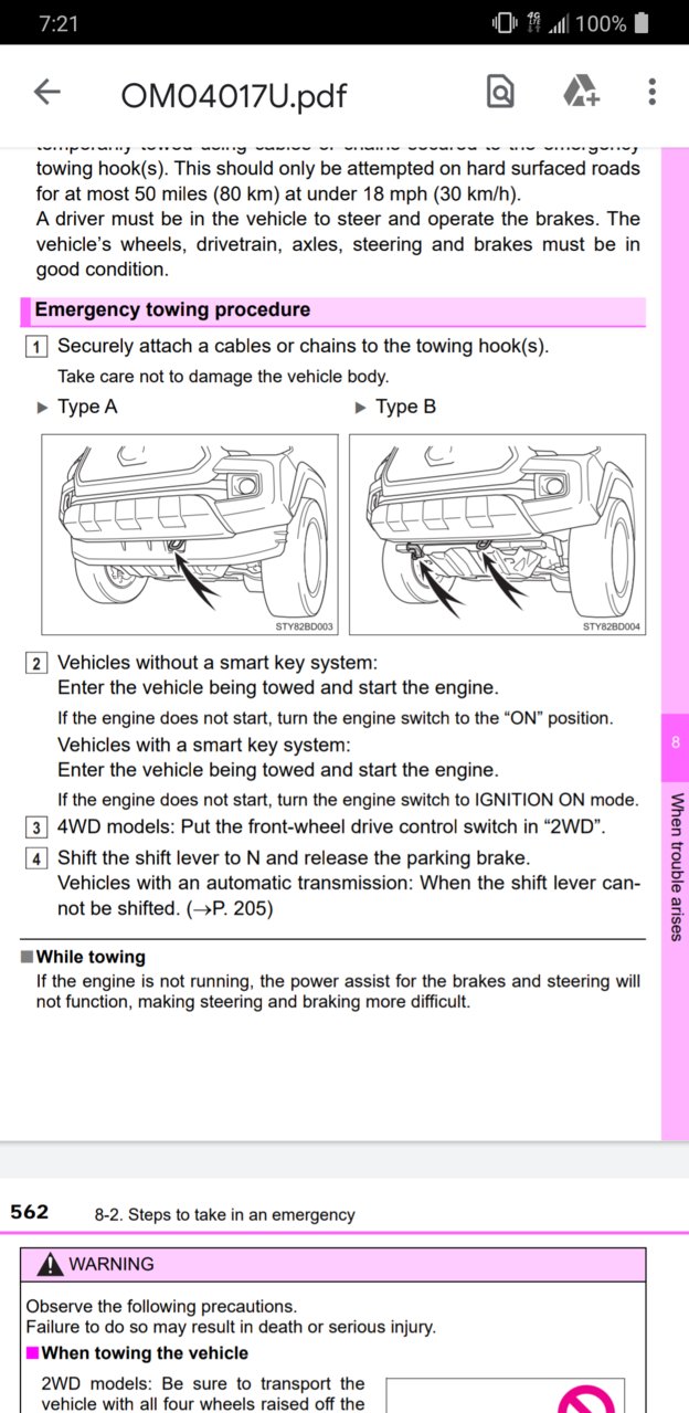

    You have been up too late cooking that rhino ass on the grill. Come back when you get some sleep.

    Thanks. This looks like it will work. I'll have to use a soft shackle.
    From their description.
    2016-2019 If you have a TRD Pro skid plate, you will need to use a soft shackle as the 3/4 inch shackle interferes with the OEM skid plate.

    I have one, a little steep in price but it's rock f'ing solid.
    https://www.tacomaworld.com/threads/arb-recovery-point.459551/
