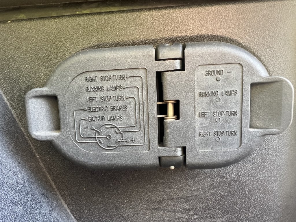

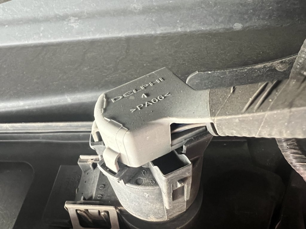

    Hey all, I picked up a new 2023 SR 4x4 DC last fall. I need to do some towing soon and cannot for the life of me figure out the tow rating.
    I do not have the tow package(according to the sticker), but I do have a receiver and 7pin connector. I am 99% sure it's part number 51908-04020
    Is that considered the bumper hitch(3500 lb rating) or is that a class 3 hitch (6500lb rating)?
    Anyone know offhand? I don't see any stickers in it anywhere.
    Thanks in advance.

    Bought new, V6. The sticker lists the hitch receiver but not a tow package.
    Your pic is identical to the one I have.
    Sounds like I'm good to go at 6500.
    Thanks brother!

    Don't forget you need a trailer brake controller. The 7-pin is there, but no brain to control it. There's a connector under the dash/driver kick panel that you plug a controller into to get trailer brakes. Which you really really need if you think you are towing even half that 6500.

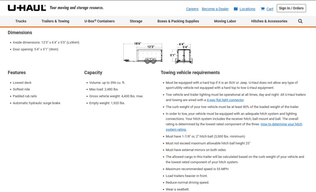

    A 6x12 U-Haul enclosed trailer (tandem axle with brakes) is not light when it is empty, when one fills it to brim with a few pieces of very heavy furniture and then many dozens of book boxes, it is easy to bring the entire assembly up to that weight.

    Yeah, well Maybe, except U Haul says empty weight is 1920#s and 4400#s max.
    It would be pretty hairy at 6000#s These trailers are even fun with a Full size Chevy.

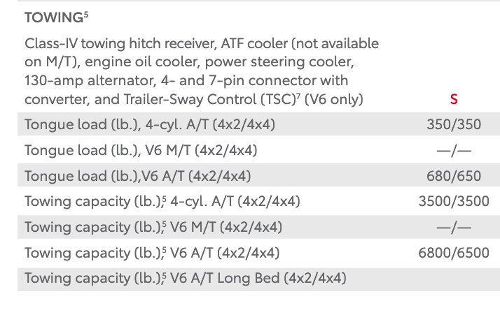

    There has not been a "tow package" at least since 2020, possibly earlier. Since then the engine type (I4 vs V6) is the only thing that affects the tow rating.

    Kings, Dakars, SPCs, 33's, Mobtown Sliders, TRD Skid
    I fact checked myself.
    The 2016 specs mention a "tow package" and the 2019 and 2020 specs do NOT mention a "tow package". 2018 is the last to mention a "tow package".
    See TOWING specs in:
    https://cdn.dealereprocess.org/cdn/brochures/toyota/2016-tacoma.pdf
    https://cdn.dealereprocess.org/cdn/brochures/toyota/2017-tacoma.pdf
    https://cdn.dealereprocess.org/cdn/brochures/toyota/2018-tacoma.pdf
    https://cdn.dealereprocess.org/cdn/brochures/toyota/2019-tacoma.pdf
    https://cdn.dealereprocess.org/cdn/brochures/toyota/2020-tacoma.pdf
    One oddity is that the 2018 brochure lists different tow ratings for with and without the "tow package", but then also says the tow package is standard, not a package. That's confusing.
    FYI: this is what the brochure lists as the towing features (whether in a package or standard equipment):
    Class-IV towing hitch receiver, ATF cooler (not available on M/T), engine oil cooler, power steering cooler, 130-amp alternator, 4- and 7-pin conn
