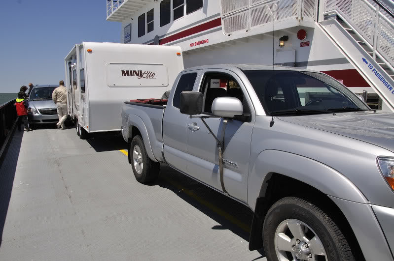

    Tow n see are POS. THey vibrate so bad you can't see anything at hwy speeds.
    I have the Mekesh and I love them. Still a little vibration but not like the tow n see's. The Mekesh are little pricey but worth it. I got mine off FleeBay for $45.
    Here they are on my rig. The pic is on a Ferry in NC last week. Spent 10 days in the OuterBanks and pulled the rig about 900 miles.

    I was using the convex. I like the larger mirror of the mekesh.My trailer is 8' wide but made even wider on the right due to the awning. I do not travel over 65 primarily because I am not in a hurry and also because most TT's have ST rated tires that are rates at a max speed of 65mph.
    gutbmoto used the stock mirrors but I believe his fun finder rig is either 7' or 7.5 feet wide. It make a difference. I have used the stock mirrors for short distance but that it.
    After getting the mekesh I will not go back to a smaller less effective mirrors, the difference is night and day.
    Just use what works best for you.
    Happy camping!!!!
