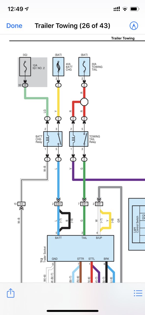

    Hi All -
    I have a 2017 Tacoma with the tow package with the 7 pin connector - I am concerned the truck is not charging the camper battery. Is there a inline fuse or something for the power from the battery to the 7 pin connector. I did check the two standard fuses in the fuse box - my blinkers / running lights are working in the camper.
    TIA

    I am not getting a reading with meter - I must have blown a fuse somewhere??

    did you check with the truck on? The charge power is ignition switched.

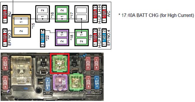

    Should be a 40 amp fuse in the under hood box.

    Can you please provide the link to this diagram?
