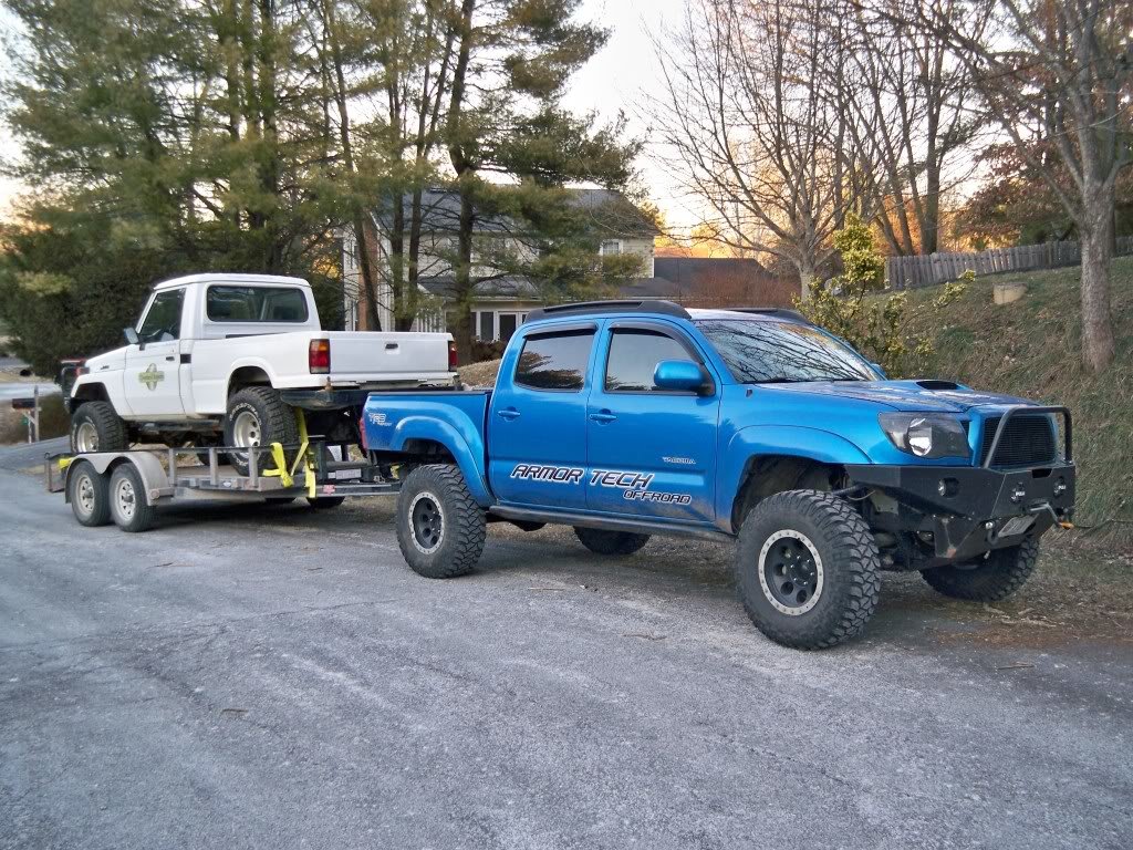

    Didn't read all the replies, however my personal experience. I had around 7k behind mine with no issues as far as handling the weight. Be sure though at that weight you have good trailer brakes, if running a tandem axle trailer I would suggest brakes on both axles. That's what I had and it stopped it just fine. I'd also suggest atleast sway control since your talking enclosed trailer. V nose trailers are great because they help to cut through the wind a little better. I was pulling a normal car trailer with a truck on it so didn't have the crosswind problem that most enclosed trailers experience. Also if you have enough room to play with where you park the car in the trailer you could get by without bags in the rear, that's what I did. Just position the car right to get the desired tongue weight. If you can't do that then I'd suggest either bags or a weight distribution hitch.
  19. Apr 5, 2012 at 7:08 AM
    #19
    Fire931
    Fire931 Well-Known Member Vendor
    Jan 18, 2009
    #12687
    3,237
    VA
    00 4Runner
    Just noticed the pictures and specs you posted on that trailer above, with brakes on both axles, and good brake controller, and atleast a sway controller OR weight distribution hitch I'd pull it all day long with the Tacoma.
    Pulled this several hours up the interstate, ran 75 with traffic most of the time. Had to drop down to 4th (6spd manual) on the one good mountain but I'm talking like mountain that puts 18 wheelers going 30 mpg. I still managed 60 in 4th. When I hauled it back I turned it around facing forward and it did just as well. Just parked the truck back a tad farther to keep the tongue weight down.
